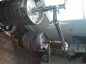

Finally got around to completing my dual keg to shotgun rig...
Chauncey
Posts: 1651
Location: NOLA
Post by Chauncey »
Height adjustable, refillable for long strips via the tee above the little expansion torpedo chamber...
Gonna insulate the long arm between the kegs, probably keep the thumper above the main keg(upward lyne rise toward thump) if its a heavy charge. Have my 1/6bbl ill switch out for the thump for spirit runs instead of the big keg.
This started with a non modular setup here:
viewtopic.php?f=50&t=73476
Now its fully modular and versatile with a shotty instead of a liebig after a slow series of mods...
