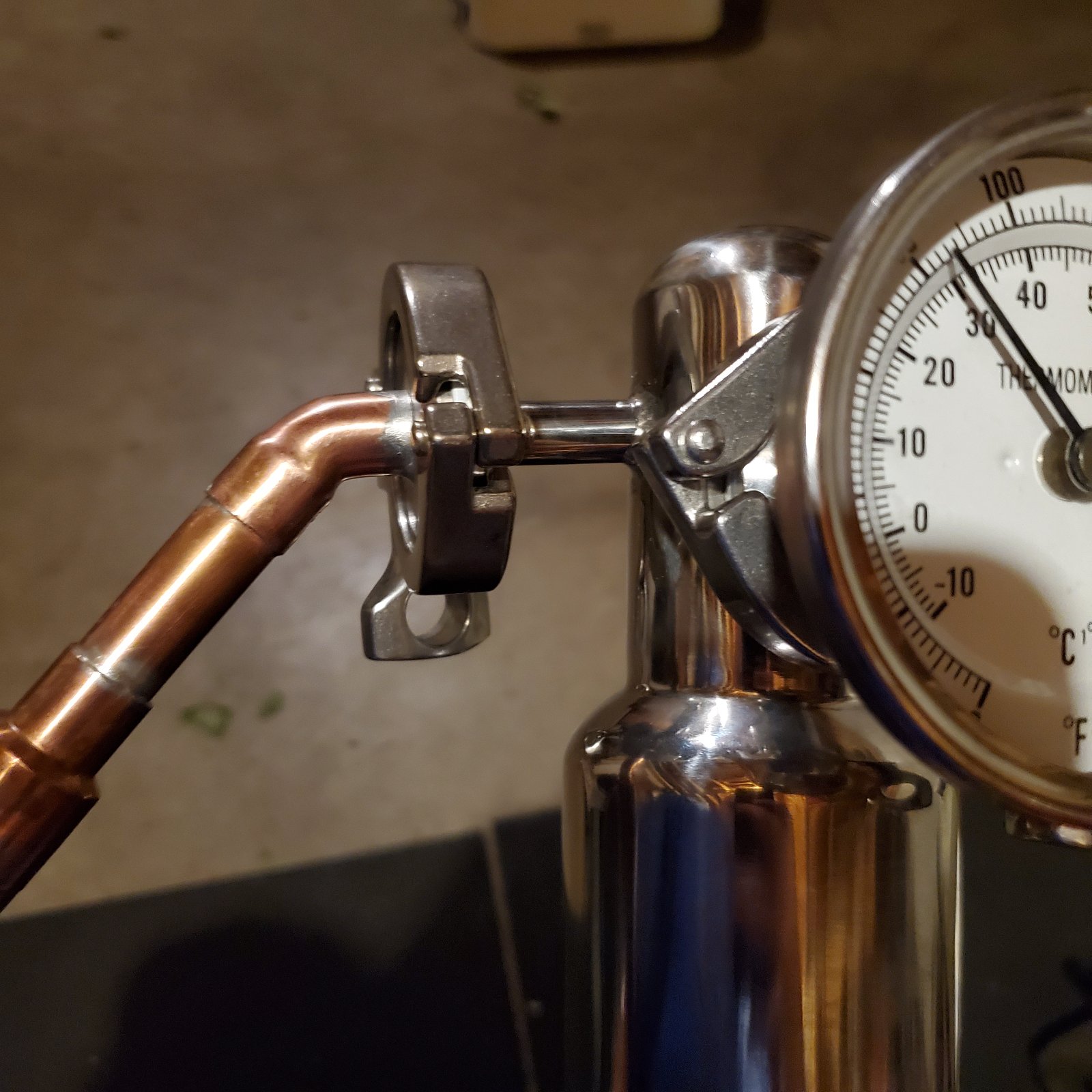

I am hoping one of y'all can shed some light on something that seems confusing to me. In comparing Stills marketed by Brewhaus, Clawhammer, Stillz, and others.... why do the liebig condensors seem to be so short and the ones made by the DIY's seem so long and also, the premade ones seem to be so close to the pot that the main heat source would affect the output....namely causing a flammability risk? Wouldn't you want the output of your distillate to be as far away from your heat source as possible?

Short answer is that a lot of what companies sell is crap, and likely insufficient to do the job.rickyaifd wrote: ↑Tue Sep 29, 2020 4:57 pm I am hoping one of y'all can shed some light on something that seems confusing to me. In comparing Stills marketed by Brewhaus, Clawhammer, Stillz, and others.... why do the liebig condensors seem to be so short and the ones made by the DIY's seem so long and also, the premade ones seem to be so close to the pot that the main heat source would affect the output....namely causing a flammability risk? Wouldn't you want the output of your distillate to be as far away from your heat source as possible?

You buy one of them, and you'll be hacking that liebig off and building your own. Ask me how I know...

And conveniently ignore the poor performance (speed) tiny condensers give by focusing on the shiny thermometer that is more bling than anything else.30xs wrote: ↑Tue Sep 29, 2020 5:39 pmBuild it shiny and they will buy it whether it works properly or efficiently or not.

I added more than double additional Liebig to my Clawhammer. Works fine. Gives me good separation distance from the burner and allows for quick stripping runs. Win win.

Hey, that thermometer does a bang up job of plugging that extra hole in the still head.Twisted Brick wrote: ↑Tue Sep 29, 2020 6:37 pmAnd conveniently ignore the poor performance (speed) tiny condensers give by focusing on the shiny thermometer that is more bling than anything else.30xs wrote: ↑Tue Sep 29, 2020 5:39 pmBuild it shiny and they will buy it whether it works properly or efficiently or not.

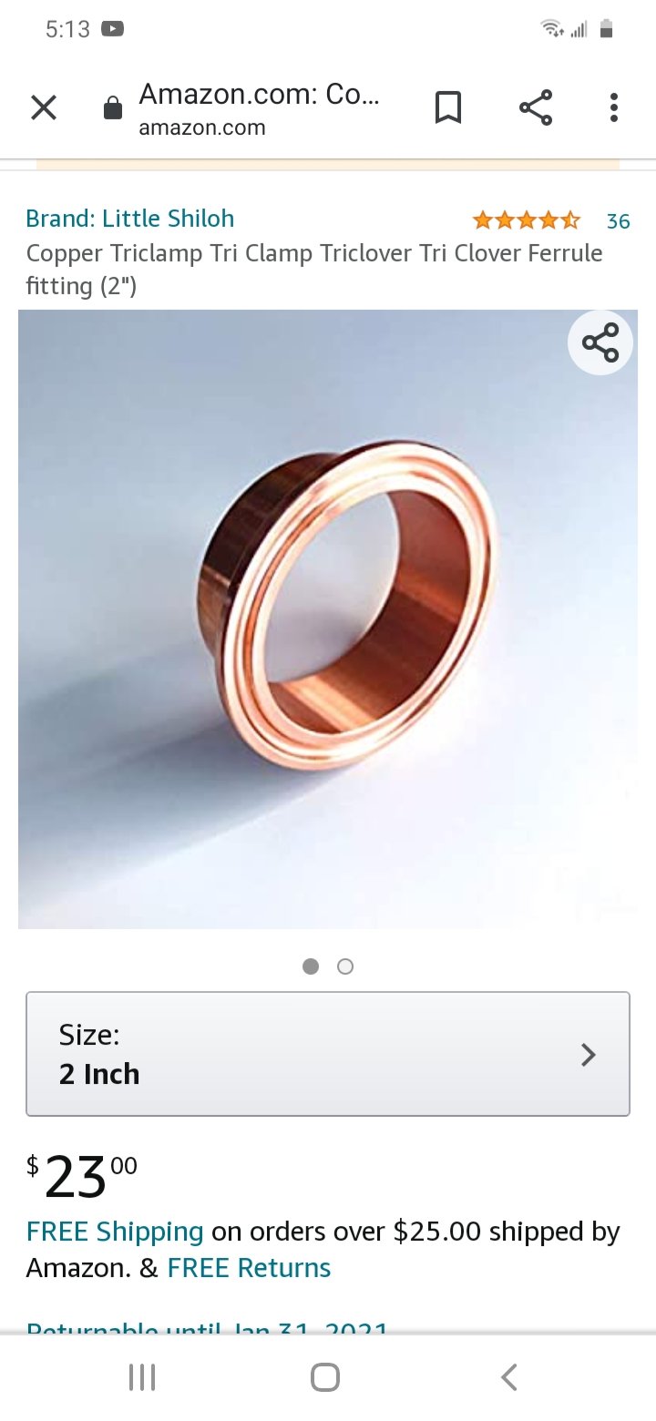

Gonna make a freaking 2inch copper head deplorable has me talked into it...so the slow parts ordering starts

Good luck with the build. Still Dragon has outside fit copper and brass ferrules, if you’re in an area he ships to. Twistedbrick’s preformed shotgun plates do make things a little easier for a beginner.
