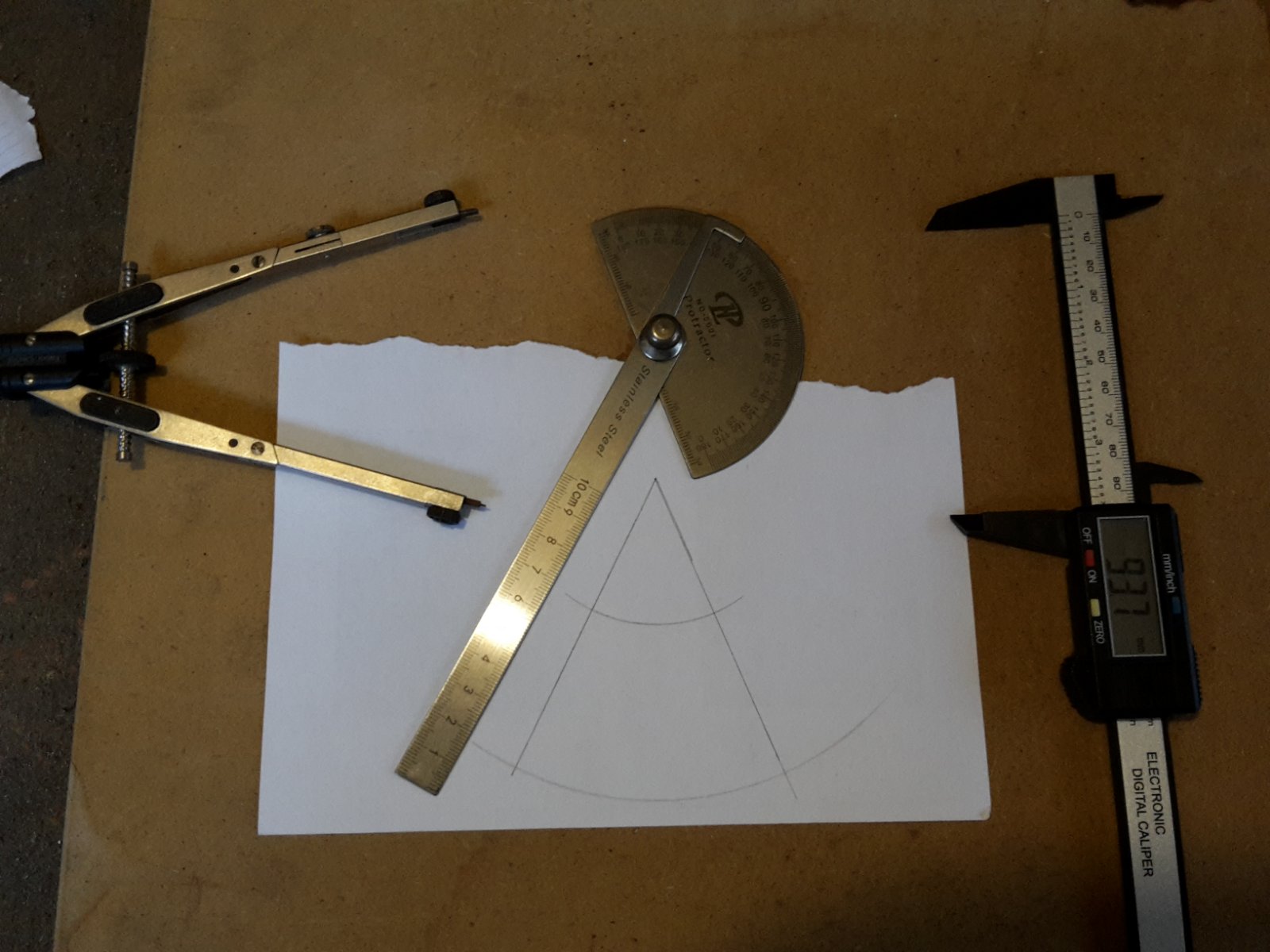

I found this calculator, calculate the measurements to be able to draw a truncated cone, we could report it on paper or sheet metal. I've seen other great posts here on how to draw it, this could be an added resource.
https://craig-russell.co.uk/demos/cone_calculator/

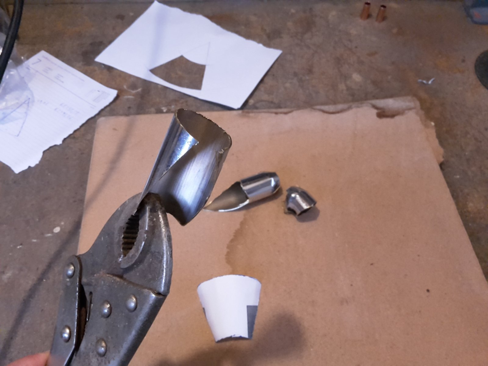

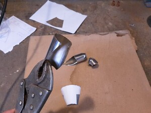

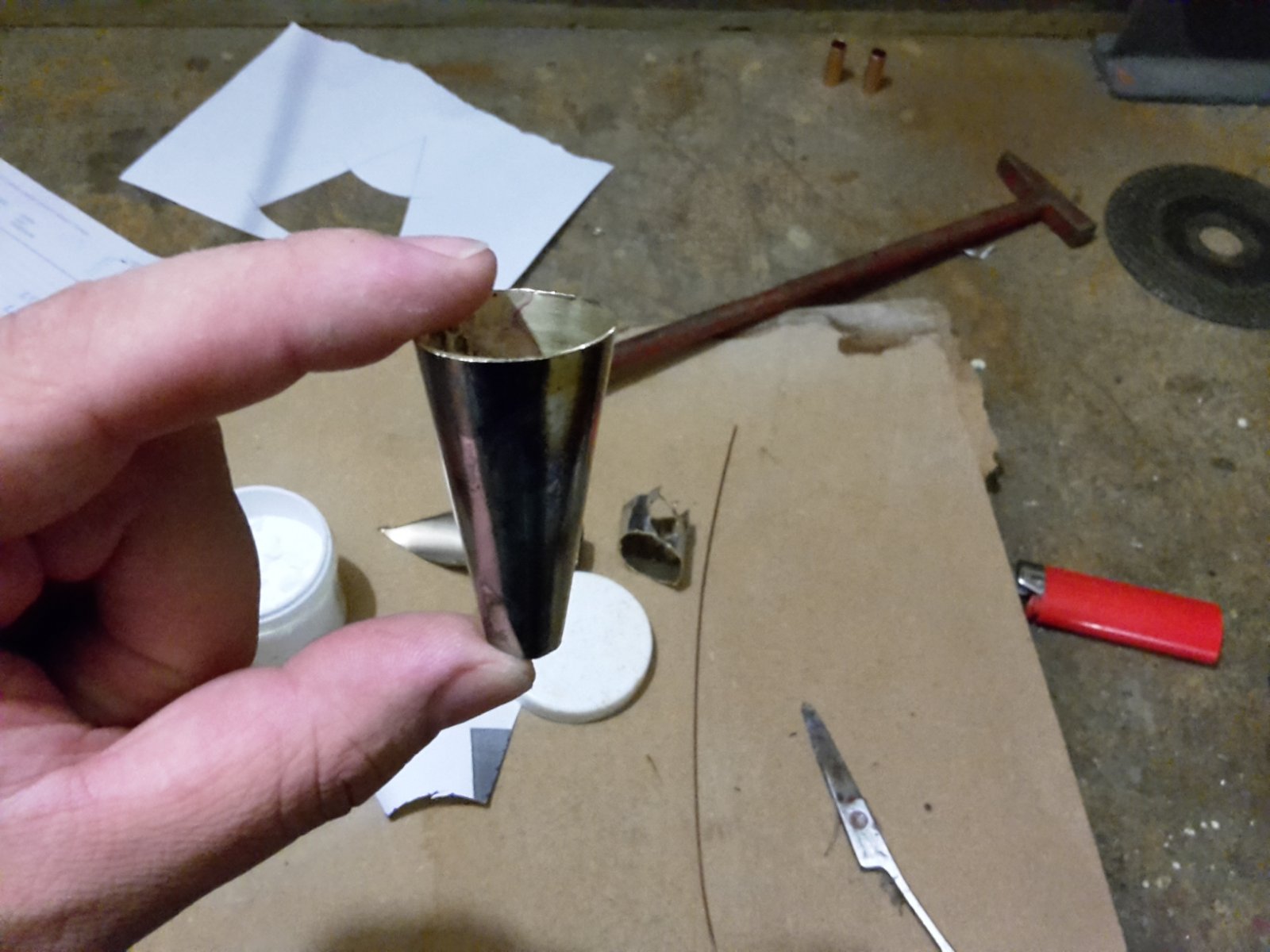

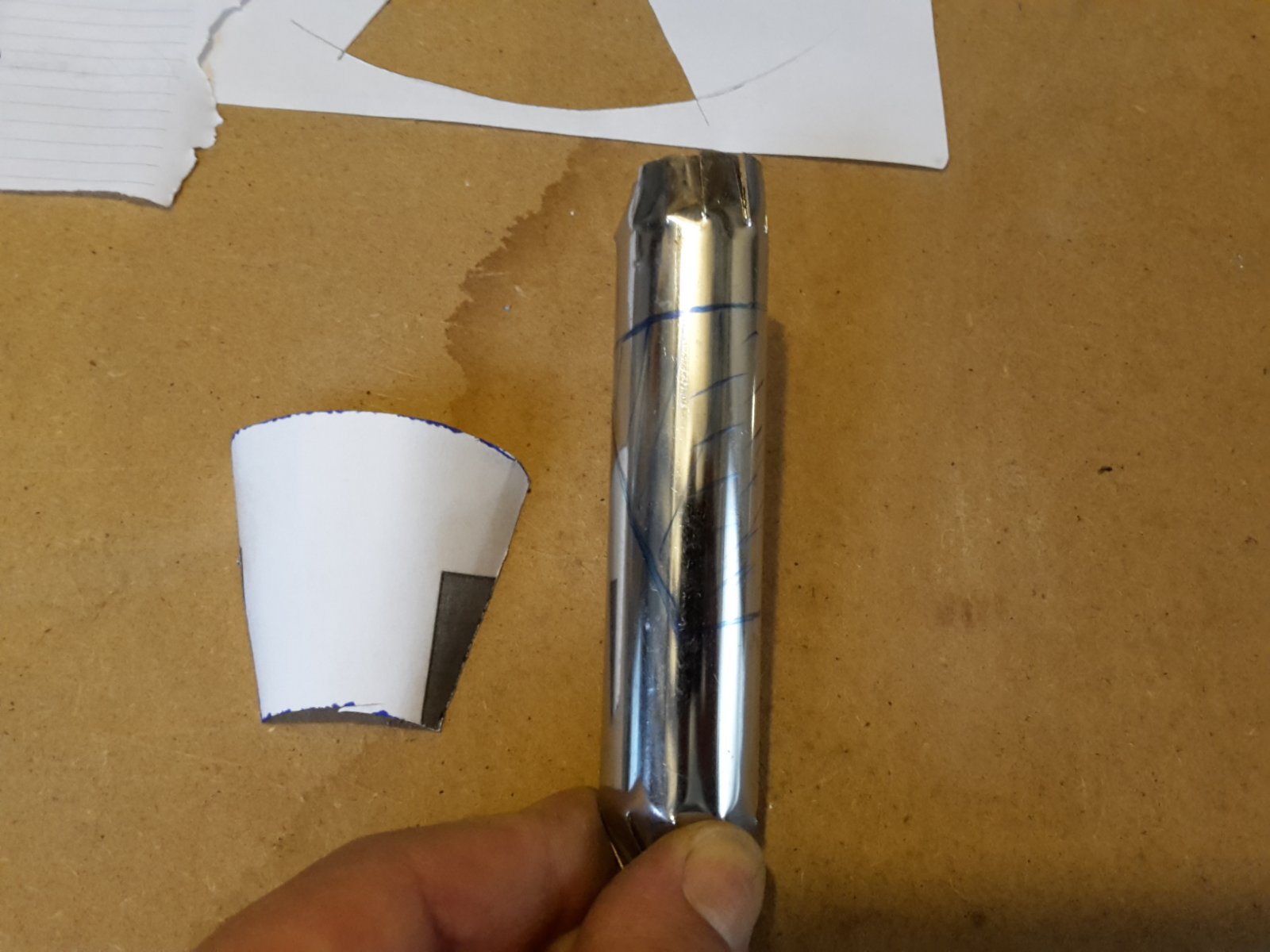

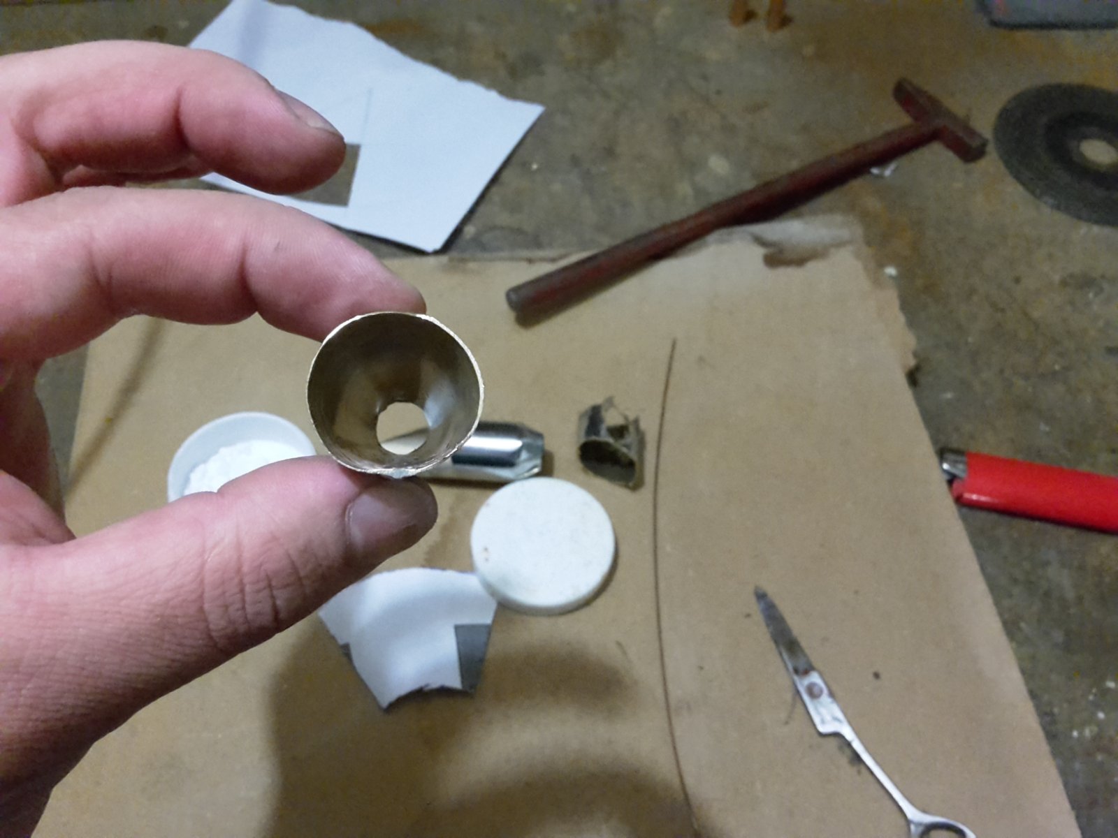

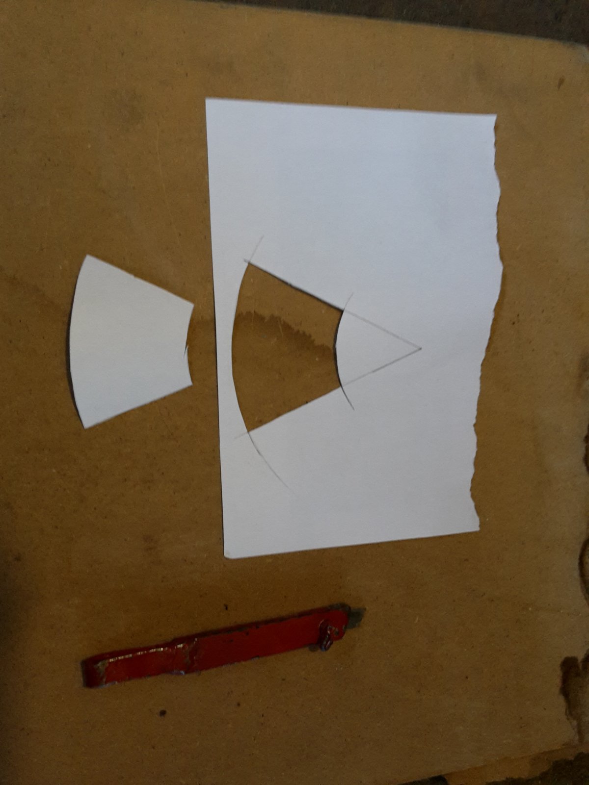

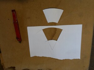

I tried to build a small cone that I needed. So I will test the correct calculation.
Demy
Posts: 3186
Re: Truncated cone online calculator (link)
Post by Demy »
Here, cutting and welding is done quickly, not too careful.

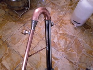

A practical application, use as a reduction.
