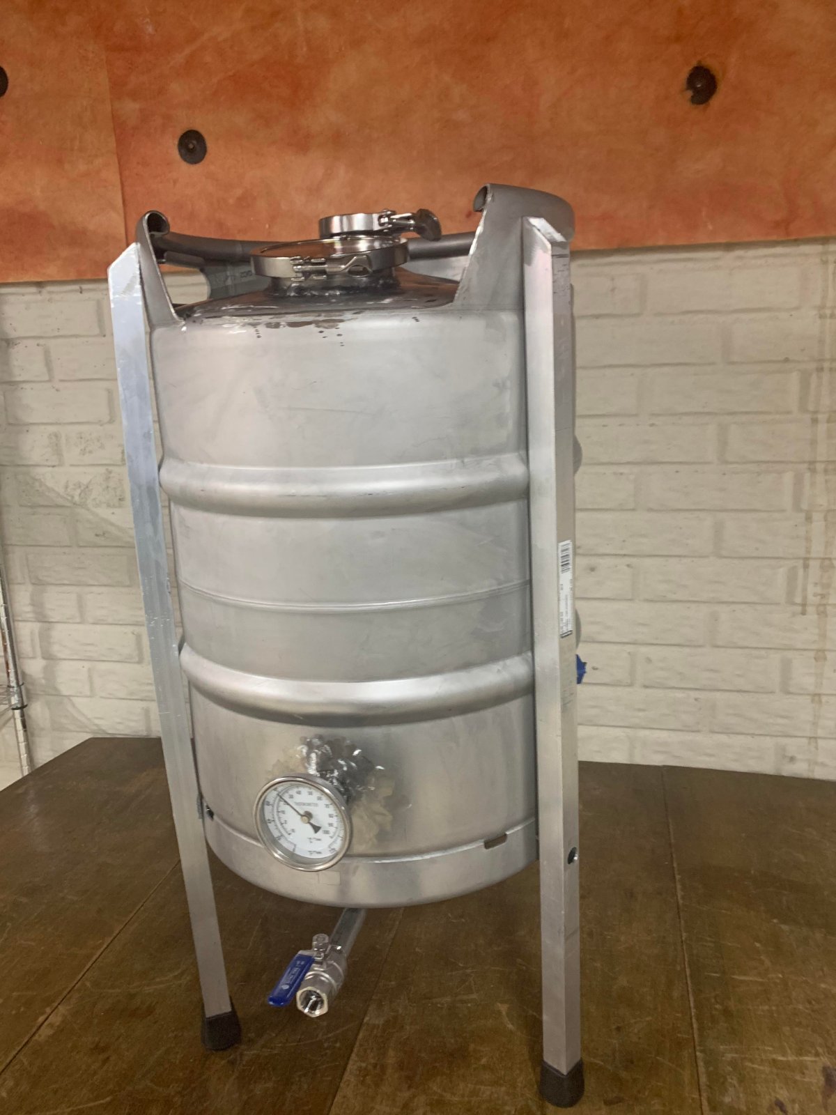

So finished up the boiler today and it does not leak with water in it. Passed the first test so happy because my welding has much to be desired. But it holds hot water and got a citric acid bath tonight. Electric heating parts are on their way should be doing vinegar run by the weekend. So excited about that. Then I will learn to ferment and do my sacrificial run.

Congratulations! Looks very slick 🙂 what are you putting above it?

Fastoz wrote: ↑Sun Jan 10, 2021 7:18 pm boiler.jpgSo finished up the boiler today and it does not leak with water in it. Passed the first test so happy because my welding has much to be desired. But it holds hot water and got a citric acid bath tonight. Electric heating parts are on their way should be doing vinegar run by the weekend. So excited about that. Then I will learn to ferment and do my sacrificial run.
its really nice :D , a filling lid and drain are great additions to a keg , I added them to my keg earlier last year , it cost quite a bit to buy the parts and some trial and error to fit them but beats carrying a heavy hot keg to empty it out and having to remove the column or pot stillhead to fill or empty

Nice work! I really like the stand.

That was the easiest part. 1x1 aluminum stock cut into 3 equal pieces and 6 stainless steel bolts, nuts, washers and lock washers. They are bolted to the top and bottom rim. Don’t forget 1” rubber table leg ends

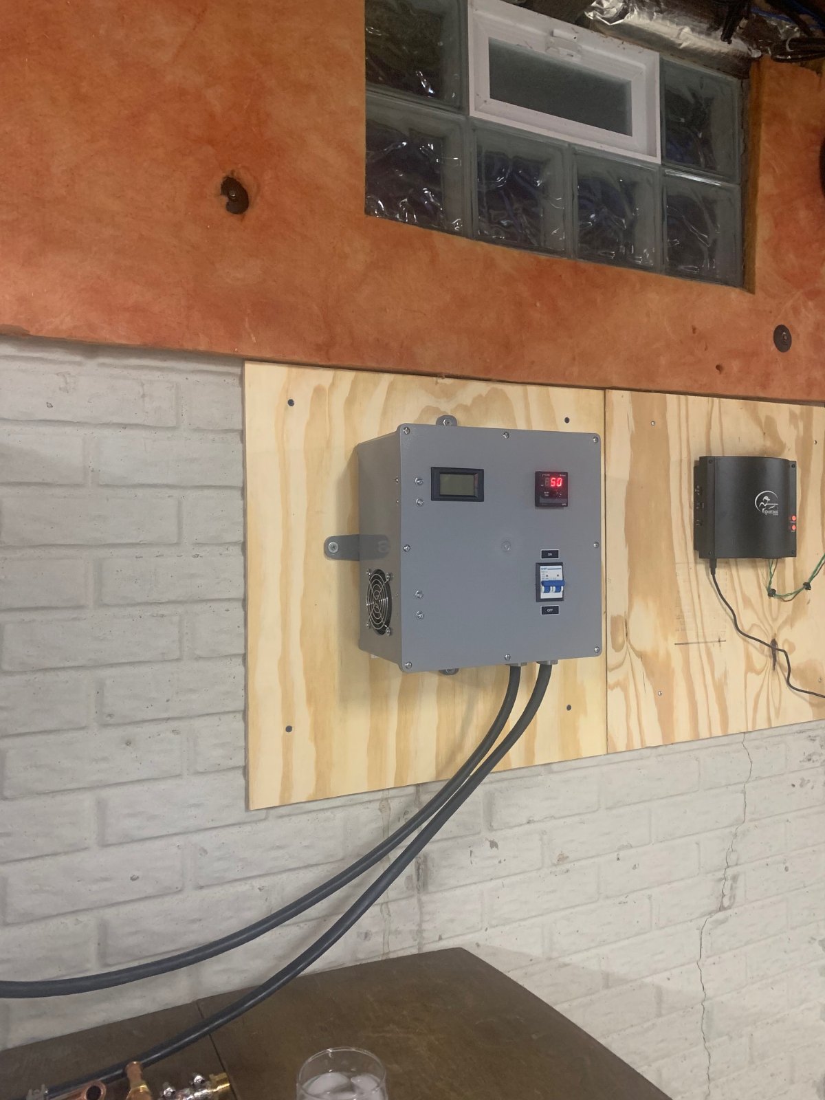

So I finished the control box today and for the most part, it works great. Glad I used a 5500-watt element it is like a rocket ship. On little problem with control, box forgot to hook up ground to volt amp meter gauge and Poof!!!! If that's the worst that happens it's all good. Did install a fan with thermostat control on SSR fines and it just kicked on its working great Doing another Citric acid bath to get rid of just a little more rust spots from welding and off to vinegar run. Also went shopping and got stuff to do first ferment for a sacrificial run. Using some turbo yeast for that, I got a free bag a brew shop today. I did buy some Red Star for realruns.
