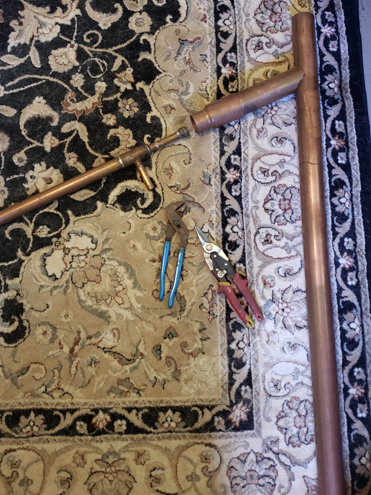

After much reading and thinking, i have settled on this,
I figured i could braze my 'lyne arm'(?) Into the riser/column.
I have i coped it to fit but have not cut the hole in the column yet, I'm waiting till i get the copper coil condenser wound and see how long it ends up, somewhere between 6-10 inches so the hole would need to be 8-12 from the top.
I'm planning on cutting the column in half and making some quick flanges to join em back together as needed.
Just posting an update on the nudges

Looks to me like product will pool in the area where it leaves the condenser and enters that spout type bit.
That in turn will or can lead to smearing.....or maybe Im just looking at it wrong.

The angle should be enough to flow past the 2x1½ reducer, the rest will step down in ¼ inch increments down to ½, i can increase the angle some to 45 but, that step down is only 3/16 of an inch
Edit; with the 1½pipe in the reducer it'll be 5/16
