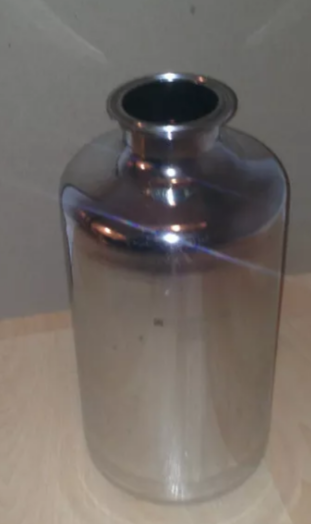

These popped up on the local classified, Tri-Clamp Stainless Steel Bottle. 2L
- Posts: 10370
Re: Where to buy a stainless steel mason jar?
Cute. Whatcha’ got planned for it? 2 liters is quite “petite”.
