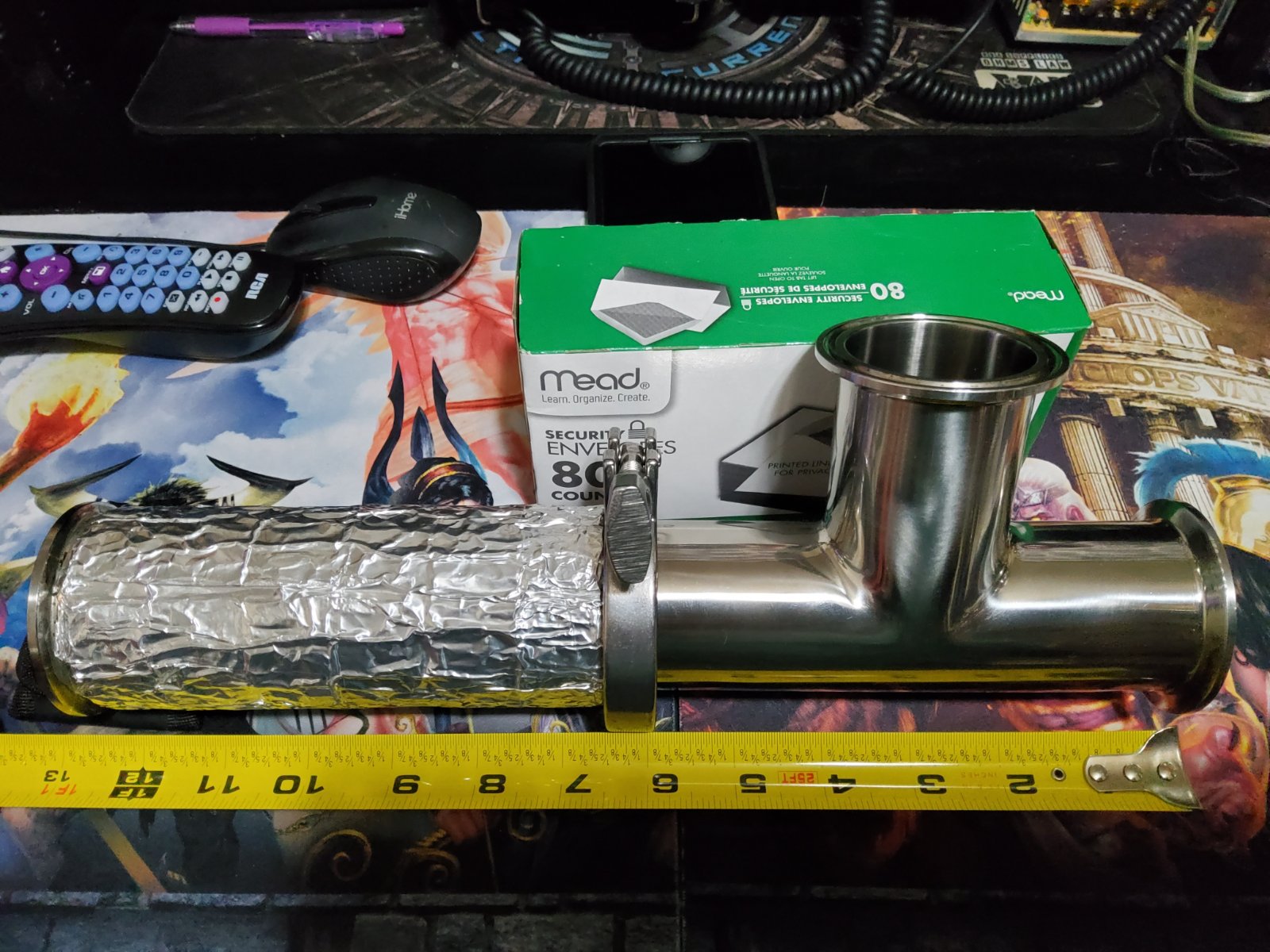

So I guess I should start with a little about my setup, It's a 15 gal keg with a 5500 watt element. On top will be 2 -20 in long 2in diameter copper sections for a total of 40 inches. This will be packed with copper mesh.

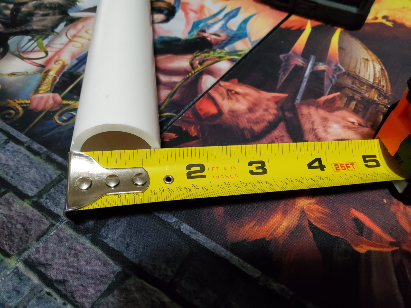

I read a few posts about how to wind single and double coils and I think I'm gonna use the way that Hook outlines in his PDF file. In the pictures you'll see 2 different sizes of pipe one copper and 1PVC the copper is going to be used for the internal mandrel and the PVC for the outer mandrel. This is as close as I can find as far as sizes to what Hook recommends using. Will this work? Also he recommends using a coral of around 6" or so is this going to be enough to knock down regular operating wattage? I went and picked up a 20' roll of quarter inch soft copper tubing and I can make the call bigger if I need to. I was thinking that the coil would go below the of the take off about 2" to create total reflux, is this going to be enough or does it need to extend further?

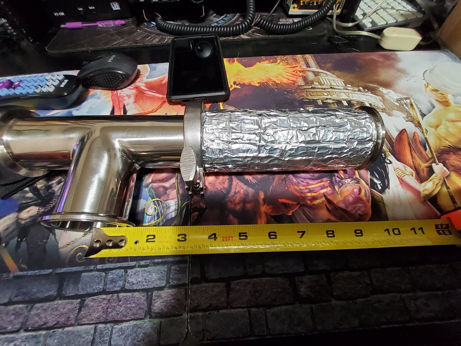

I guess the last question I have is that the section above the T is 6" long from the ferrule , Is this going to be long enough or should I make it longer to support the supply and return ends of the copper. The 6" coil will still be be inside of everything even with no reflux. With it raised with no reflux that will leave about 3 to 4" outside to the 90 bend on the supply and return.

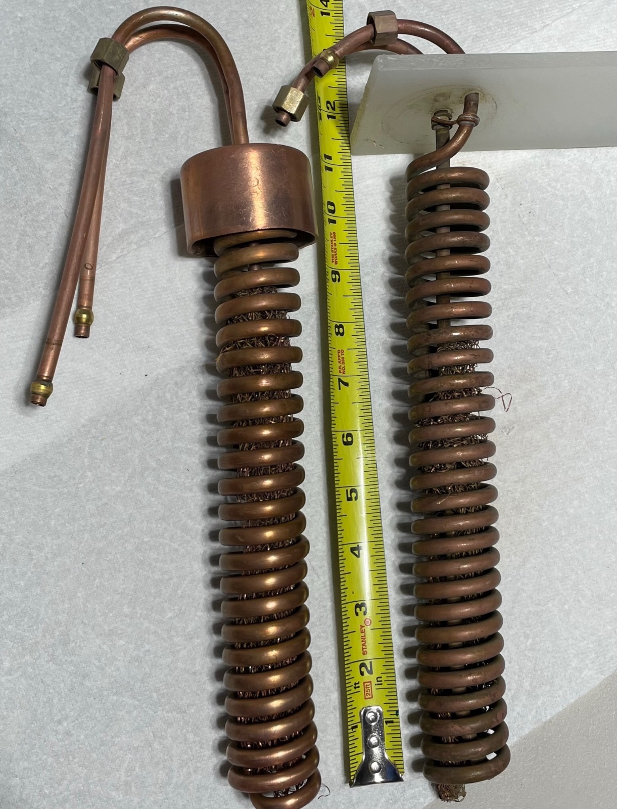

I used 1/4"od tubing to make a continuous double coil about 9" long. I filled the tubing with water and crimped the ends. Worked a treat. It slides easily into my 2" copper CCVM head.

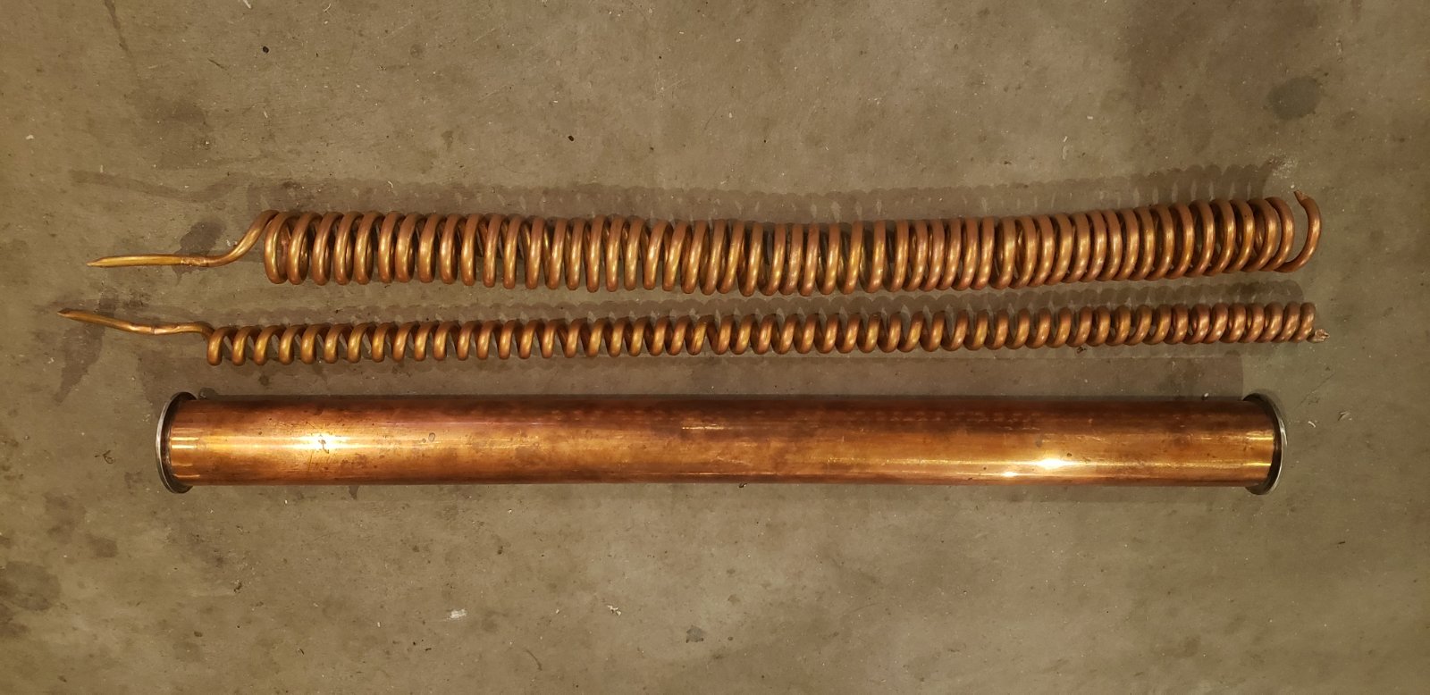

This 1/4" ID x 24" long double wound coil fit inside 2" copper pipe. It was filled with salt, wound flawlessly and cleared with water.

But not wound in one piece judging by the sweated copper joints?Salt Must Flow wrote: ↑Tue Aug 23, 2022 4:21 pm This 1/4" ID x 24" long double wound coil fit inside 2" copper pipe. It was filled with salt, wound flawlessly and cleared with water.

No, not a continuous coil. I wound each coil using two different mandrels because it was easier for me and with the 90 elbows, it made it simple to connect each coil to each other. I posted this as an example only because even a coil this long filled with salt will clear with water. I don't know of any example that gives reason to be concerned with using salt.NormandieStill wrote: ↑Tue Aug 23, 2022 4:25 pmBut not wound in one piece judging by the sweated copper joints?Salt Must Flow wrote: ↑Tue Aug 23, 2022 4:21 pm This 1/4" ID x 24" long double wound coil fit inside 2" copper pipe. It was filled with salt, wound flawlessly and cleared with water.

That coil is a beast SMF. Holy cow. Otis

Yeah I was trying to not have to make a shotgun condenser so I wound that big ol bastard. I figured this would be easier and cheaper. It turned out to not even knock down 5500W so I removed the coil and made a shotgun anyway.

That does not knock down 5500w? Again, holy cow! You must have a low flow or warm source water or something.Salt Must Flow wrote: ↑Tue Aug 23, 2022 6:02 pmYeah I was trying to not have to make a shotgun condenser so I wound that big ol bastard. I figured this would be easier and cheaper. It turned out to not even knock down 5500W so I removed the coil and made a shotgun anyway.
I have 10” tall single coils of 1/4” OD that knock down 5500w (barely) in a column (right). Of course, I can’t see a reason to run a 2” at 5500w, but I tested it and it did the trick. The coil on the left is a bit shorter, less winds, and goes in a dimroth PC I used to use for stripping at 5500w. Otis
