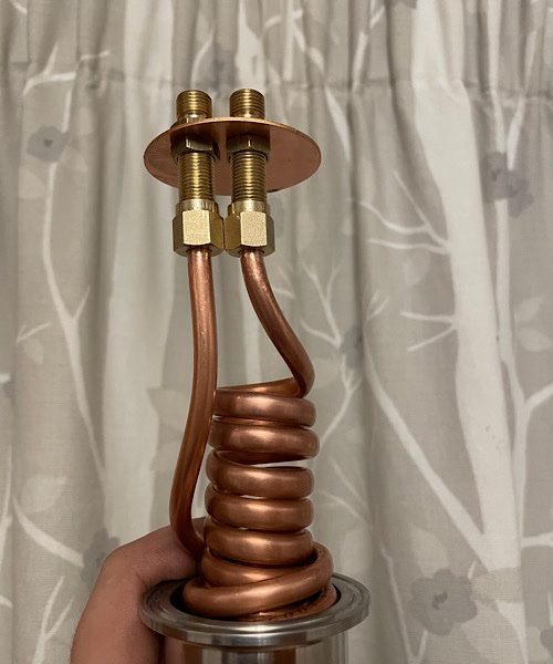

The top condenser I rolled 3m worth of 1/4“ copper tube and think it turned out ok for my first attempt just need to add fittings I am waiting on a couple of clamps and gaskets but nearly ready to get her fired up which will be propane for now, regards Wayne.

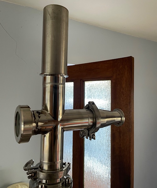

You may need a short spool above the cross, less than 250 mm needed. I can't see if you have one in your pics.

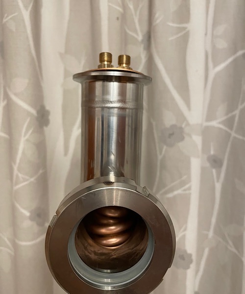

Thanks for your reply it’s most helpful, I have a 150mm spool but need to tig the tri clamp fittings onto it before it’s complete and as I go along I will update my post to show progress, but so far so good the spool is a little over 2“ but there’s method in my madness as the coil I am going to solder a disc onto the inlet/outlet which fits the oversize spool but it won’t go past the 2“ at full reflux so that will be my setting each time, and a rod will fit the disc with little tabs I can adjust the condenser exactly each time.
You can see the t piece was my first time using the tig in a while and I had the amps too low and in turn had to go slow and I cooked it, it needs a full clean up and will polish it out.

So you've got me thinking (which is dangerous).
What if you made a spool that was slip fit over the top that would allow the top to telescope like an old car antenna? You said you had a servo sitting around, would that work? I'm not an engineer, nor am I particularly skilled at building, but you could attach the top section of the coil to the moving outer sleeve and since it will be knocking down everything above the takeoff branch, you shouldn't have to worry about vapor leaks.

Thanks for your ideas, anything’s possible really so I need to have a think but basically I was going to add a plate to the spool outer for the servo to bolt onto, the copper disc is going have a couple of threaded rods to be long enough that it can lower the coil to it’s maximum on the top of the rods another plate that will align with the servo and be long enough to hold the ballscrew nut and it should work pretty well, the servo board is small and has forward/ reverse so nothing else is needed, pretty simple I think lol, we will see, I’m working on site next couple of days so won’t get to do any more till mid week, regards Waynebcook608 wrote: ↑Sun Nov 27, 2022 9:02 am So you've got me thinking (which is dangerous).

Your RC coil is going to need to have close contact with the walls of the reflux chamber. I strongly recommend weaving some potscrubbers in and around the RC to give you that contact.

I have just ordered some, after spending a while trying to find proper copper ones as opposed to coated copper, regards Wayne.kimbodious wrote: ↑Sun Nov 27, 2022 12:37 pm Your RC coil is going to need to have close contact with the walls of the reflux chamber. I strongly recommend weaving some potscrubbers in and around the RC to give you that contact.

SS will work fineMereside wrote: ↑Sun Nov 27, 2022 12:39 pmI have just ordered some, after spending a while trying to find proper copper ones as opposed to coated copper, regards Wayne.kimbodious wrote: ↑Sun Nov 27, 2022 12:37 pm Your RC coil is going to need to have close contact with the walls of the reflux chamber. I strongly recommend weaving some potscrubbers in and around the RC to give you that contact.

No disrespect, but I disagree.kimbodious wrote: ↑Sun Nov 27, 2022 12:37 pm Your RC coil is going to need to have close contact with the walls of the reflux chamber. I strongly recommend weaving some potscrubbers in and around the RC to give you that contact.
Pot-scrubbers occupy space and vapor has to move faster to get around it.
That means vapor is moving faster and has less time to condense on the cool surface of the coils.

I would like to see if there's any advantage to some mesh on the bottom of a CCVM coil.
Maybe use it to "detune" the coil and make the height adjustment less critical?
Possibly force more of the vapor to exit the column, instead of condensing as reflux?

I used some on my ccvm coils just to help it stay in position, which it was a decently snug fit without but would slip under water weight.

Plenty of CCVM operators on here, had trouble getting efficiency from their RC coils until they increased the amount of contact between the RC and the walls of the reflux chamber.
Shady, the CCVM coil is the reflux condenser, The RC on a CCVM is above the offtake. If there’s big enough gaps between the coil and the walls of the reflux chamber then the vapour will go further up before condensing, if at all, or exit out the top of the column, which nobody wants.
I like to think of the RC in a CCVM as a piston of cold, If you have good contact with the cylinder walls you have good compression.
Detuning is not a bad thing it makes operating the RC less binary giving more scope for fine scale adjustments.
