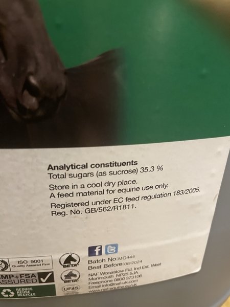

Good luck . Incidentally Molasses usually has a specific gravity of 1.36 - 1.4 so you did well lugging it . Closer to 34kg .
Can you show a closeup of the label ingredients ?
I tried googling it but the only stuff I could find was the 5 litre NAF Molasses . Man that was between $60 and $120 depending where you bought it . Surely you didn’t pay 5x that .

Yummyrum you can see the label below. TBH I was a little surprised at the sugar percentage. I had expected it to be about 40%, a bit higher than what is stated (35%) I'm not sure what the original SBB Blackstrap sugar percentage was and I want to stick as close as I can to his recipe. SBB doesn't seem to trust sg hydrometer readings here so I'm not entirely sure ATM how to calculate/adjust for my wash.

Ferrica your molasses has me a little confused ......Ive never heard of a sugar mill which can extract enough sugar in its process to leave only 35.3% sugar in the molasses, which is the byproduct of that process. That Molasses is either coming from an extremely efficient Mill or contains something other than molasses imo.
If it is that low in sugar it might not hurt to add a little more.......having said that I wouldn't go crazy, you might need to experiment a bit to find out what you can get away with.

Regarding the sugar content of the NAF molasses I'm using. I had previously looked HERE and remembered from that the product was unsulphured and the sugar content was about 40% but my barrel is marked at 35% as we know. So I'm a little confused too. I may even shoot them an e-mail to solve the mystery I'm quite curious now.

https://www.naf-equine.eu/uk/health/molasses
NAF Molasses is an easy pour blend that
"Easy pour blend" says to me that there is something other than molasses in there.
Ingredients link above says .......Composition Sugar cane molasses ........ Analytical Constituent Total sugars (as sucrose) 44.3%........then yours says 35.3%
Lots of conflicting information for sure.

It sure is contradictory.
My take on it is that they procure Mollasses that has a sugar content of 44% and dilute it down to 35% to make it easy pour .
I think this because as Salty says 35% is not typical from a refinery , but 44 % is .
Also , they mention nothing in the ingredients other than molasses , where as every other feed stock that has been that low is usually boasting how much protein and other crap is in , usually what they have added .
This does not .
Earlier on , I said that 20 litres should weight close to 34kg .
If it has infact been watered down , it will weigh a lot less .
This does not .

Even 44% is low going by what I'm told by a couple of local Mill workers Ive talked to.....the average I'm told is around 50%, if they could get more out of it they would.
https://www.sunshinesugar.com.au/wp-con ... lasses.pdf as an example of Aussie Food Grade.

Well I've gone as far as phoning the NAF nutritional helpline and a very helpful lady has promised to get back to me asap on the subject of the mystery of the missing sugar.....
Meanwhile I'm forging ahead regardless with prepping this batch for the ferment this week. I'll be adding in hot dunder and yeast trub today from my previous Lyles treacle efforts and (carefully lol) jetwashing it then throwing in the rest of the gubbins as per SBB's recipe.
I think I'll resist adding more sugar, I'm kinda happy if I can get 7-8% in this volume. I'll keep a close eye on it as it progresses and perhaps post a pic or two when it kicks off.

OK that lovely lady (Branwen) from the NAF nutritional advice department called me back and gave me (a little) more info on the sugar content of their horsefeed molasses brand. She said that the sugar % of the molly does vary frequently, it was down to their suppliers. Although she couldn't (or was unwilling) to tell me who their suppliers were. She also said they preferred lower sugar content as too much can be unhealthy for our equine friends.
I asked about the 'easy pour' quality of the brand and whether this meant there were additives present? She assured me there were none, "not even water"
That leaves us right back where we started but I'm not worried The molly is in the fermenter ready for the mix, putting it back into the drum it came from is a little beyond my capabilities so it's like it or lump it.....
Onwards & Upwards

Ive used this brand of molly for a while and it did use to state 44.3% but I noticed the lower rate on my last order. Not sure why the sugar content has dropped but it didnt affect the ABV of the wash very much nor the flavour,I just added a little cane sugar. I have since found another (cheaper) source of molly which has 45%

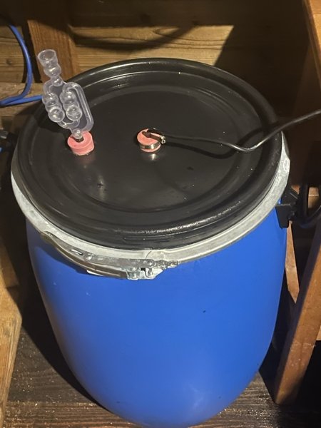

Got the molly wash up and running. Followed the recipe to the letter. Resisted adding more sugar. Used hot dunder and the yeast trub from my Lyles run.
Using the jetwash as advised made mixing a doddle as they say.....
I know SBB spurns checking out SG etc with this mix but out of curiosity I dropped in the hydrometer and was surprised to see it at nearly 1.200 !?!?
Left the lid loose in case it gets too lively overnight. I'm using a suspended 200w aquarium heater with an external digital temp controller. It worked fine on my 30l Lyles wash and is rated at 150l so hopefully will cope OK here also.
Anyhoo roll on tomorrow
