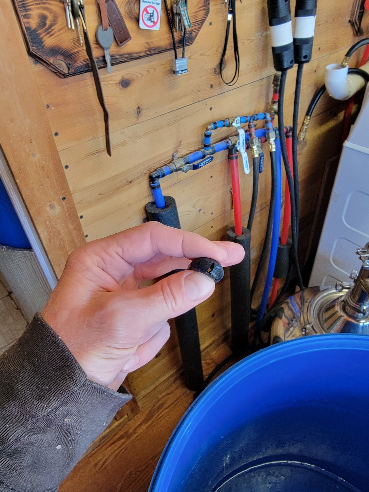

7/8 hi temp silicone end caps for steam wand with a slit cut in it. Works like a champ, the 5/8 one I made built up 1.2 psi so I went larger.

Honestly it's super nice, doesn't clog up and easy to clean. It will hummm.. when mash is cold but goes away about 100 degrees. No different to the thumping of a steel braid. Mine has been thru 16 stripping runs three hrs ea. at 20 gallons in a 26 gallon still and has no wear to speak of. I run a full 11000 watts to it flat out with no pressure issues thru a half inch copper line from steamer. Hope this helps, being able to pull it thru 2 inch triclamp fitting has been much better than removing the ss hose, haven't been burned since. Being so easy and fast to strip on grain is a life changer.

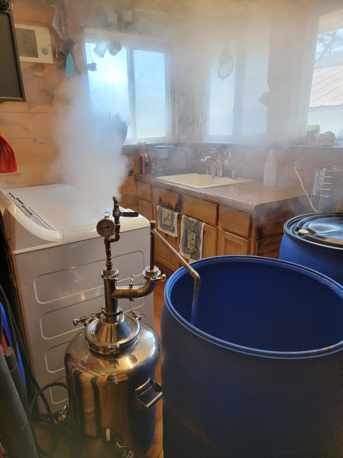

Re: Silicone tip for steam wand
I have used 5/8 and 7/8 powder Coating hi temp silicone caps for 1/2 or 3/4 copper pipe. When steam mashing and stripping in the beginning the pressure will rise to 1.2 psig then fall as the mash heats up but this is no different than the ss braid I was using. I have tried both single and double heads for tips and found that one single tip to be best at 2 to 4 inches from the bottom of the mash tun or boiler the heat will rise and it mixes quite well on its own. Also with just one tip I can put it thru a 2" triclamp fitting also thru the top screw fittings for a blue food grade 55 gal drum which mitigates splashing. I can steam mash 100 lbs grain in 45 min in 40 gal total water volume (i fill to second ridge up the drum) with full conversion using ferm solutions enzimes. My steam setup is 16 gallon with 2- 5500 watt elements (typical stripping run takes 3 hours and i use about 8 gallons of water) to a 26 gal boiler filled with no more than 21 gal of distillers beer I shoot for 20 gal. I found using one element takes longer and heat loss and infiltration adds up which the loss accumulate to more filling of the boiler during heat up relative to your boiler size in my case 26 gal this will prove otherwise for smaller setups. Rambled a bit but I hope this gets u in the right direction. Tips on amazin 25 for 9.99 usd. They are cheap try a couple different cuts to find what works best for your application. I filled my boiler with water with no top for testing but a bucket would probably work.

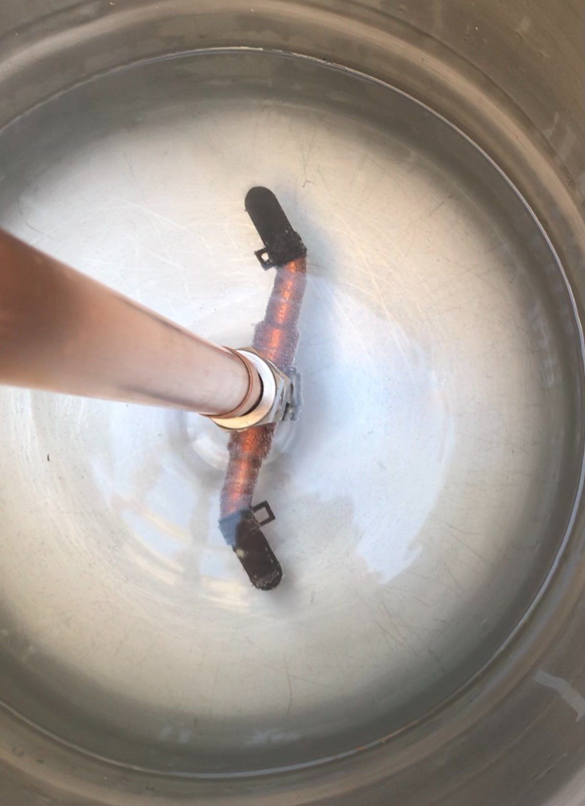

I can vouch that Eric's silicone tip idea works a treat. (Thanks Eric!)
After a 30min (single infusion mash) glucan rest at 111F I dropped the wand into a 10gal rye mash and brought the temp up to 160F in 55min. The silicone slits functioned as nozzles, efficiently dispersing the steam in a linear spray of fine bubbles. Although the angled steam wand rotated a previous water-only test nicely, as viscous as the rye was, the nozzles rotated the mash only slightly. It took a little less than 3qts of water over the course of an hour. (Unlike the pic, I had jerry-rigged some steam arm insulation that needs improving for the next run). Along with application of HT alpha, gluco and glucanase, the step mash came off really smoothly and got force-chilled before pitching with US-05.
An unexpected discovery occurred when I inadvertently knocked off one of the silicone tips with my paint stirrer at the very end of the mash. I knew exactly what I had done because the steam wand was releasing a giant stream of 'boils' that came to the surface. At this late point the mash was already converted thin and completely smooth, but it showed how efficient the regulated steam from the silicone tips was compared to the boils that rose directly to the surface. Post-mash inspection revealed a small amount of grain had entered the open wand arm, and none into the silicone-tipped arm.
The pressure created from the silicone tips stayed consistent throughout the entire run (about .5psi).
Keep in mind i run 2 5500w elements your results may vary.
Started with a 5/8 silicone tip with a small slit, the pressure slowly rose above 4.5 psi and tripped my pressure relief valve. This rise was over a 10 minute duration. The problem is, it was not great in the venturi department lol. It appeared the steam collapsed rapidly and did not have the pressure thru the venturi to create the low pressure in the venturi which did not draw the extra volume which was not impressive. I did try a larger slit in the 5/8 tip dropping the pressure to the normal .5 psi which was comforting. The lower pressure seemed to work better as it appeared to have more moving volume. I do think a proper 15 degree venturi properly spaced to the tip and with a hot mash would work better. The question remains, will I still have to stir the mash until it gets above 160*f and does it work better than the 7/8 tip. I put the 7/8 tip on and tested it, it performed better than the venturi and also better than the 5/8 tip. It looks like it has a wider slicing effect thru the water. I did try an X cut on the tip it also did not perform well.
My conclusion is the 7/8 tip works best with a slit. One tip is better than 2. The injector rips the mash when at temperature. You will need to stir the mash during heat up. Heat and bubbles rise put the injector at the bottom of the mash. No need to preheat mash water, fill the fermenter and insert steam setup, warming water with steam. Add ht enzimes to the water then the corn or grains it saves heating up your boiler twice since you will still need to steam that dang corn. I only need to stir the mash until it heats up then the tip takes over and churns the mash, I cook 100 lbs of grain in 55 gal barrel with 2 5500w elements I did not test 1 5500 watt element or smaller fermenter sizes mileage may vary.
Was hoping for a slam dunk or home run but it's not the case with this tip.
