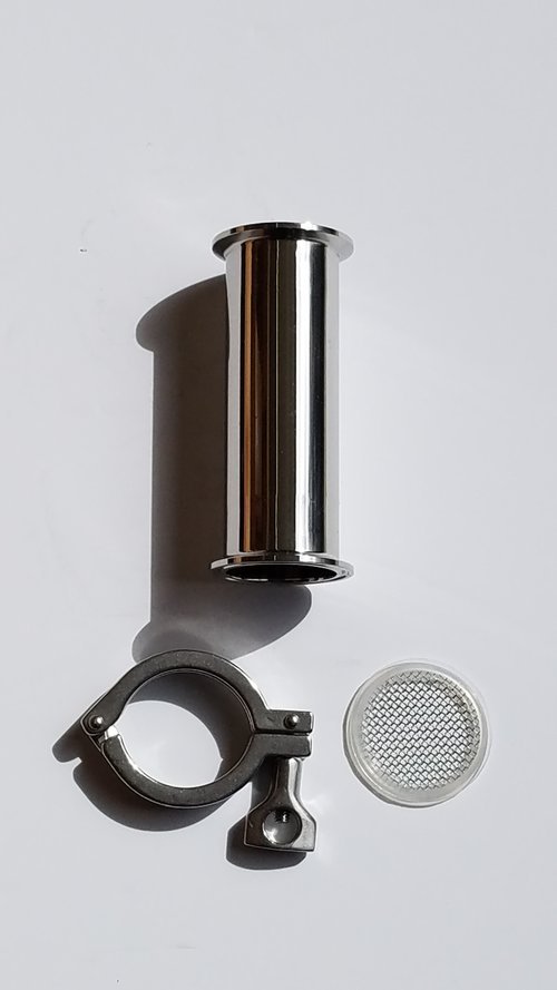

I have a ket still that has a 2 inch column. I had never heard of a gin basket but could I put something like this at the base of my keg and put the column on top?

Generally the gin basket is positioned at the top, near the product outlet.

2" is a very narrow basket, which means high vapor speed through the botanicals, plus a risk of blowing botanicals into your condenser unless you run very slow. There was a post a while back by someone who had trouble using one.
Probably ok for a few citrus peels, but not for the whole bill.
