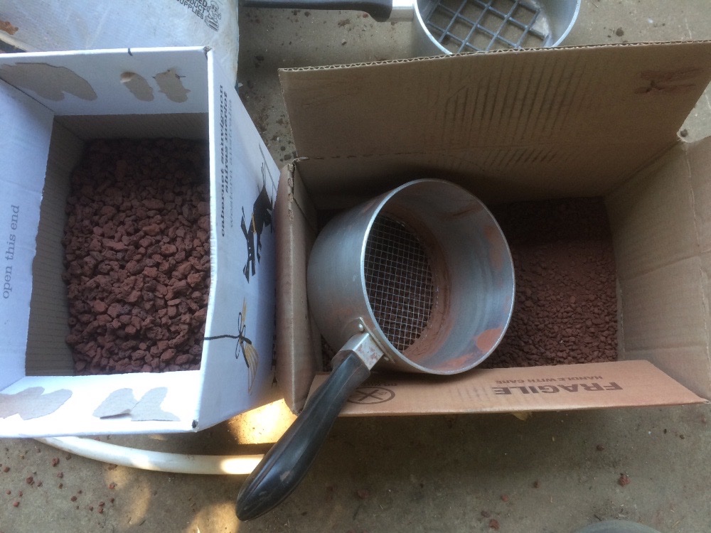

Natural first thought would be Lava rock/scoria. I'm not sure if anyone else from New Zealand can chime in here, but all the rock I've been able to find here is a solid red colour, not the nice black rock I keep seeing photos of on here. The Red colouration is supposedly caused by iron oxide, which doesn't strike me as being particularly nice to pass your product through. Has anyone tried using red scoria before, and if so, what do you think of it?
