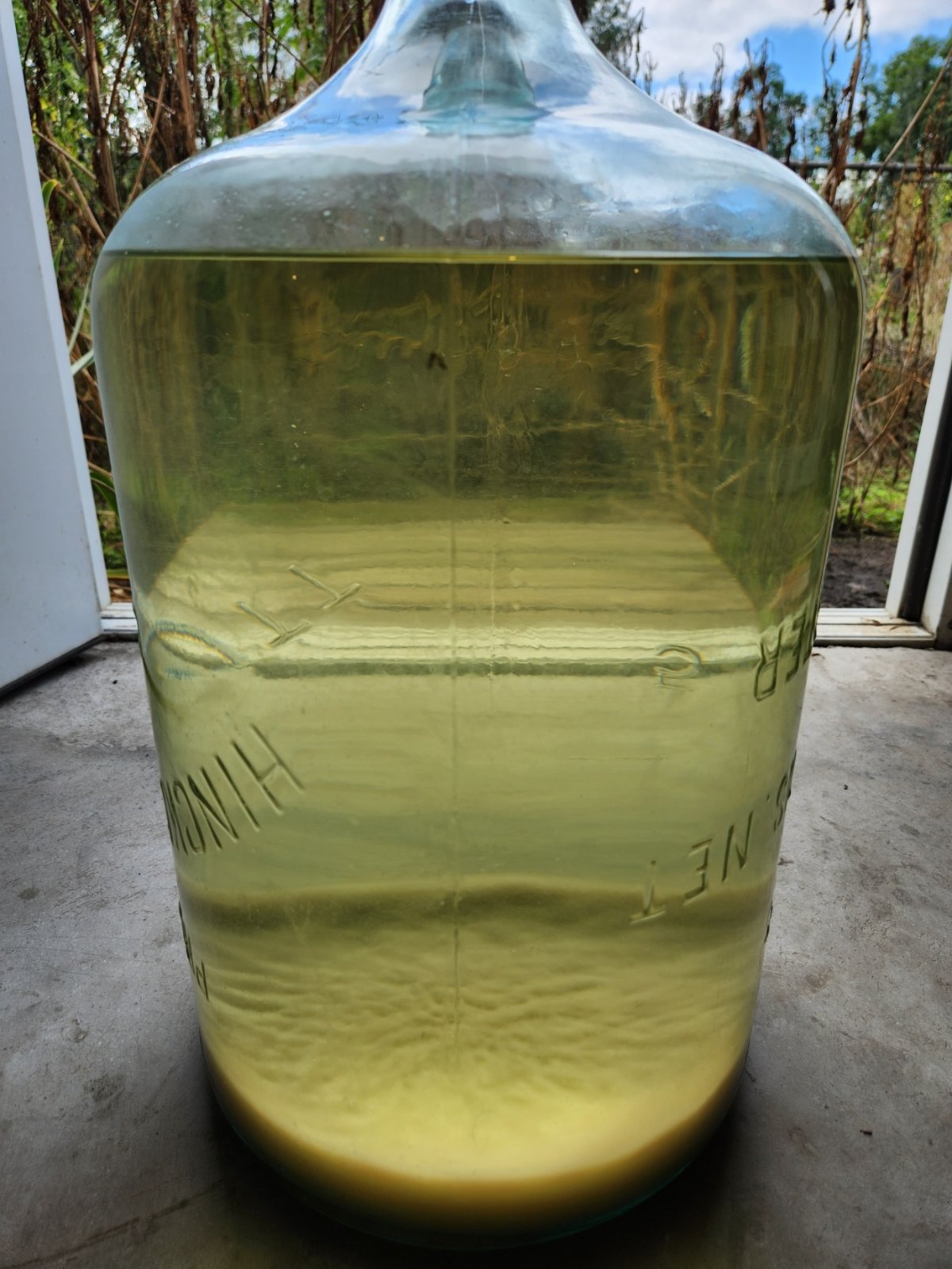

Clearing using Bentonite Clay is a rabbit hole to go down. Search this site, search YouTube, even search Google. You'll fine a lot of different recommendations of how to use it. Many recommend using it different ways, like different ratios of water to use to hydrate it first. Different lengths of time to let it hydrate. Some say to use boiling water. Some say to add Bentonite to the wash in the beginning (before or after pitching yeast). I've been testing different ways of using Bentonite and this is a pic of a clearest wash I've done to date. To do that, I hydrated it, added it to the wash after fermentation, waited 24 hrs, racked it and cleared it a 2nd time. I'm still testing with Bentonite because I really want to get more efficient with it. I'm not trying to talk you into clearing your sugar washes. I'm only sharing my personal experience and the results of the rabbit hole I'm currently going down.
