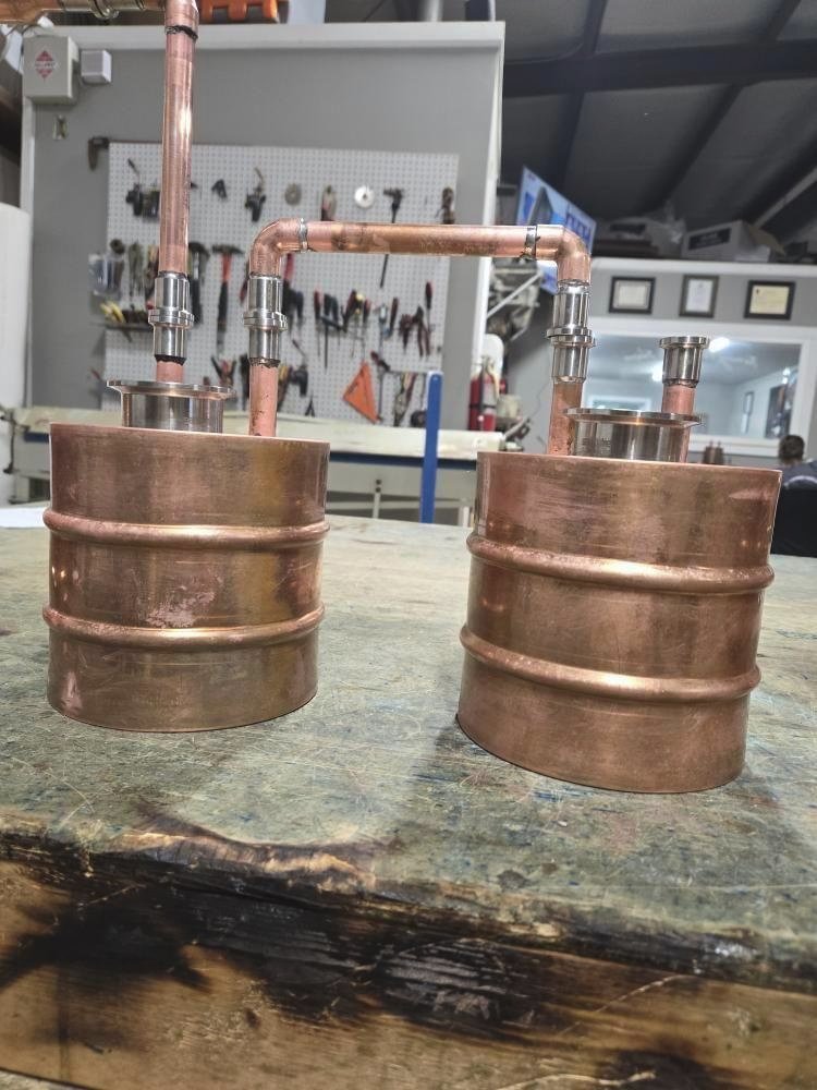

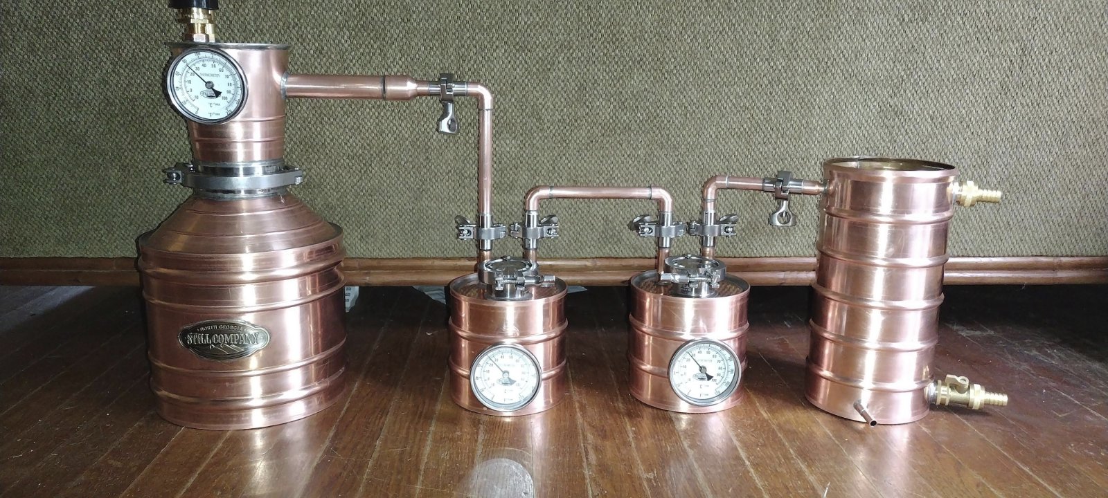

After many years of debating on the matter and many years of holding off due to cost and all the other mandatory things in life, I finally decided to do the thing that I said I wanted to do nearly 20 years ago. That simple, "huh, it'd be fun to make my own scotch some day" really stuck in the back of my mind.
I have researched it many times over the years and have even had opportunities to borrow some stainless equipment - but I knew it wasn't what I really wanted and wouldn't give me the satisfaction nor answer the question gnawing at the back of my mind all these years... "Can I do that?"
Getting older, watching certain tv shows just to fester the idea granule fermenting deep in my brain, knowing I'm looking at 10 years of aging to do it "right", minimally - I'm sort of running out of time on this rock to have but 1 shot at getting it right. The dark comedy of the whole thing; IT WOULD BE terribly hilarious to fill a quarter cask, wait 10 years and have it be truly awful.
I would sit and use 3D modeling software to model a still and then I would put each piece, dimension specific onto a flat plane so I knew I could get the right size copper sheeting. Knowing I have no tools and no experience and really not much ability. I'm a firm believer in the concept of doing it right the first time and buy it once, buy it for life. I LIKE QUALITY. I didn't really trust myself to build this apparatus and end up with what I know I truly wanted. I wanted this to be something to last generations; to be thought of as more than a still, but rather, a survival tool.
So, this past spring, I finally reached out to a builder and sent them some 3D models, really just feeling it out. After a bit of back and forth and ironing out all the details...
Please know. Before you see this:
Others have tried to talk me out of this idea. The builder tried to get me to change my mind and to do something different. Nearly declined to do the build altogether at one point in the discussion. (Was never hostile, mind you. I just had something in mind and couldn't be talked out of it.)
This past week, my idea was brought into existence. I'm in the pursuit of a simple life goal and on the way to knocking something off the bucket list!!!
- 2 gallon main boiler with 4" tri-clamp for bootlegger cap with 1" lyne arm, reduces to 1/2". thermometer port and pressure relief valve in cap. - 2x .5 gallon thumpers with 2" tri-clamp fruit port. thermometer port. - 1 gallon condenser with 3/4" water house attachments. ~8' 3/8" worm. Full tri-clamps at all attachemnts. 18 gauge / 32oz sheeting
I have read these forums for years even though I was not yet a member. I've read about various builders and the risks. I read the blacklisted and avoided. I read about various buyers remorse posts and have read the opposite side of the coin as well. Here's to hoping this apparatus is everything I've been dreaming of!!!
-MicroMini
-MicroMini

You probably have seen my thread on " What Two Thumpers Can Do". But if you have not, here is the URL:
viewtopic.php?p=7783827#p7783827
With your small size, I would worry about heat losses. Some good insulation on the pot and thumpers should be beneficial. Power to run the still can be less than 500 watts without heat losses.
If I can help you plan some runs and see what to expect from them, just ask.

I have theoretically considered the heat issue. One reason I went with a heavier copper even though they are so small. I have some Roxul Safe n Sound rockwool insulation. I figured if I had to, I would vacuum seal some of that and then sandwich that between two layers of Reflectix. One reason I didn't want down spouts on things is the ease of wrapping if I need to do so.
I have and induction cooking plate with good controls. It's 1200w. However, copper not being magnetic, I will be using a thin carbon steel plate on the induction top and setting the still on top of this. We'll see how that works out. However, layering like this may be far too inefficient a heat source and if so there are easy enough electric solutions / alternatives. Single unit portable kitchen burner will work fine as well.
I think like anything, it will just be a matter of learning what ever equipment I end up using, learning how the still reacts and responds to it and adjusting accordingly to stay within the proper parameters. I mean, in theory, right? How hard can it be...

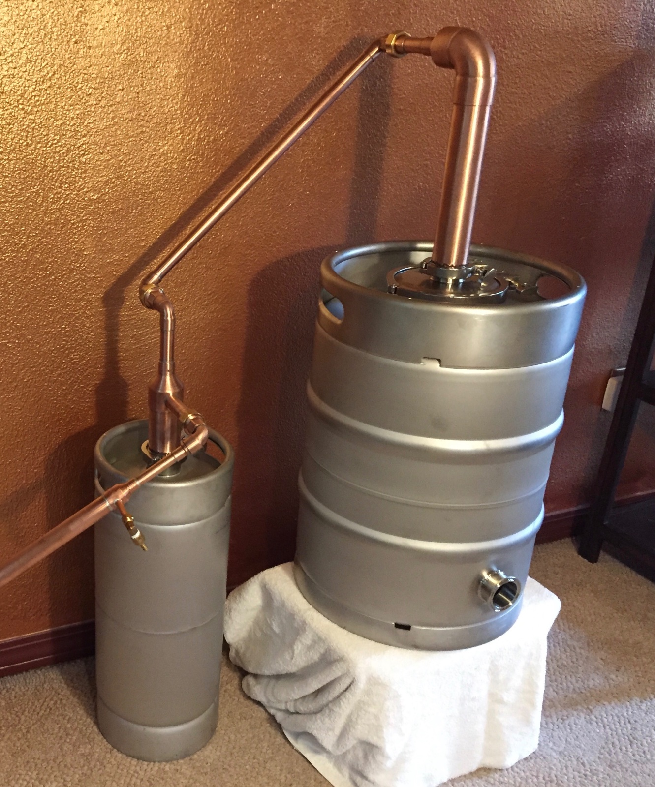

Nice looking setup micro mini. Sounds like you have at least one more build project to complete; a custom stand or something to help with leveling your still.
Once you put a hotplate and diffuser plate under the boiler, everything else will need to be raised to match. If you ever want to make boiler height somewhat independent from the rest of the still, you can add a little length and a few elbows/unions to the Lynn arm connector between boiler and first thumper.
Below is an example of a that Lynn arm design where all boiler inputs/outputs are horizontal and the dual elbow Lynn arm connector allows for variable heights.

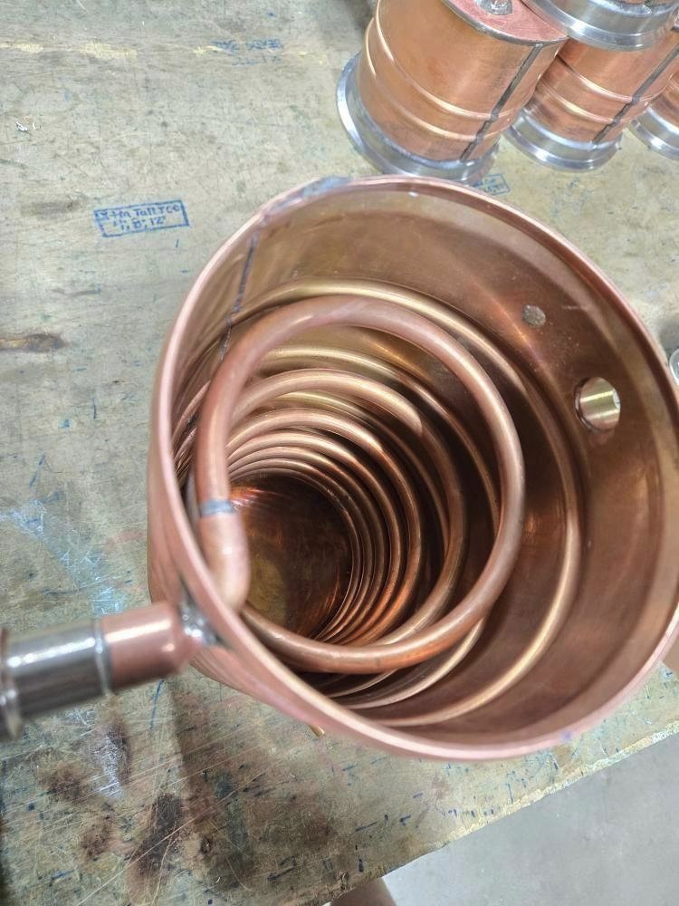

I learned something else. The condenser has a slight leak in the solder just above where the worm exits the canister. It's okay. I felt like a chump anyway not having to have lifted a torch to have such an amazing mini pot still - I THINK I have solder here that is acceptable and I know I have a torch I can use. This a pin size hole that just has a slow continuous laminate flow. IF it wasn't directly by the worm and therefore a contamination risk to any distillate, it'd be irrelevant. The rest of the still is solid and tight. Ran plain water perfectly. LOL.
Simple fix. DO I need to worry about the solder that is in place getting soft and altering the entire seal or can I just lay a small bead down?

In my experience , you can't "just lay a small bead down" to cover the hole . ......that just means a dobblet of Seagull shit that sits on top but doesn't do SFA.micromini wrote: ↑Thu Aug 08, 2024 4:27 pm I learned something else. The condenser has a slight leak in the solder just above where the worm exits the canister. It's okay. I felt like a chump anyway not having to have lifted a torch to have such an amazing mini pot still - I THINK I have solder here that is acceptable and I know I have a torch I can use. This a pin size hole that just has a slow continuous laminate flow. IF it wasn't directly by the worm and therefore a contamination risk to any distillate, it'd be irrelevant. The rest of the still is solid and tight. Ran plain water perfectly. LOL.
You need to rework the whole joint . That means reheat it with your torch around the exit pipe joint .... you may get lucky and the solder present will just melt and flow filling the pin hole . Worst case , you'll need to add a bit more solder .
Important things to think about . The worm is thicker copper and there is a lot of it to soak up the heat . The flake copper is thinner .
When soldering such things , it is important to distribute the flame so that equalish heat is on both sides of the joint .
I would send most heat to the worm

So this was all REALLY excellent advice. I put a bit of flux and HOPED it would just slowly bead over, but nope. There was enough tension on the worm that it moved about a cm causing the previous solder to sink, but NOT fall completely though. This actually DID seal the tiny pinhole, but I didn't like the look. So I applied a bit more flux, heating the can and paying attention to the worm making sure not to get it so hot the color changed - was able to get the solder to flow around the joint almost PERFECTLY looking like a factory seal, and then I got excited and pulled the solder across the flame and dropped a blob on the can.... DOH.Yummyrum wrote: ↑Fri Aug 09, 2024 3:17 amIn my experience , you can't "just lay a small bead down" to cover the hole . ......that just means a dobblet of Seagull shit that sits on top but doesn't do SFA.micromini wrote: ↑Thu Aug 08, 2024 4:27 pm I learned something else. The condenser has a slight leak in the solder just above where the worm exits the canister. It's okay. I felt like a chump anyway not having to have lifted a torch to have such an amazing mini pot still - I THINK I have solder here that is acceptable and I know I have a torch I can use. This a pin size hole that just has a slow continuous laminate flow. IF it wasn't directly by the worm and therefore a contamination risk to any distillate, it'd be irrelevant. The rest of the still is solid and tight. Ran plain water perfectly. LOL.
You need to rework the whole joint . That means reheat it with your torch around the exit pipe joint .... you may get lucky and the solder present will just melt and flow filling the pin hole . Worst case , you'll need to add a bit more solder.
I thought to sand for about 2 seconds and saw the scratching and decided the blob was worth the character and the memory.
