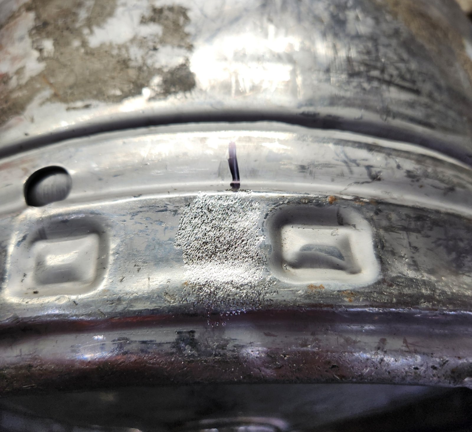

I marked the 4 locations on the keg where I wanted to install the casters. Thoroughly abrade each area and de-grease them.
Thoroughly abrade the surface on each of the nut couplings and de-grease them.

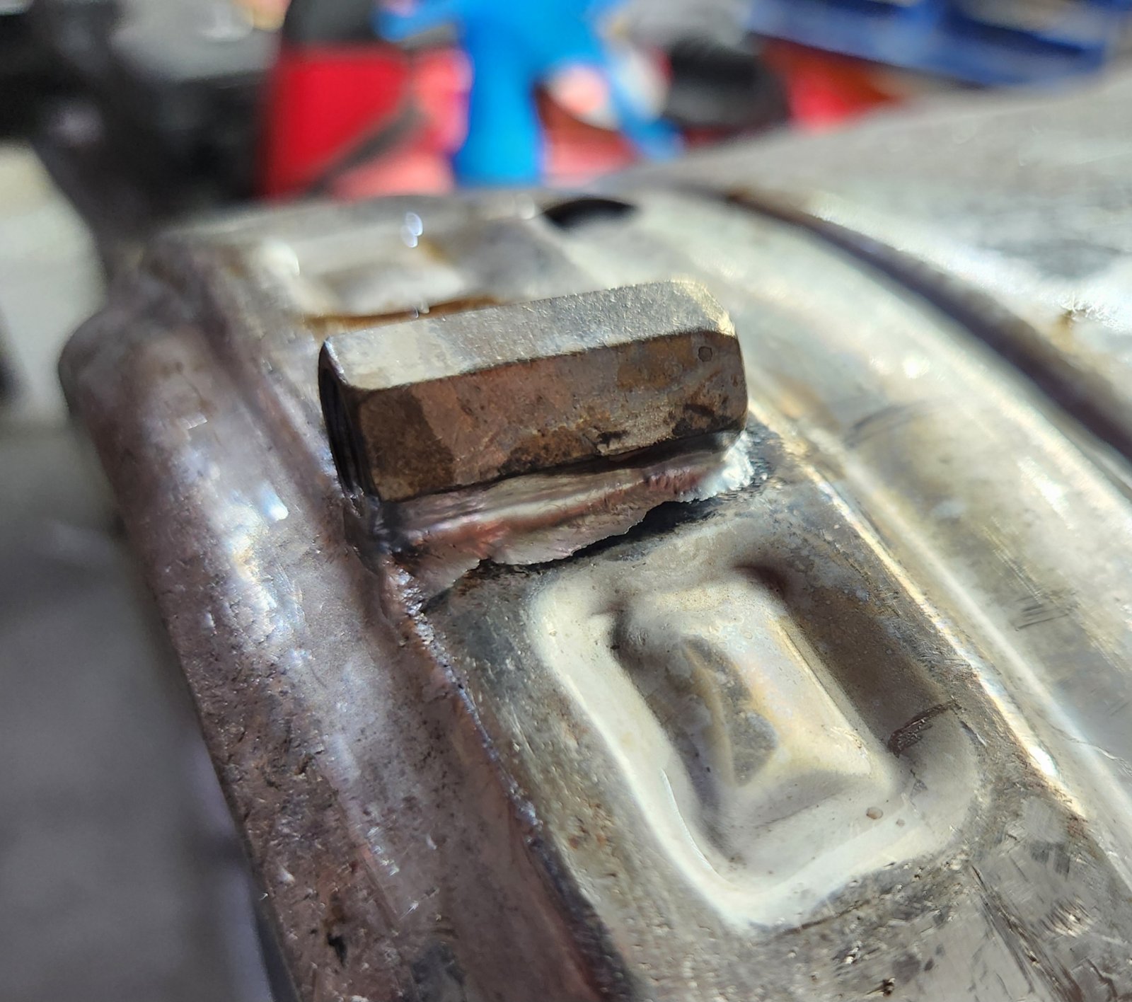

Flux well. I used Harris Stay-Clean Soldering Flux and Silver Solder. I heated the nut and the surrounding area using a propane torch, fluxed, continued heating and soldered the nut into place. In most cases the nut solders very well and no more work needed unless there's a blob of solder on the bottom that needs ground away. In this instance the solder joint didn't look great so I flipped the keg on it's side and heated the solder up again.
I flipped the keg over, heated the nut, the solder flowed and the joint looked MUCH better. Like I said, in most cases I didn't need to do this and this was the ugliest one of of them all.

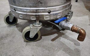

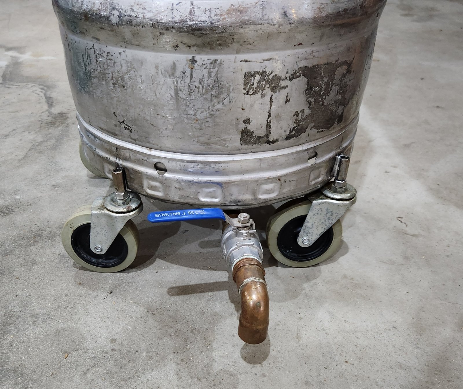

All four coupling nuts are soldered to the bottom of the keg.
Just screw in the swiveling casters.

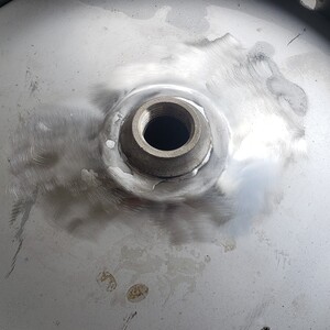

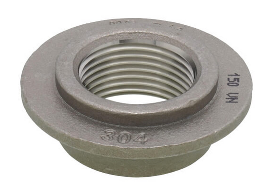

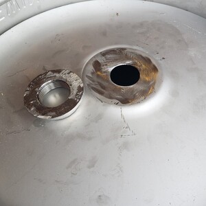

As for the bottom drain, I used 1" Weld Spuds for two of the kegs and a 3/4" Weld Spud for another one.
Weld Spuds have a protrusion on the back side that I ground flat.
I drilled a hole using a step drill bit. I used a Die Grinder to grind the hole a bit larger. I thoroughly abraded the back side of the Weld Spud and the surface of the keg.

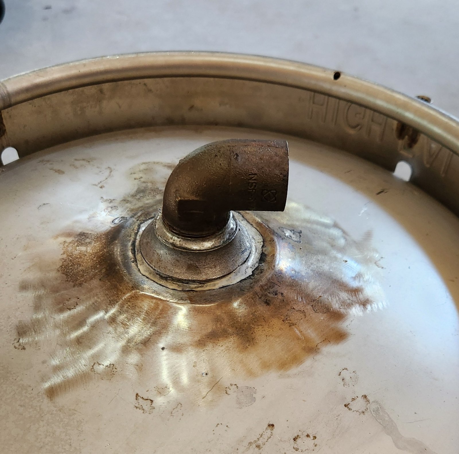

I soldered it on using Silver Solder and Harris Stay-Clean Soldering Flux.
Here it is after a little bit of cleaning.
I screwed in a brass elbow and decided to solder it into place too so I'll never have to worry about that joint leaking.

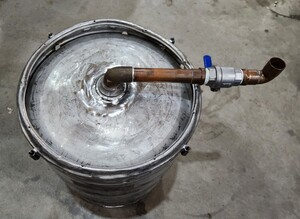

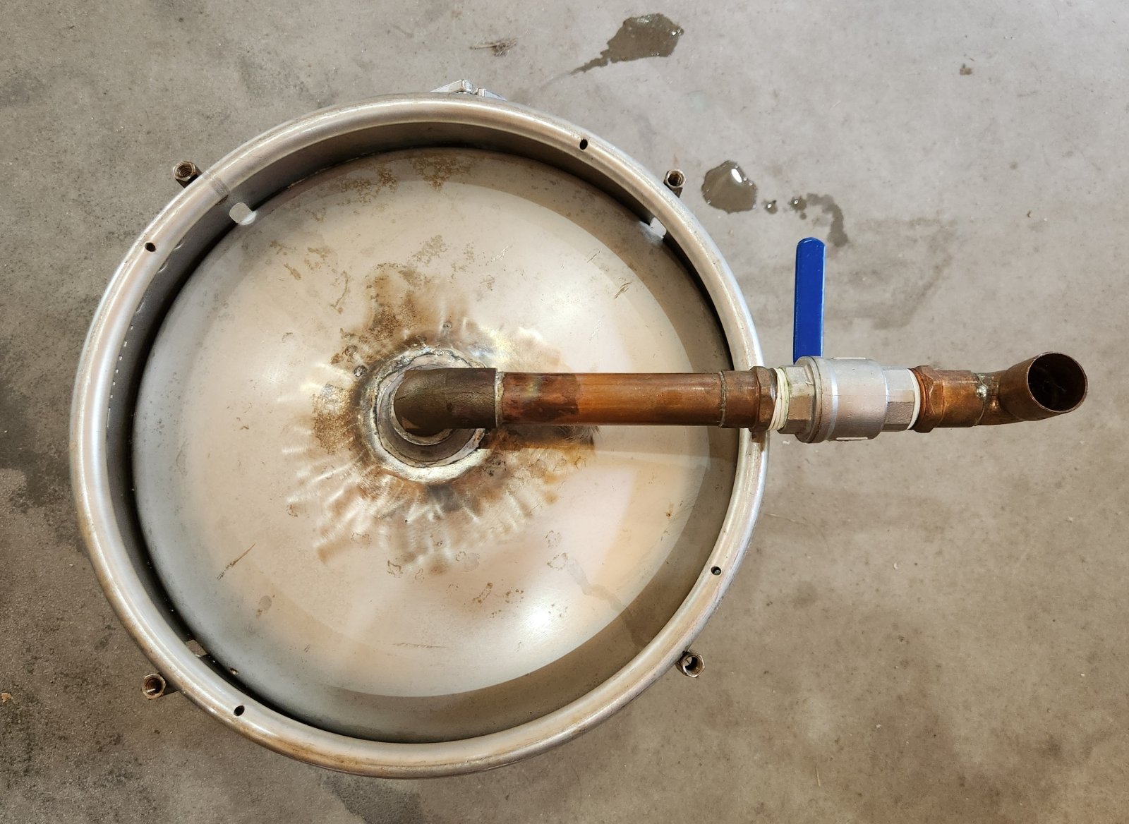

Fittings installed. Just a little copper pipe, a threaded adapter, a stainless ball valve, another copper adapter and copper street elbow.

Looking good. I have a side drain on mine cuz fire. Lol. I sometimes use propane or wood
- Salt Must Flow
- Posts: 3149
Re: Keg Modification - Bottom Drain and Swiveling Casters
I have a side drain on a Keggle I can heat with gas or electric. I have to tip it to drain almost completely, but that's the trade-off for a side drain.

Those weld spuds look cool. I'm gonna have to see if I can get my hands on some. My bottom drain is a 1" bulkhead adapter. I had a stainless elbow coming from that and the damn thing would unscrew a little each time I opened or closed the valve causing the Teflon tape on the threads to fail! I was thinking about soldering but soldering to the bulkhead is non trivial.
If I was using one of those weld spuds on the top of a still for connecting a column I wouldn't be worried at all. The flange gives a good mechanical connection and lots of surface area for the solder. I bet you could lift the keg when full by the spud!

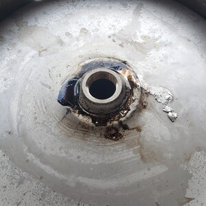

Nice job SMF and very fit for purpose
LOL , your so called ugly joint still looks Beautiful to me

Yeah cracking job, and as far as I'm concerned a joint that doesn't leak or fail, is a good one. I suppose if you know it's there though, and you have to look at it all the time, then it doesn't hurt to tidy it up a bit.

It was ugly, but I fixed it. This is before I fixed it. It's pretty ugly.

Top fitting? Do you mean to attach a column or a riser? I've never soldered a ferrule such a critical purpose. I'm not saying it cannot be done, I've just been too scared to rely on a solder joint to support my column. I've always had those TIG welded. When in doubt, I don't.Still-Learning wrote: ↑Sat Sep 21, 2024 12:35 pm Thanks a LOT! This was just the kind of stuff I was needing to see. Excellent work with tools at hand.

Do it with confidence. I had two, 2" lids for my milk can boiler, and converted one to a 3" by cutting off the 2" welded ferrule, expanding the hole and soldering on a 3" ferrule with Harris Silver solder. Its rock solid. I have enough confidence in it to grab the top of my 3"X 24" riser and tip a full 13 gallon boiler 45 degrees.Salt Must Flow wrote: ↑Sat Sep 21, 2024 12:53 pmTop fitting? Do you mean to attach a column or a riser? I've never soldered a ferrule such a critical purpose. I'm not saying it cannot be done, I've just been too scared to rely on a solder joint to support my column. I've always had those TIG welded. When in doubt, I don't.Still-Learning wrote: ↑Sat Sep 21, 2024 12:35 pm Thanks a LOT! This was just the kind of stuff I was needing to see. Excellent work with tools at hand.
