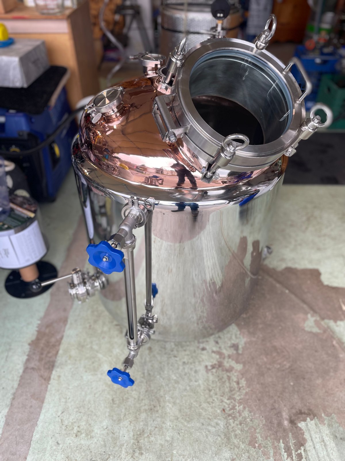

Received the boiler yesterday! It turned out pretty nice. Only one or two minor complaints. It's setup with a sight glass, and 1 bar prv, and a copper dome.

I want to hear the nit-picking, please.
- Salt Must Flow
- Posts: 2634
Re: oakstills bain-marie
Yes, minor complaints need voiced.
That giant glass port is awesome.

- Posts: 4284
That's damned sexy!

I had to look a couple times to figure out the two heating elements ports.
The reflection on the shinny boiler of the tri-clamps had me confused.

As far as complaints... they sent the light-weight cheaper tri-clamps... the ones that get rough to tighten the tighter they get. But so far the biggest complaint is with the castors I ordered. They built it with only three small (1 or 1.5") castors, two of which swivel & lock, but the third is fixed. It makes it awkward to scoot around and also creates a tipping point. It's partly my fault because I did not give specifics.
Nothing is tested yet so I won't get too far into it. I never planned on wheeling the thing around once fully assembled with a column. But we'll see how she goes once full of fluids.
Otherwise its a beautifully crafted machine. I'm stoked on how the copper dome turned out, very nice welds. Maybe more complaints to come as I get more into it, but really, nothing is perfect.

Yeah OakStills clamps do suck. They are 'light duty' clamps. I really wish they listed 'heavy duty' clamps on their site for a higher price. They would sell like hot cakes. I found a pic online showing the difference between light duty, heavier duty, heavy duty and super duty clamps look like. I can't find the pic.
You should be able to replace the casters right? Can you add a 4th caster?
EDIT: I know of one thing you could do! You could remove all the casters, cut a piece of 3/4" plywood (large disk) as a base for the boiler to attach to using the 3 caster brackets. Now attach 4 or more swiveling casters to the underside of the plywood base.

Having three casters can be nice because it is easier to setup on an uneven floor. Maybe consider a way to widen the stance of those three? With four the column can be tippy if your floor is uneven.

I was told that if the floor is not even, all four wheels will be stable within a 1/4 turn of the boiler.

Nah. Maths says otherwise.Salt Must Flow wrote: ↑Wed Dec 18, 2024 7:38 pm I was told that if the floor is not even, all four wheels will be stable within a 1/4 turn of the boiler.

Very creative thinking Salt! It's something I'll address later if need be. First thing is to get it up and running... I'm not sure if they built it to the specs I requested... thicker 3mm walls, and a 1bar PRV so I can run steam pressure in the jacket. They sent only a .02mpa relief valve... sooooSalt Must Flow wrote: ↑Wed Dec 18, 2024 4:41 pm Yeah OakStills clamps do suck. They are 'light duty' clamps. I really wish they listed 'heavy duty' clamps on their site for a higher price. They would sell like hot cakes. I found a pic online showing the difference between light duty, heavier duty, heavy duty and super duty clamps look like. I can't find the pic.
I'd run it with the .02mpa PRV to see if it's too slow.
Does the pot have a agitator?
