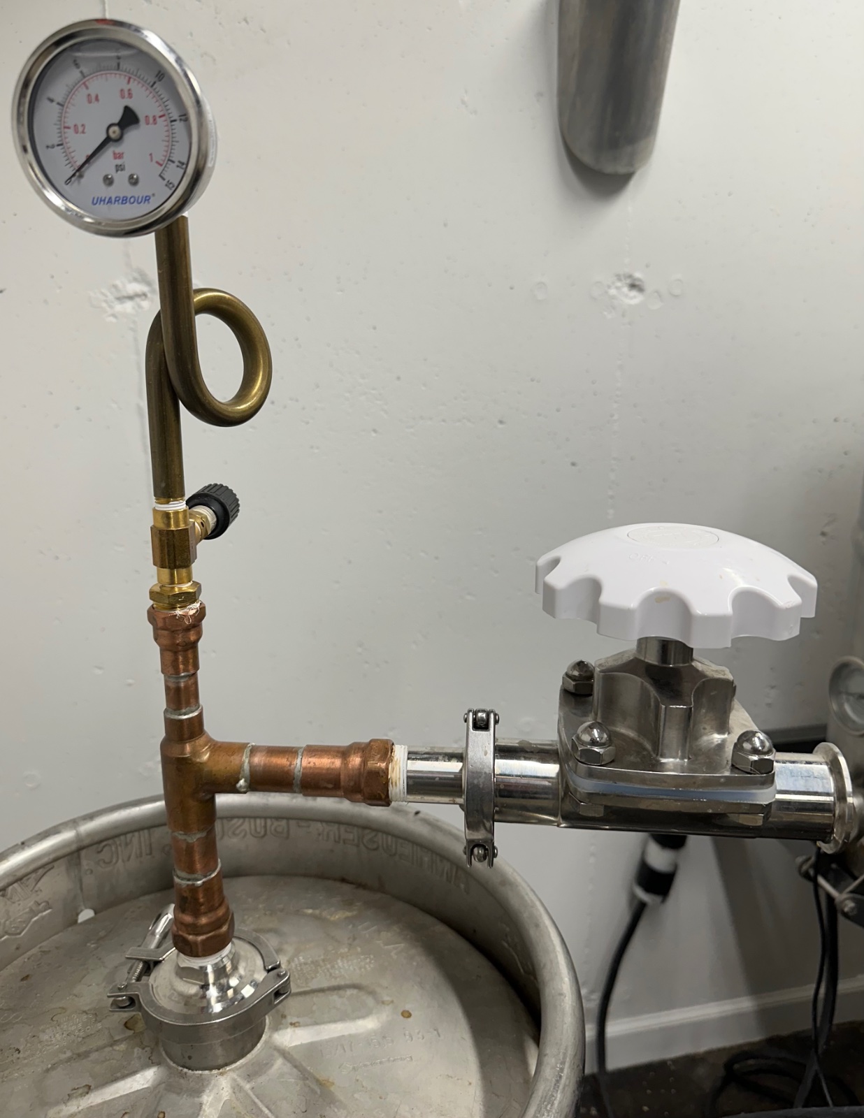

Here is my steam head unit with PRV and diaphragm valve:
I use a 25 gallon aluminum pot with an added gasket and copper manifold at the bottom: I also cover everything up with old comforters to reduce heat loss.

Hello Old Forschotz,Old Forschotz wrote: ↑Sat Jan 18, 2025 3:37 pm
This is steam injection correct?
Is that diaphragm valve do anything on a steam injection setup, or am I missing something (happens more often lately)?
In the operating range mentioned, the pressure downstream of the valve will always be the liquid depth of the still, say ~ 16"H2O?

Yes it is steam injection. The diaphragm valve allows me to dial in the pressure in the keg and sets the flow rate into the still.
The hydrostatic pressure would be less than 1 psi from 16” of water. The steam has to expand after the diaphragm valve because the pressure drops, but quantity of heat energy doesn’t change.

How do you like this diaphragm valve?
I just got one of these to control the feed rate on my beer pump, but I'm not ready to test it yet...

What am I missing?
I agree there is no significant net energy loss across the valve, but building boiler pressure to then drop it across the valve has two drawbacks with no upside.
(1) Unnecessary pressure risk.
(2) Increased heat loss in the boiler.
Take the valve out and you’ll get the slightly more heat transfer to the still. No?

Besides volume I am surprised you used an aluminum pot , especially with the kegs you have. Some of our wash/mash's get pretty acidic which will leach aluminum into your wash. The valve could be problematic for some but it's your shed. I would love a 35 gal boiler rather than my 15. I have been looking for a used 150 stainless steel steamer for tomales.
