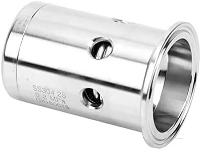

I have two of them planned as part of the upgrades I want to do for my setup. I was thinking about tying a Crown bag around them while I'm running, but the can is a good idea. They're 2" tri clamp PRV/VRV so I had figured I could tie them below the ferrule.LWTCS wrote: ↑Tue Jan 07, 2025 12:56 pmIt is typically more of a crack than a pop,, so to speak.

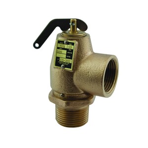

I was a little confused by this statement. I've had to change my underwear after being near a pressure safety valve (PSV) that lifted even though the outlet was piped out of the building.
A PSV is different than a PRV in that it opens abruptly and does not reseat until a lower blowdown pressure is reached. If you purchase a steam generator or a boiler, it will have a PSV which is a boiler and mechanical code requirement. The sizing of this valve is based on a blocked discharge on the boiler with full heat input. PSV's have a rated steam capacity and set point.
The PRV that I see many using here are designed to protect a tank like a fermenter and have unknown steam capacity. These valves will throttle as Larry described.
