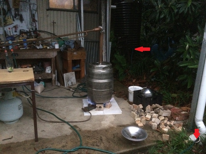

Another option for making liebig hight adjustable is to use a stainless union as in photo below.

I said union for you LOLSaltbush Bill wrote: ↑Wed Jan 08, 2025 9:44 pm Another option for making liebig hight adjustable is to use a stainless union as in photo below.

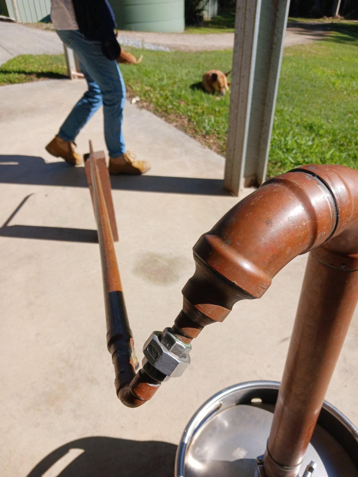

This is what I did for a small still to run in the house Willie.
35mm from the lid, reduced to 22mm for the condenser.
I seen to remember you wanted to keep things as simple as possible, hopefully the pictures answer your question.

Thanks MooseMan for the pictures.MooseMan wrote: ↑Wed Jan 08, 2025 11:07 pm This is what I did for a small still to run in the house Willie.
The input end of my PC has half of a 1-inch copper union to a 1-inch to 3/4 inch reducer to a 3/4 inch 90. (It's 3/4 vapor path, 1-inch water jacket)
The union at the end will allow me to put it at whatever angle I need it at for collection.
This should mean that I can leave the output of the still head fixed and not need to adjustable.

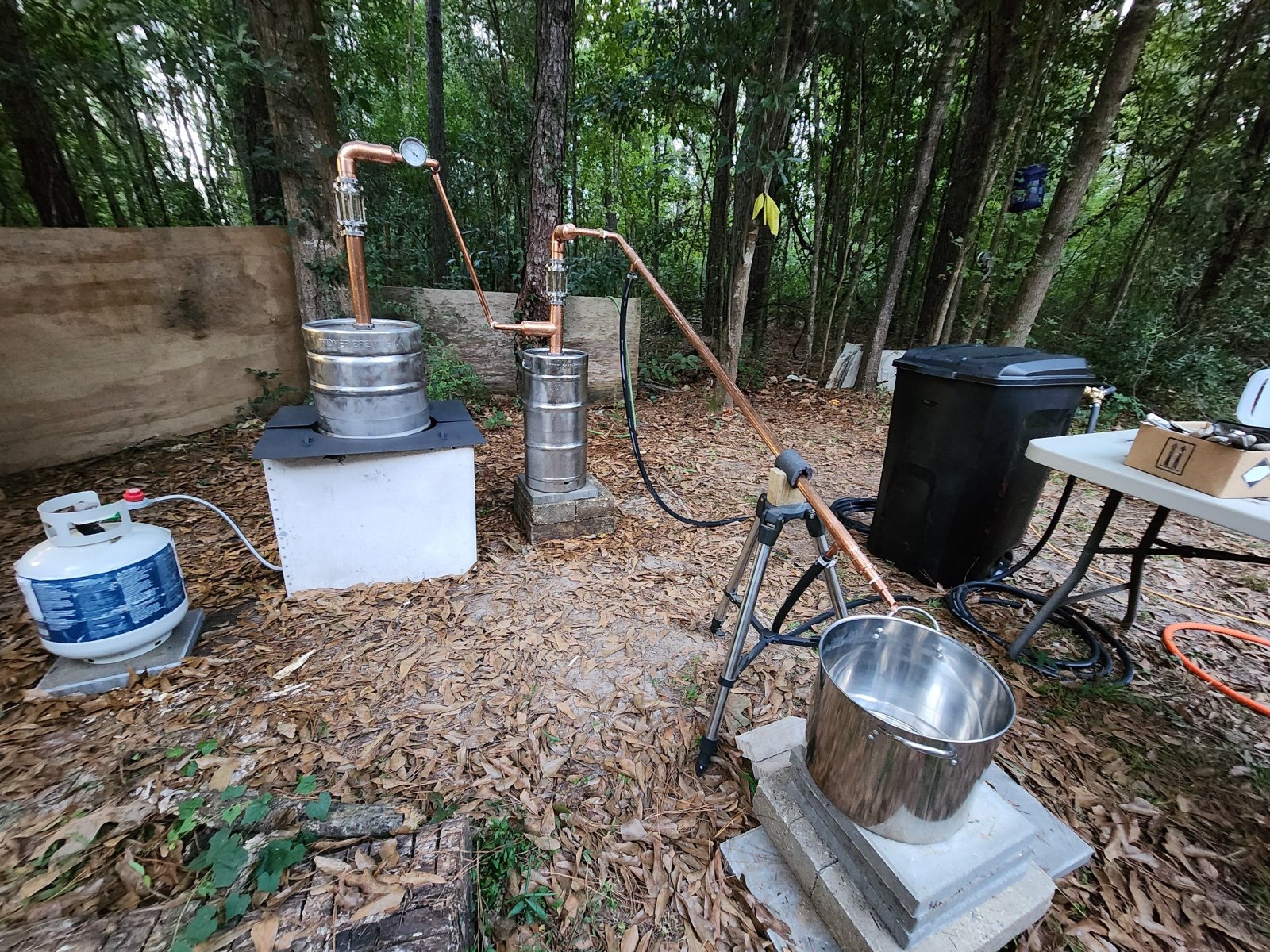

Rusty,Rusty Ole Bucket wrote: ↑Thu Jan 09, 2025 5:02 am I dropped to 3/4" coming out of the head then soldered in a couple of 90s and a copper union to make mine adjustable. I'm about to redo a lot of this setup and I'm going to a 2" shotgun with a couple of 2" 90s with tri clamp ferrules.

That's a mighty fine looking outfit ya got there Mr.!!

Well, thank you Sir, I'm mighty proud of her.
