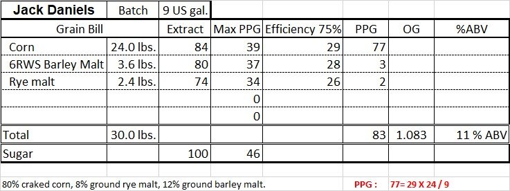

This is how I proceed, the method is adapted from John Palmer's book “ HOW TO BREW "
You can find that book here :viewtopic.php?p=7803275#p7803275
What you need to find is the dry extract of the cereals you are using, this is available on each malting company website.
There's also a table in that book providing those values (table 9 page 118-119).
The method is explained in Chapter 12.
In fact, it's not rocket science. One has to know that one pound of sugar dissolved in one US Gal yields a Specific Gravity SG of 1.046, some sources say 1.045. I keep 1.046 like in that book. After that, 46 represents 100% yield, the value achieved by sugar. Let's take barley, the extract is 80, what is 46% of 80: 37, 37 PPG, Points Pound Gallon. The efficiency of your equipment is never 100%, you can mostly reach 75-80%. If we consider 75% efficiency, the maximum PPG yield by barley is going to be 37 X.75 = 28. The % ABV can be found in FermCalc.
