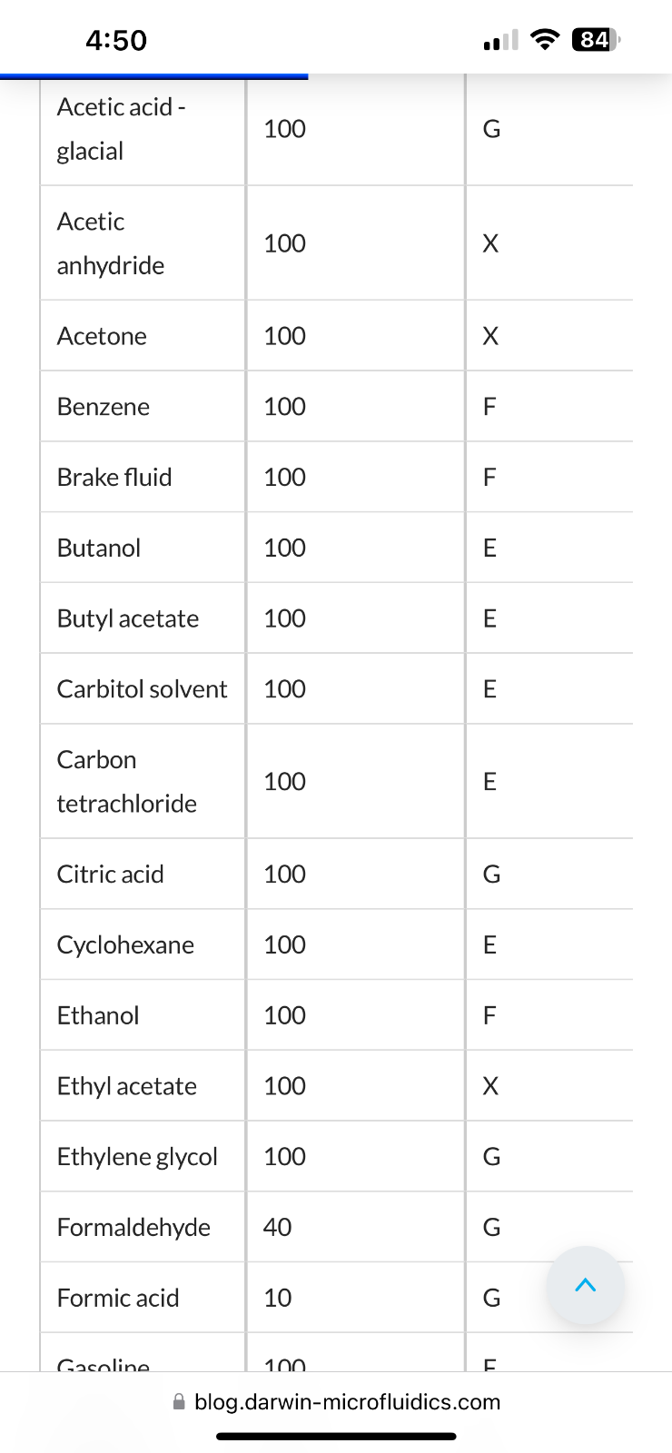

chemical resistance chart for PPSU.
ethanol - F = Fair (moderate effect: some negative effects, some useful properties retained)
it doesn't rate it's resistance to various % abv of ethanol
https://blog.darwin-microfluidics.com/p ... ity-chart/
other sites rates PPSU resistance to 15% abv ethanol as excellent, 40% & 90% not excellent.

The only resistance data I have seen from kegland is that it resists temperatures upto 220 deg C.
Posts: 10572
Re: Polyphoenix by kegland
Oh look
Acetone =X
Ethyl Acetate = X
So as long as you only have ethanol in your still , you’ll be right yeah ?

They do state in the paragraph before hand that the concentration percentage is at room temperature so the question really is does the reduced concentration of those chemical have a greater effect than the increased temperature that they are passing through the part at.
That is to say that at "room temperature" at a lower concentration it might have a higher resistance.

First_still_25 wrote: ↑Wed Feb 05, 2025 11:04 pm That is to say that at "room temperature" at a lower concentration it might have a higher resistance.
My stills doesn’t work at room temp . :wink:
My plated still was usually putting out at 92%abv …. Not really a low concentration .
