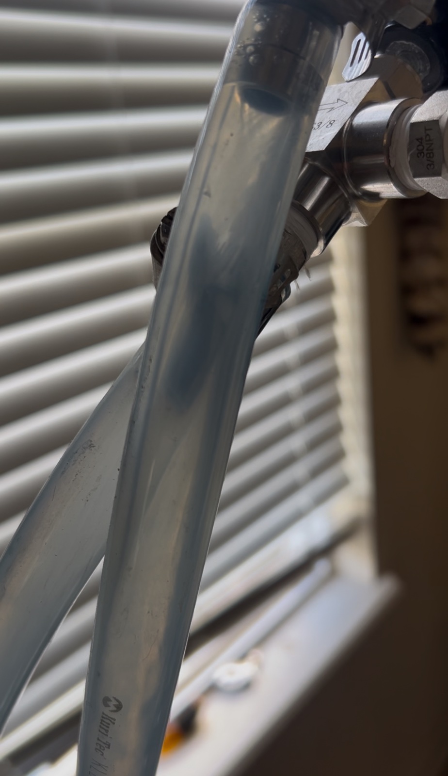

Another strange issue I forgot. My condenser seems to have vapor coming out of the end only when I'm using plates and the dephlegmator. I can strip like hell with a huge power input and it doesn't do that in pot mode.
The condenser is icy cold to the touch, and the distillate is cold. What the hell? It wasn't huffing.

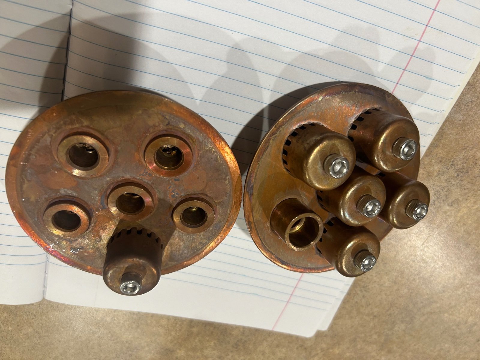

Could you post some photos of your deflagfiery creations wrote: ↑Thu Apr 03, 2025 5:46 pm My cooling water is super cold with a huge reservoir. I don't know why it seems like it can't knock down 2200 watts
I think it could be an issue with dwell time

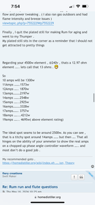

I know it’s probably not exact, but it’s from the chart you made for me with my elements.

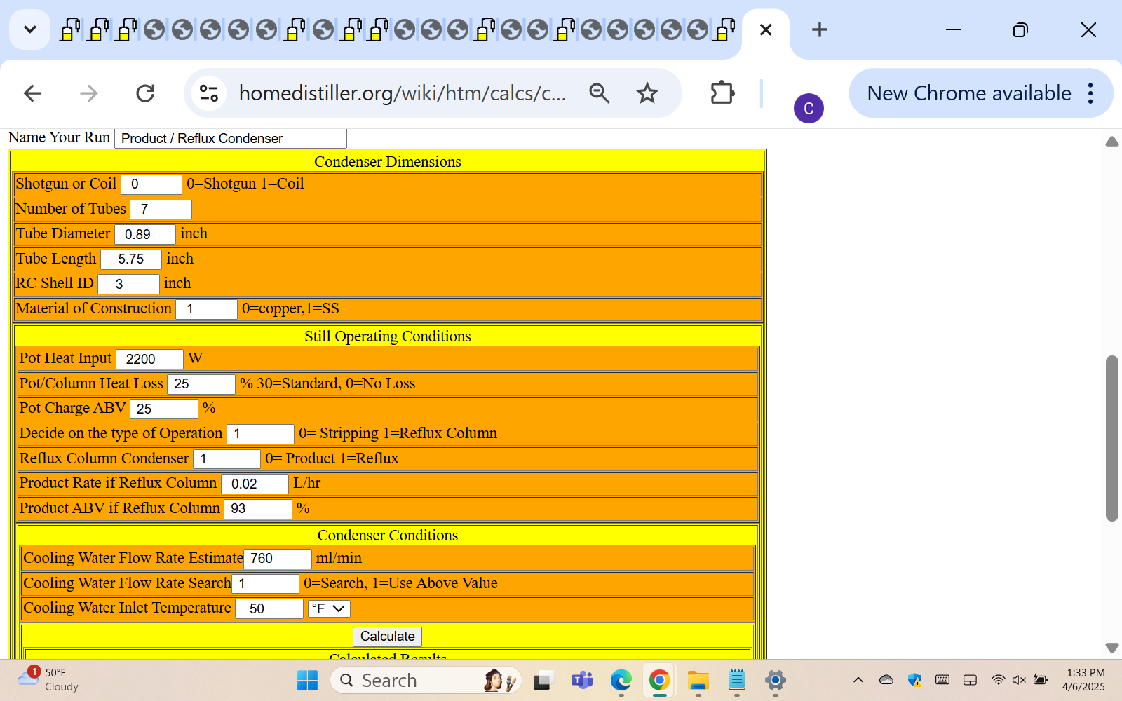

What would explain your plater performance is if you had unknowingly been running 13 amps in both of your heating elements . That would likely deliver 4400 watts instead of the 2200 watts you thought was running.
For 4" regular bubble caps, that 4400 watts would lead to or be near flooding and certainly have much entrainment and smearing of tails up the column. The following post by bluefish ( and by some others ) shows flooding of his 4" column with regular caps at 4000 watts.
If you would have taken run data on the deflag cooling water ( cw ) flow rate and temperature in and out, we could back out the reflux flow rate that is condensed. That would lead to knowing the approximate vapor flow up the column and the watts being used.
For instance, I used your deflag design specifications that I had once before, and for your recent SBB run, I calculated a deflag cw flow rate of about 3.6 L/min at 4400 watts to condense the reflux. And, if you were running 2200 watts, you would only need 0.6 L/min deflag cw flow rate. A very big difference in the cw flow rate.
I used 10C ( 50F) for the deflag cw flow inlet temp and got a cw exit temp of 21C ( 69.8F ) for the 4400 watts run and about 38C ( 100.4F ) for the deflag cw exit temp for the 2200 watts run.
Can you estimate how much deflag cw flow you were using, a little or a lot? Was the deflag cw exit temp cool or hot?
Next time you run, measure the deflag cw flow rate and cw temperature in and out of the deflag. Just catch the exit cw in a bucket for a few minutes and time it and weigh it and calc the L/min rate. Report that and we can calculate the amount of reflux condensed and get an idea of the watts being used.

Apologies, I know you were trying to help me through this before. I’ve been trying to access old post and some of your messages, but the site is really difficult right now. I think I measured my cw output and sent it to you in a message a while back if the site is working better for you. On the next run, I’ll try to measure again along with temperature.
I definitely wasn’t using 4400 W. I completely unplugged one of my elements after heat up.
Even at a half a turn on the needle valve it was still pretty low. This picture probably won’t help much but this is what it looks like coming out of the deph.

I think the issue is just that the defleg is undersized for what it needs to do. I had the same issue with my 3" of the same construction. At only 6" long, and made of stainless, it just cant handle the vapour speed of high power inputs. A lot of vapour just shoots right through the tubes without even starting to cool. I solved the issue by stacking another and running water to them in series.

OK, thanks for clearing that up, one heating element in use. Probably not high watts then causing excessive vapor up the plates. And the cw flow was low, not high, so not too much reflux flow. So, it is hard to imagine too much entrainment and smearing.
You think the deflag can be the problem. So let's look at this and confirm this is a CM column. I found an old calc I did of your still and deflag operation. The deflag design was 8 tubes of 0.5 inch diameter and 6 inches long in a 3" diam shell, stainless steel. I could not get the mile high web site picture of it. Are these the correct dimensions? And what is the cw inlet temperature? You said it was super cold, that might be why a low cw flow rate is used.
Not sure about your test scheme. What cw flow rate would you run? What is wide open? You do not want to exceed say 3600 watts. Wide open might be the problem.
We need to understand the deflag performance when you start up and equilibrate the column. Here is a start up method to try. For the above deflag design, and with a cw inlet of 15C ( 59 F ), set 2400 watts with a pot charge of about 20% abv and run about 1.4 liter/min cw flow rate just before it boils and then see if that condenses all the reflux. Increase the cw flow a little if all the vapor is not condensed. Hold there for 5-10 minutes, then lower the cw flow rate slowly until and after you get distillate flow. Then hold that cw flow steady when you get close to 1 Liter/hr distillate rate.
Maybe we should worry more about your super cold cw inlet temperature. Have you always run super cold cw in the past plater runs that were not good? If the super cold cw cools the reflux too low, then the cold reflux draining down would cool the plates and affect the column performance. A good target to shoot for is having the cw exit temperature about 130 F. Any idea what your cw exit temp has been?
You said:
Maybe that full blast is a problem that you start with initially and do not recover from, the plates might have gotten too cold from the initial reflux. Does anyone have experience with this? How about tempering the cw to 15C ( 59F ) and not running full blast and see what that does.
Last thing, I ran my HD condenser calculator on your SBB, 2200 watt, 1 L/hr distillate rate run above, but I do not have the actual cw flow rate and temps, so IF the deflag design is as I stated above and IF the cw is 10C inlet and IF you ran 1 Liter/min cw flow, you could cool the reflux down to 90F vs 160-170F desired. That could affect the column performance. If you ran about 0.8 Liter/min cw, the reflux would not be too cold. But If the cw inlet is 5C (41F), a 0.8 Liter/min cw flow might get the reflux too cold.
So, I think you should not do a dephlag cw full blast startup anymore with super cold cw. Try the above startup method and let's see what happens. And measure the cw flow rate and in and out temperatures during this time of learning the best still operation. Also, do you have any temperature measurements along the column?
You do not like numbers, but at this stage of learning how to best run your column, we need numbers to understand what is happening and figure out what is wrong.
A lot of questions here, I hope you can answer most/all of them. I will do some more plate column and deflag condenser calcs and report back when you confirm the deflag design and some cw information.

Here are the measurements I got from my deph-7 tubes, .890" diamter, 5.75" long.haggy wrote: ↑Sun Apr 06, 2025 2:45 am fiery,

fiery,
Thanks for the info. The larger tube diameter makes a difference - more surface area, more cooling. The cw flow rates and cw inlet temp look ok.
So here are the deflag condenser calcs for your 3000 watt case at TOTAL REFLUX. But I would not advise a 3000 watt run first. That looks almost doable at 1.2 LPM cw flow. The condenser watts ( 2132 ) are almost equal to the Heat Required watts ( 2246 ), They should be higher to cool it down a little.
But - there is a possible elephant in the room. I do not estimate the velocity of the vapor up the tube and assume the vapor does not bypass without seeing the tube walls. The 5.75 inch length may be a problem at higher pot watts and vapor flow.
So, here is a case at 2200 watts, the vapor flow and velocity is lower and probably not bypassing. Again TOTAL REFLUX and the cw for the run would be a little less than that. Your 0.76 LPM cw flow would just barely condense that, so a little more is best for total reflux. Then decrease the cw flow a little bit slowly to get the desired distillate rate ( 1 or 1.5 L/hr).
Of course, these are ball park ( infield ) estimates. Best I can do but they have worked elsewhere. One more, why not. The cw flow rate to give 1.5 L/hr distillate rate is 0.518 LPM via the search method in the calcs. So not a lot of wiggle room in cw flow rate.
haggy

If I'm understanding you correctly, somewhere around 2200 watts to run, and cw of 0.8LPM should be around enough for total reflux. Cut down the cw and end up somewhere between 0.518 LPM and 0.8, adjusting to getting 1-1.5 LPM distillate offtake.
ETA: Something still seems off. Why wouldn't my cw of 1.2 LPM handle the 2200 watts?? I started that whole last run at 2200 watts and full blast on the deph. It sounds like that should handle it
