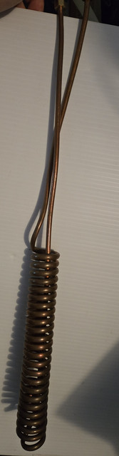

I'm using a 1 1/2" diameter RC coil that has about 10" worth of coil in a 2" column. It's taking a lot of water and, even at full flow, I have to have it lowered a couple inches past the T going to the shotgun PC when taking off product. When stabilizing the column, it's same flow, just a couple inches lower (maybe 4" past the takeoff). The PC uses very little water in comparison. It's a very nicely made RC, no kinks, made by someone here.

That condenser looks fit for purpose .
What power are you running ?
