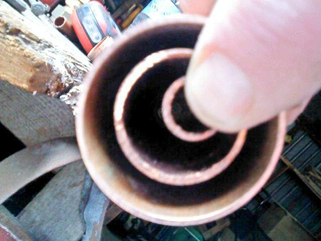

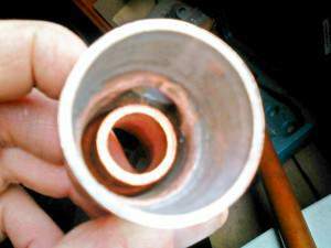

Hey all, been working on a reverse condensor. Its got 2 water inlets and 1 vapor path, 1/2' inside water, 1' vapor path, 1.5' outside water jacket. Had trouble working out the spot at the bottom where the vapor exits so i didnt get smearing, i reversed a reducer and filled with solder to add to flow, kind of hard to explain!. Thanks to all for advice and have learnt so so much since coming here, endless knolegde!!. Hope you like. Any feedback would be great. Will finish it tomorrow and do a test run.

What's the reason for such a complicated build?

Its not that complicated, its just a standard liebig in reverse with a outer jacket. Dont like?.

Just looks like a lot of extra work. Didn't say I didn't like it.

I guess i built it to try different things incase it works alot better than a standard one. That is how the wolrd evolves.
