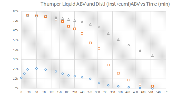

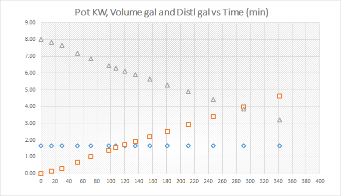

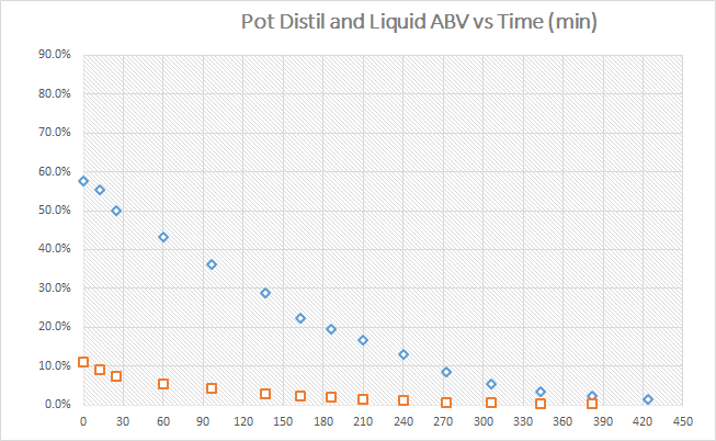

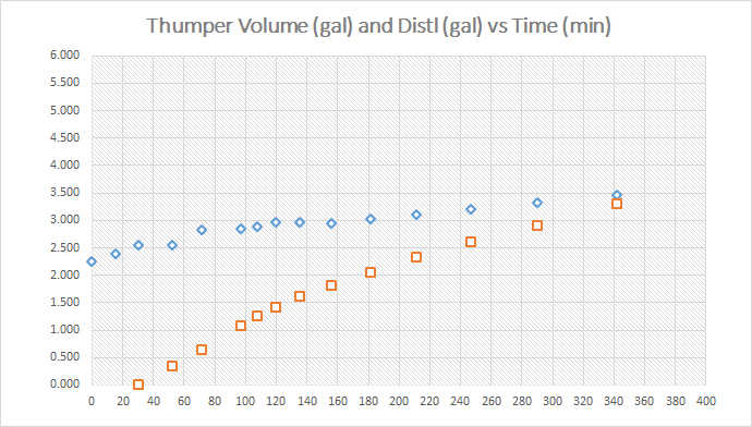

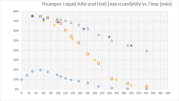

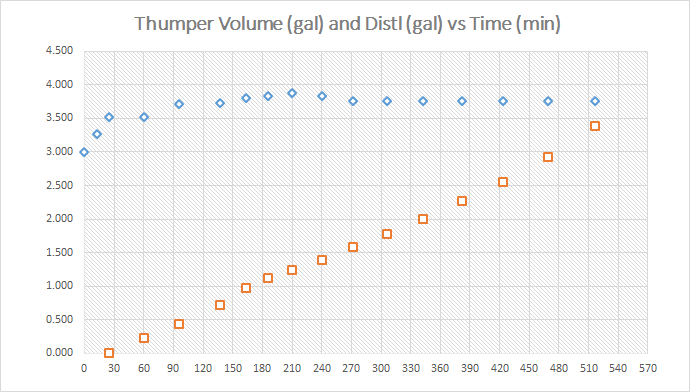

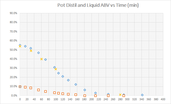

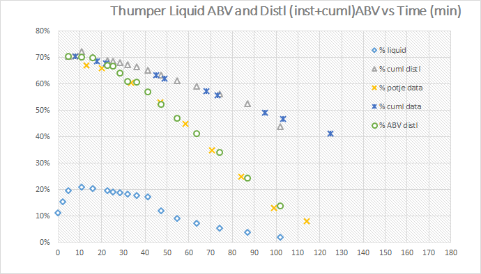

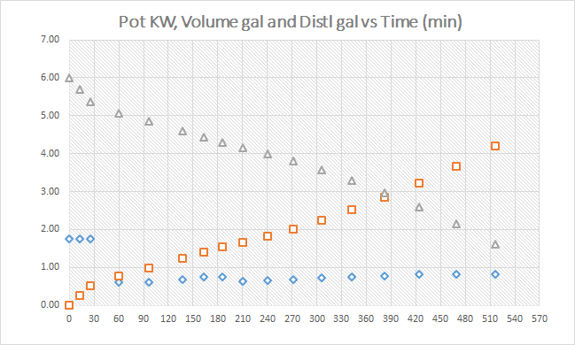

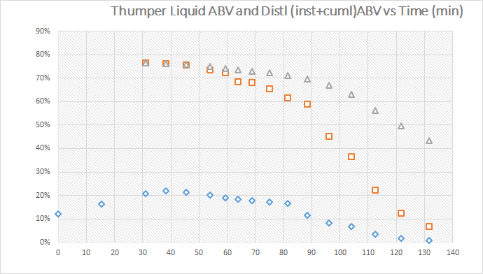

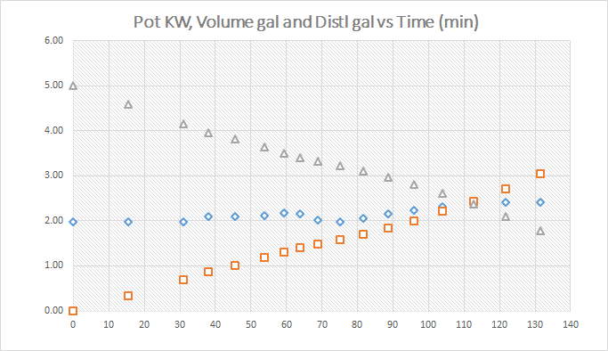

I better give some results.
Input data: Pot 6 gal at 11%ABV mash Thumper 3gal at 11%ABV mash
See the figures. Do not have labels on the graphs - See the top heading and figure out the symbols. Hope the graphs show.

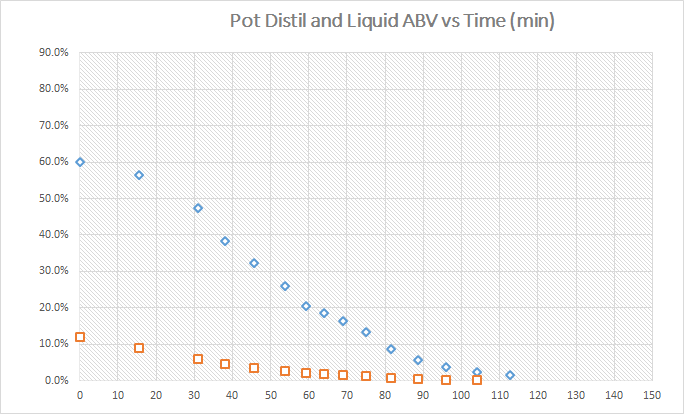

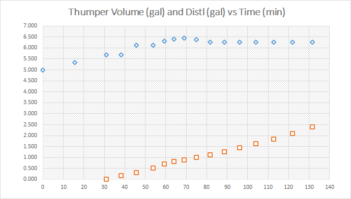

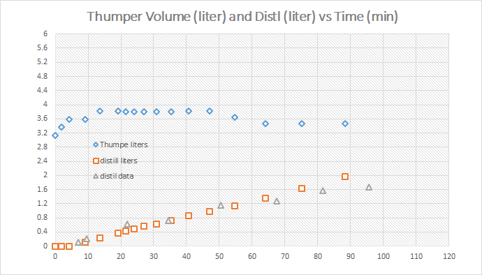

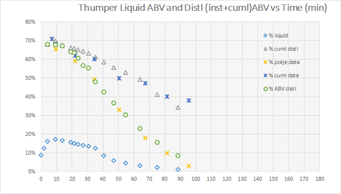

Kareltje,
You posted your model result on July 2017 in the "What does a Thumper Actually Do" Forum. Maybe you have changed it since then but this is something we can compare results on.
Starting conditions were Pot: 5 ltr at 12% ABV Thumper : 5 ltr at 12% ABV
I ran my model on those same conditions ( sorry, I used gallons instead of liters). I tried to make my time steps so that 6 minutes equal one of your time steps. There is a 30 minute thumper heatup time.
Attached are my results. You can compare yours with them. I get a higher %ABV vapor out early and it stays higher for a while. Also the thumper fills up some with mostly water and the alcohol in the liquid is almost gone at the 120 minute time. Vapor rates from the pot and thumper are in close agreement.

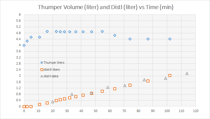

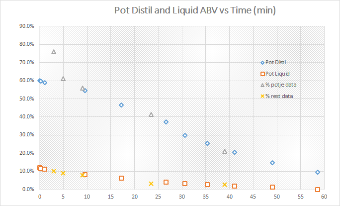

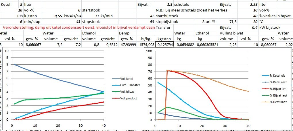

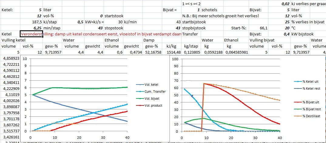

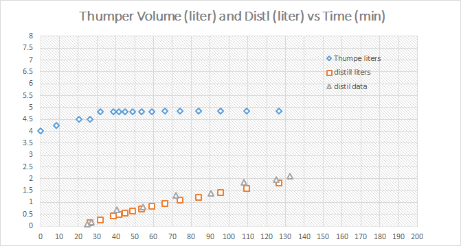

I made another run with more or less the same conditions.
Did not compare our results, for that is difficult switching from screen to screen, but tomorrow I can print your graphs and compare them with mine.
The left one is about volumes, the right one about %ABV.
Glossary:
ketel = boiler
bijvat = thumper
product = product
ketel uit = leaving boiler
ketel rest = staying in boiler
Destillaat = product (cumulative)
The head is a kind of switchboard, where several variables can be chosen.

I made the model because I could not see what happened inside and what went on between boiler and thumper.
Now, like haggy said, I use the model to warn against the emptying of the boiler or the puking of the thumper.
@haggy: Ah, now I understand why you had the wattage as a result of your calculations. I set the wattage as a parameter.
So your model on some parts at least works reverse compared with mine. Interesting!

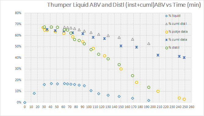

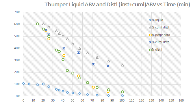

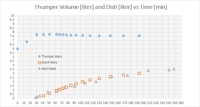

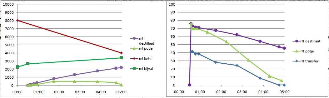

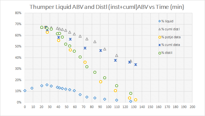

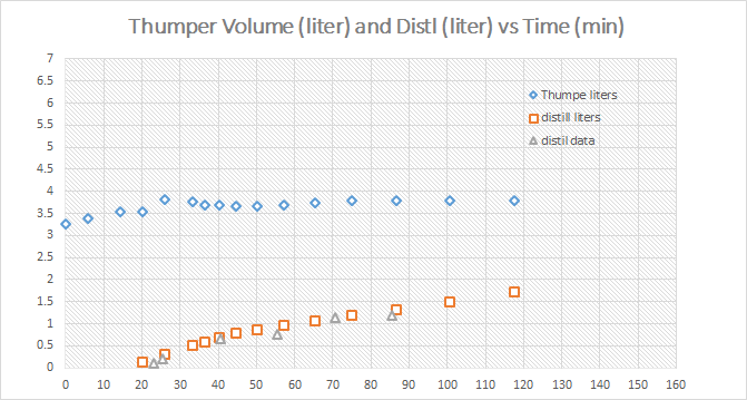

I took some data from a run in april 2019.
8 liter of 9,95 % in the boiler and 2 1/4 liter of the same in the thumper. Ran with 607.6 Watt on my stove. Boiler reached 90 dgr C at 14:30, first drops fell at 15:00, I stopped running at 19:30. Result was 2.186 liter of 45.5 %ABV, rest in the boiler was 4 liter, rest in the thumper was 3 3/8 liter.
This is the graph of the results:
I detemined the strength of the transferred vapour based on the temperature of the bridge between boiler and thumper.
Yesterday I tried to make the model fit as good as possible. Could not exactly make it right, but this was satisfying enough:

I should correct my last graphs.
In the graph of the real run the curve of the strength of the transfer should start a bit earlier and a bit higher. Forgot to correct the range of data. :( :oops:
And when I set the number of trays for the thumper to 1, the red curve of product is more like the real curve, it only starts about 10 %ABV lower.

Found some runs with thumper and different loads.
Can I upload a excel-file here? Let us try.
Model bijvat-vergelijk.xls
(330 KiB) Downloaded 145 times
It seems to have worked.
Note: we use a comma as separator between units and tenths, I do not know if that is automatically corrected.

Some runs with thumper (dreunvat) and some with pot still (ketel) only.
Nice to have the kW and time data.
What is potje?
Is the % transfer ABV based on a temperature calculation? This may not be accurate at less than 30% ABV?

These three runs are with both boiler (ketel) and thumper (bijvat). (Like bijkeuken (second kitchen), bijvrouw (second wife) etc. ;) )
Potje is little jar. I use smaller ones (1, 2, 3...) of 100 to 200 ml and larger ones (I, II, III, IV ....) up to 500 ml.
The Greek theta is for thermometer and these are a bit off: some show 2 dgr C too low, some 2 dgr C too high. Just for getting an idea of how far the process has gone. I measure the %ABV in the pot with an alcoholmeter, but not always at the right temperature! And it is of course the percentage of the total amount collected in that jar. The %ABV of the transfer from boiler to thumper I can not measure, alas. I tried to calculate this from the temperature, but then I first have to correct the reading and then calculate the %. Two very uncertain steps.
Oh, I named my kettles, so I know which ones I used. Kees, Koop and Kock are 10 L, Kolos is 15 L.
I start the run full throttle, that is about 2,3 kW. At the mentioned time I switch to lower wattage.
When you can use these data, I can send some more.

I have the first four cases done. Took a while to figure out your spreadsheet and transfer the data to mine. For each case, I had to find the power (watts) setting to give a run time where about 5% was left in the product distillate. Power is input data.
First Run 5/14/2017
This run had 4 liters of 12% ABV in the pot but an empty thumper to start, something different. Of course there will be bypassing (blow by) of the pot vapor through the thumper, but how much. I spent a while adding bypassing and an empty thumper to the model. But then saw that the final distillate was about the same amount and ABV of the vapor from the pot. So, maybe100% bypass, not enough condensing on the walls to get full vapor/liquid contact. The first 76% ABV result may be a hot sample error or may be some contact on the walls. Power setting was 620 watts after an initial 2 kW for heatup. At 42 minutes, the pot produced 1 liter vapor, just above the amount collected. Here are results: Pot conditions vs product data. Good agreement, confirms we have a good model for the pot.
Second run. ( same day)
This run had 4 liters in the pot and 4 liters in the thumper, both with 11.2% ABV. Run took about 125 minutes and the power to give this was 620 watts, just like above first run. Model results are in very good agreement with the data. Next are the thumper results for this run. The amount of distillate made is also in good agreement.
Third run. 7/30/2017
This run had 4 liters in the pot and 3.125 liter in the thumper, both with 8.9% ABV charge. Run time was about 95 minutes and the power set to the model for this run time was 750 watts. It would be best to know the actual power used - but this was not available. Model results agreed with the data.
Fourth run ( same day )
This run starting conditions were very similar to the third run. This time 800 watts were set. Similar results.
I will check the other runs next. Tell me if I have misinterpreted the run data . Next run has 6 liter water in the thumper. Wow.

I figured the sheet out and was glad to see all the data and calculations. I used the Google language translator.
Only problem was I had to move all the graphs. It is great data with a variety of runs conditions.
The next set of runs has the pot remains data, I can use that to help get the kW input for the run.
The % transfer ABV data ( from the temperature ) seems to be too high at less than 35% ABV. I will not include those points.

The rest of the runs in Kareltje's data set includes data on the remaining Pot volume at the end time of the run. This data and the time to get to 5% ABV of the distillate will be used to determine the kW for each run. The kW is input data.
Runs 5 and 6 8/25/2017
These runs had similar initial conditions, pot at 8l liter and 21.5% ABV and the thumper with 6 liters of water, 0% ABV. Much different than the other runs. Run 6 had a higher initial burn rate it seems since the thumper start time was lower. The power input that fit the runs was 710 watts and 680 watts.
The initial thumper distillate ABV of the data was 67% and 55%, I suspect the 55% of Run 6 may be too low. The model had 67.5% initially for a while but tracked the ABV down very well below 60%. Also, the model closely predicted the distillate rate and thumper ending volume and pot ending volume. Cumulative ABV was higher in the model. But in Run 6, the low start ABV data could be wrong giving low cumulative.
So the model can work ok starting with only water in the thumper.

I continue to post the results of comparing my pot/thumper model with the good run data from Kareltje.
The next two runs are in this post. Run 7 was conventional with alcohol in both the pot and thumper to start. Run 8 was a good test of the model, it was a steam stripping run with only water in the pot creating steam to heatup and boil over the thumper contents. This is useful if solids are in the mash. The thumper is not externally heated and should not scorch the solids.
Run 7 9/29/2017
This run had the pot start at 5 liters and 5.6 %ABV with 740 watt power input. The thumper started at 4 liters and 10.7% ABV. About 2.1 liters of product were made and the thumper ended up with 4.75 liters. The model predicted these values closely. The %ABV made along the run and cumulative %ABV tracked the data.
Run 8 9/27/2017
This was a steam stripping run. The pot started with 5 liters of WATER, the thumper had 3.25 liter of 10.7% ABV. The run only went for 86 minutes and 740 watts were estimated to fire the pot. The model had comparable results with the data so it can be used for this type of application.
CAUTION: In all these runs, the estimated power (watts ) may be different than the actual watts used.
If the actual power is different, the %ABV and the volume of product from the model would be somewhat greater than or less than the data. The end time of the run was used to find the input power. That also was the time where the model gave a low (5%) ABV of the product. Runs with actual power data need to be examined, but we are close with this good data.

I have examined all 12 of Kareltje runs and will report the next four run results soon. Some interesting options were run in the last four cases. My pot/thumper model did well.
Some observations I see from running the model using the Kareltje data are reported here.
A steady pot power applied over the time of a run should equal the amount of pot material boiled off times the average latent heat of vaporization (it increases during a run since water latent heat is much greater than alcohol latent heat) of the alcohol/water mixture. An equation that says this is:
Watts * Time (min) = Pot gal boiled off * Density lb/gal * BTU/lb * 0.293 watts/(btu/hr) * 60 min/hr
So, if we know the starting pot gal, %ABV and if steady power is applied, we can specify a % of the pot boiled off and find the run time. Likewise knowing run time, we can estimate the power used.
The pot/thumper model was used to find the average latent heat for several runs and then that was correlated to the starting ABV. It is to be used for about 5% to 30% alcohol in the pot. It is not for water only, use 945 Btu/lb there. So to find the steady power in watts from the pot run time data, divide the above equation by the run time:
Watts = Pot gal * % Boiloff / Run time min * 8.1 lb/gal * ( 860-680 * %ABV ) * 0.293 *60 min/hr
For example, see run 7 form above posts. Pot 1.32 gal at 5.6% ABV and 60% of pot was boiled over. Run time was 125 minutes.
Watts = 1.32 * 0.6 / 125 * 8.1 * ( 860-680 * .056) * .293 *60 = 742 watts
So 740 watts was input data to the model for run 7. The accuracy here is about +-7%, depends on the accuracy of the average latent heat estimate.
However,
for most home distiller runs, you start with setting a power input, so run time can be estimated from:
Run time (min) = Pot gal * % Boiloff / watts * 8.1 lb/gal * ( 860-680 * %ABV ) * 0.293 *60 min/hr
A typical run for a home distiller might be this: Pot 6 gal,12% ABV , Thumper 4 gal at 12% ABV, and 65% pot gal boiled over with 2000 watts power input. The end run time estimate to get to <15% ABV final distillate is:
Run time (min) = 6 gal * .65 / 2000 watts * 8.1 * (860-680* 0.12 ) *.293 * 60 = 216 min
The pot boiloff amount can range from 50% to 80% depending on the pot and thumper charges. The 65% figure is an estimate for runs with pot charge less than 10 gal, with thumper charge less than the pot, and both have ABV charge less than 13% . The final distillate at 216 minutes run time should be less than 15% ABV.
If more alcohol (gal and %ABV) is charged to the pot or thumper, the % pot boiloff and run time will need to be longer to get to <15% final ABV. Putting 80% boiloff into the equation should give you a safe maximum run time provided the watts used are constant and correct.
The pot/thumper model has pot power as input data and we see the expected distillate results at all run times. The accuracy in run time and %ABV results should be good. The run time to get to 40% ABV distillate, where the tails might start, can be determined from the model.
Of course; smelling, tasting and measuring during a run is always done and is best. The concepts above and the pot/thumper model can be used before a run is made to know what you might expect and when.
Feedback and data on these observations are welcome.
