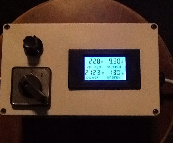

Controller bling time!
I installed a SPDT switch so that I could bypass the controller (1), kill the power (0)) or (2) use the SSVR to control the rate of boiling
I also installed a multi-parameter meter
Set to bypass controller

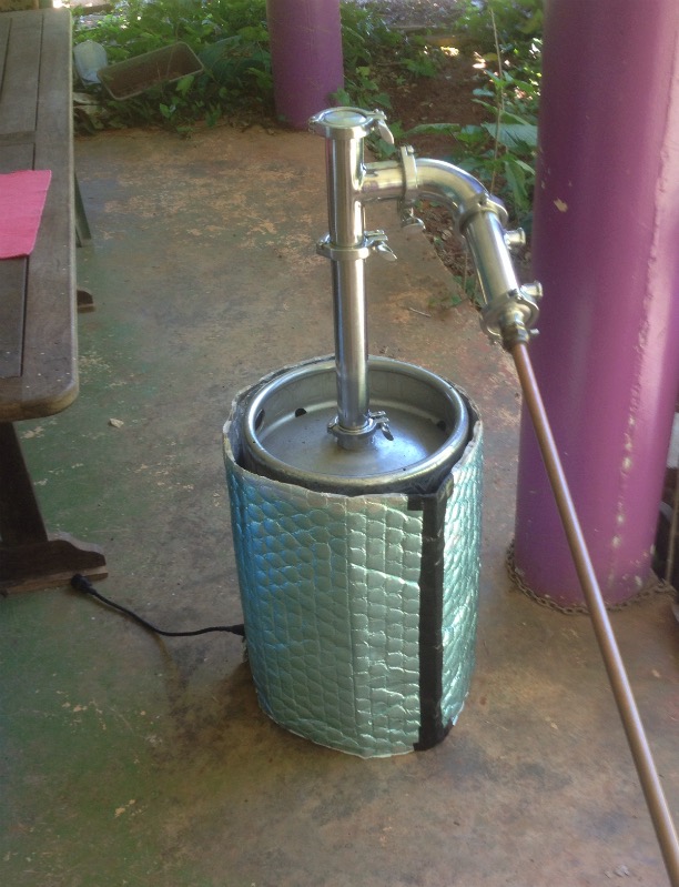

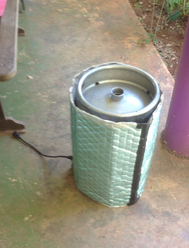

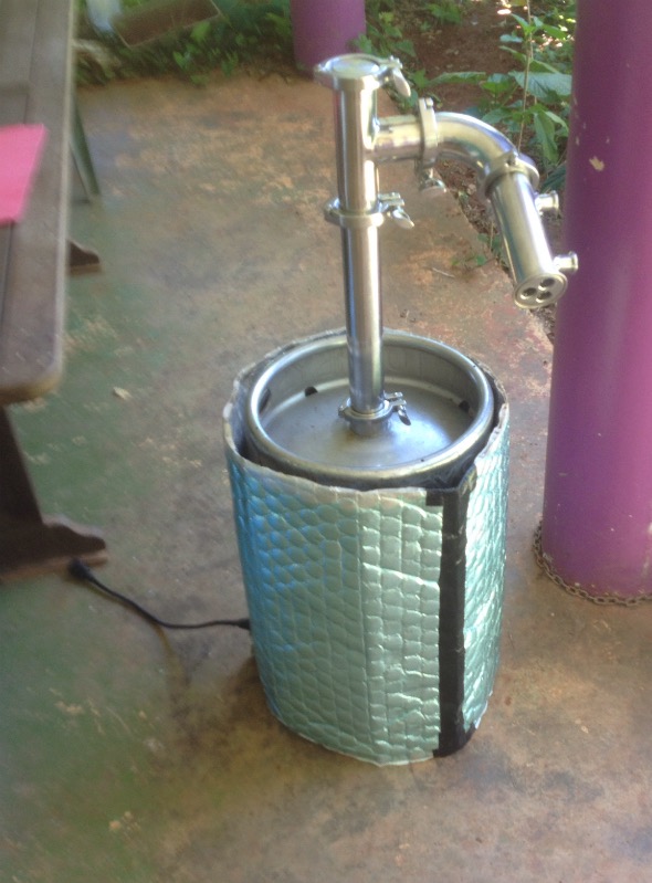

Photo essay - assembling the modular 2" pot still
Boiler insulation made from roofing insulation
305mm SS spool for riser
SS tee section with cap
SS elbow and Still Dragon Big Baby shotgun condenser (PC)
Output tube (3/4" copper pipe)
to be continued next post...
50 litre beer keg boiler with 2200W electric elementBoiler insulation made from roofing insulation

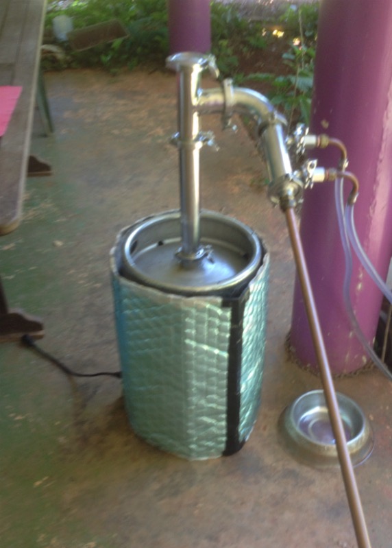

Photo essay continued
Coolant lines attached (uses 3/4" triclamps
Power controller connected up
Thanks for indulging me, I do get a few queries/ comments about the modular style of still construction.
