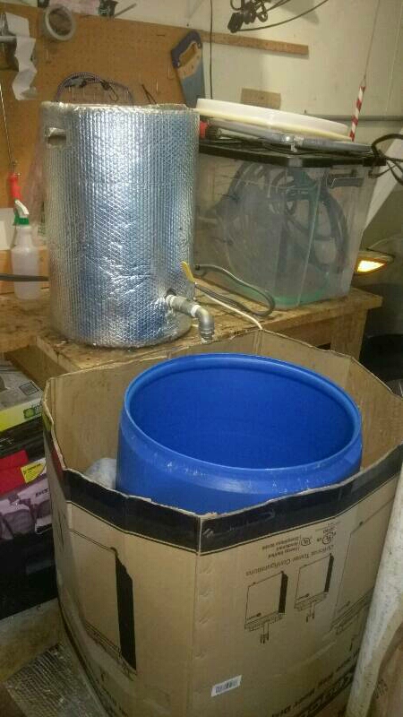

Ok, so here's my set up. My work bench is the perfect size to line the drain over my mash barrel.

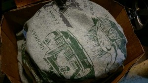

The barrel is ready to go, and is all wrapped up with blankets.
Fill the boiler with 12 to 13 gallons, I use a hose. This is 1/3 of the total water.
Turn your boiler on, and wait till it hits 212. My thermometer fits right over the 2" opening, and really gets to rattling when is ready. When it does, open the drain and dump into masher/ fermenter.

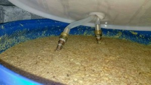

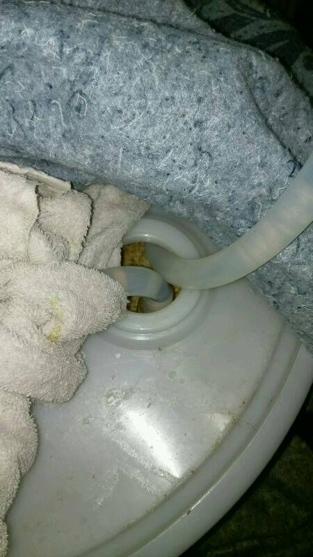

Then, wrap it up tight, and let that cook while you fill the boiler again. The process starts over, and each time you add 1/3 your boiling water to 1/3 your grains to cook.

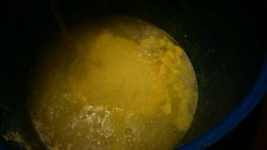

You will notice that every time you open the lid to add the next batch, the corn looks like this.
And that temp is just over 180.
I do this process while watching cartoons with the kids on Saturday morning. Takes 5 minutes, 3 times, over the course of a few hours. I just finished my 3rd and last addition, so for the next 18 to 24 hours, I have nothing to do. I may go out there a couple times and give it a stir and take a temp reading. Probably in the morning, it will hit 150, and I add my malts. It will mash all day, and (hopefully, lol) I well pitch my yeast before bed on Sunday.
48 hour mash, no more than 30 minutes of work.
I hope this helps someone get a good idea about tackling large all grain ferments.

When I first saw the picture of the barrel in a carboard box, what the hell is he using carboard box for ? ? then the next gave me the answer.. good thinking..
Question.. how do you get the barrel out of the box.. pail the mash out into amount fermenter....

That is my fermenter. It comes out, into the still. The grains get scooped out and squeezed into another barrel a gallon at a time after fermentation. Then, I just rinse it out, and sanitize for the next one.StillerBoy wrote:Thanks SCD for the write up and pictures..

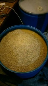

Thank you sir. It really is easy. I got up this morning, the corn was still 162. So I took the lid of to help it along.MichiganCornhusker wrote:40 gallons, 48 hour mash, no more than 30 minutes of work.
Now that's how to build up aging stock!
Very elegant procedure, SCD, makes it look so easy.

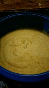

If there is any doubt that you get proper gelling this way here's a photo

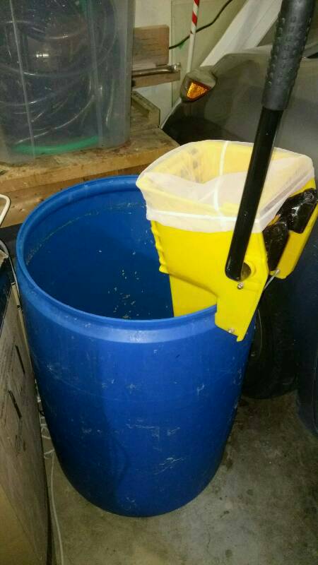

Also, I wanted to share this because this was a dummy coming to enlightenment moment for me.
I used to do this and empty when full...
When I should have been doing this. I squeeze the whole barrel in 1 hour.
Again, not an explosive new protocol here or anything, but it's these little things that make me go duh... I'm just trying to do things the hard way, aren't I?

I've moved up to mashing #50 lbs now since Winter. I have however been using sugar as a buffer (not trusting my conversion haha).
I use a freed up corner in the living room. I place my 50 gallon fermenter inside a sleeping bag and usually toss a comforter over and around the barrel for added insulation. The old lady likes the living room set at 70 degrees Fahrenheit so I'm able to ferment in the winter without too many issues.
Reused Corn from last batch draining off all liquids from the grains. Re-added inverted sugar aerated a bit and added yeast...it took right back off.
I'm excited for this current grain bill to be spent. I now have high and low temp enzymes 1 lb each and pectin enzyme 1lb. Going to really be breaking stuff down now. I figure each pound is about ten runs give or take. So 10 runs using H/L temp and 10 brandy runs using pectin. I got HL off Brewhaus and pectin off eBay. Liquid enzyme off eBay was more expensive after shipping costs unfortunately. And from my math possibly one less run...around 9 runs per bottle oposed to the 10 from powder . So I went with the lb of powder. Well see how it works out.
*when I say a run. 1RUN=40-45 gallon mash
