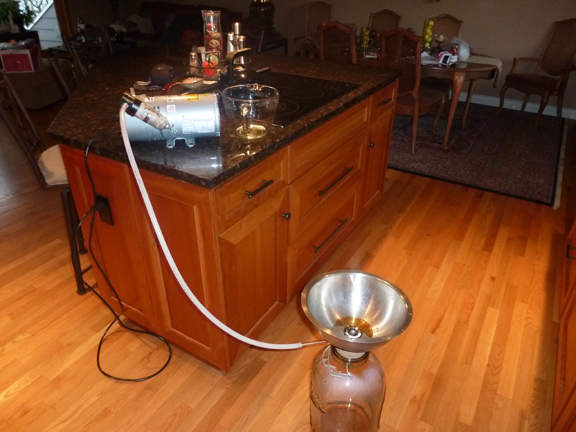

Update: Got the corks and assembled the system and tested with cold coffee to see how it would work. It actually was at least 4 times faster in filtering. I will post pictures and hopefully post a video later to show how it performed. But quickly I pulled it through so fast that it had very little time to make cold coffee, so this will work great for clearing liqueurs such as peach or raspberry. To make cold coffee I will probably have to let it sit in the grounds a bit longer before pulling it through, I did run it a second time and it helped but was still to light for drinking.
The first picture shows how I set it up using a vacuum pump. I made the funnel out of a Stainless Steel boat sink drilled a hole through the bottom and used a ss drain. The next picture I lifted the cork to show how it is assembled. I drilled two holes through the cork the first 1-1/4" to take the drain pipe, the other to the side is 3/8" to fit a 3/8" copper pipe that assembles to the vacuum. I put the coffee filter in a colander and put that in the sink to have more surface area to draw through!

Nice work. That's what I was thinking about doing. Just had different parts pictured in my head. That big ol jar is neat as hell. Man I like the setup. A lot simpler then what I was thinking. I like it a lot.
Got me thinkin different now.

Thanks I have two of them I bought off craigslist, the one in the picture is 4 gallons, I also have a 2 gallon one. I had to create a new email account so that it would not be as easy to trace what I am doing back through YouTube but the video should be up in the next 10-15 minutes.Prairiepiss wrote:Nice work. That's what I was thinking about doing. Just had different parts pictured in my head. That big ol jar is neat as hell. Man I like the setup. A lot simpler then what I was thinking. I like it a lot.Got me thinkin different now.

Please can you explain what it does and how to use it? I see a bottle, on to a cork. In the cork a funnel (with a filter in it?). In the cork also another hole with a pipe going to some kinda engine.
Does it work like this: motor sucks air out of the bottle, thus creating a (relative) vacuum. The vacuum sucks air through from the funnel, thus speeding up the filtration process? Please correct me where I go wrong.
Where are the benefits? Faster filtration? Even better filtration?
Odin.
Odin.

Sorry Odin, I did not get back to this thread. I make raspberry liqueur and filtering it can be a pain as coffee filters have a tendency to clog. The idea behind this is it will be faster and pull through the filter so it won't clog as fast. And yes it works just like you said, the motor is a vacuum pump and I hooked it to a 3/8" copper pipe, I put the filter in a colendar to pull evenly and not suck it through the funnel.Odin wrote:BM,
Odin.

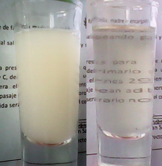

Thought about making a thread but figured since there isn't much to it this might be a good thread.
I have been playing around with plain printer paper for filtering. I take a sheet of plain printer/office paper, cut a square and fold it so that I have a triangle that fits in a funnel. It is real slow but the results are nice so I fugured that Bushman's vacuum filter might make it worth while. Maybe some other type of readily available paper might work better.
Uncleared wash on the left and filtered on the right.
