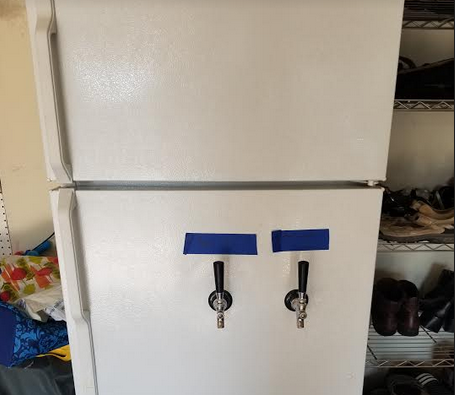

Wait, you want to ferment something that tastes good to drink directly without distilling?rubberduck71 wrote: ↑Sun Jul 04, 2021 5:53 am Sorry, I may have confused you with my post: cloudy FERMENTATION that has a significant tendency to stall, even with a sock full of oyster shells. I'm trying to make hard seltzer (more for the SWIMBO than me...). I also make hard cider & keg them up in the garage fridge.
I've done 3 attempts with dextrose, all w/ ~1.040 - 1.050 SG (high ABV for seltzer is not the goal). So either dextrose is a fickle beast, or I'm doing something wrong. That said, I have PLENTY of white sugar washes that worked just fine with DAP, DADY, & shells under my belt. So was pondering this recipe as a viable alternative.
Thanks for your insights!
Duck
I think most companies that make hard seltzer start with non-alcoholic seltzer and then basically add neutral spirit to it to make it hard. They don't serve the fermented wash. I've had some clean sugar ferments, but all of them end up pretty acidic and hard to drink.
If you're trying to drink the wash, I think you'll have a hard time making something that's pleasant to drink because you need to add extra nutrients to the wash to keep the yeast happy aside from just sugar and all of those nutrients do have a flavor that isn't necessarily pleasant.
Beer is such a miracle because the extra stuff that makes the yeast happy also tastes good to us.

Correct! Drinking the wash. Not too much different (process-wise) than the hard cider I've been making from store bought juice.MtRainier wrote: ↑Sun Jul 04, 2021 12:07 pm Wait, you want to ferment something that tastes good to drink directly without distilling?
Beer is such a miracle because the extra stuff that makes the yeast happy also tastes good to us.![]()
There's a lot of seltzers out there that are sold in beer distributors where I live. *** Have pity on me -- I live in Pennsylvania, so liquor is sold in State stores. *** So point here is if it's sold in beer stores, it's not NGS-based. Must be sugar or malt based. For those of you of a certain age - remember malt coolers???
But point taken that it's a difficult path!
Keep the suggestions coming folks.
Thanks!!!
Duck
