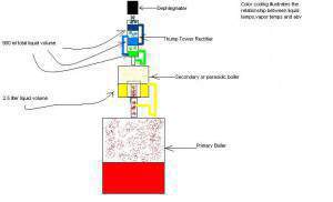

Here is another illustration that I often think about with regard to how this system works.....Hope it doesn't seem to odd.....
I'll start by saying that I'm not so sure that breaking hydrogen bonds to the enth degree is needed for our purposes.
Think how a painter might clean his brush..
The brush gets dipped and agitated into a solvent that gets dirty very quickly. The solvent gets dirty and the brush is not entirely clean. Perhaps some of the solids may have been reintroduced back to the brush during agitation?
So then the brush gets dipped and agitated into a new bucket of clean solvent..More solids drop out of the brush.The bucket become less soiled than the previous bucket and the bush becomes that much more clean. And perhaps some solids get reintroduced during agitation?
Then the brush gets dipped into a third bucket of solvent. The third bucket acquires a slight cloudy appearance and the brush appears to be generally clean. Perhaps a small amount of solids got reintroduced during agitation?
So in order to make sure our brush is good and clean we dip and agitate in one final bucket of clean solvent.
As a painter knows, often times the best solvent to use for cleaning the solids out of one's brush,,,, is the very solvent that is in one's paint.....Ethanol is a solvent BTW.
Seems a bit simplistic I know?...I can't do the math,,,but I know how to clean a brush with solvent.

That is a great analogy and certainly held up by the action of packing, plates and thumpers. If a high concentration of "solvent" is effective in screening subsequent volatile mixes, I would assume that the goals we are striving for would make the use of staggered high ABV filter systems---whichever is most effective or a series of mixed methods that are synergistic---the best solution. Being able to control them interdependently allows us to influence ABV, flavor, etc. But the "wildcards" are thermodynamics, pressure, vapor flow and so forth, right? Much like multi-column distillation practices, we need to figure out the best hardware to fuel to mix methods and play them like virtuosos during our runs. Segmentations of some sort, and using different components that aid each others' efforts in the right sequence seems paramount to solving some of these small scale attempts. I see packed thumper and inline condensers, reboilers & packing/plate combinations being the solution...but in what positions/sizes and at what temps/reflux rate the mystery.
I'm a bit unclear as to what bubbling is doing to aid the process...does it aid in separation due to the added volatility of the wash? If so, wouldn't we want a series of very volatile bubbling segments (bubble plates or "chambers"?) in series with thumpers?

flyingdutchman wrote:Maybe first thing is to look at your design again and figure exatly how many plates that should add up to.
4 plates not including the boiler or dephlegmater.
the liquid volume in the largest thumper is actually 7 liters not 2.5

Ok...now THAT looks like what my gut is telling me! I AM NOT AN IDIOT! YAAAAY!
Ahem...sorry.

Frosteecat wrote:Ok...now THAT looks like what my gut is telling me! I AM NOT AN IDIOT! YAAAAY!
Ahem...sorry.
So much of what you have been thinking is similarly contained within this concept. I didn't realize you had not seen what you have been thinking.

No I had not...this was just what my intuition was telling me. Of course I'd want to add mechanical bubblers, pinwheels and centirfuges too... :ebiggrin: ... but the "straight shot, simple plate or packing" clan was pissing me off cause my mind kept saying "no no no you need combos and rest stops and multiple effect areas with traps" etc.
It's a nice validation but I think you can do more and better.

The dynamic boost happens when the top plate starts drain feeding the middle plate,,, as the middle plate continues to feed vapor into the top plate....
Once all three chambers are cycling and no product is collected,,,the most volitile material must occupy the highest space. When that space is exhausted, the highest voilitiles have no choice but to escape as liquid and drain down to enrich the next lower plate level. This continues until the entire tower section is stacked with very proofy liquid....
This deep body of very proofy liquid allows for a very fast collection speed. Not at all like maintaining yer collection cup in a Bok. At this point not much heat input is needed at all to drive the system as the boiler temps naturally rise.
Never really felt smart enough to try and mitigate any entrainment issues......This is after all my rum maker and I like the way I been smearing it up :lol:
I pull heads old school before I put her into the big reflux cycle.

Hi LWTC,
Hands down no questions asked, I have to say that is a very original design. I looks like you have a huge area for vapor to interact with liquid and I bet it can piss like a race horse when you out the spurs to it. I suspect trying to calculate the number of theoretical plates you are getting would be a whole lot easier (and more accurate) with the dephleg completely bypassed (ie no refluxing). It looks like 5 condenstaion cycles (including the primary boiler) if the dephleg is bypassed. Have you ever run it with the dephleg bypassed. if you did how many theoretical plates would account for the purity you are getting in the parrot vs starting wash % alcohol.

No Dephleg is 87% and that would be with a water precharge at each plate to insure that phase change is initiated at every plate level.

Maybe a dumb question but why wouldn't you have the option built in to return all of your distillate at various stages to all of the lower chambers in any sequence or at any time (accounting for flooding,etc of course)? Wouldn't you boost ABV by returning "tops" to the bottom or "upper bottom" as desired?

Frost,
Good idea, and it kind of goes along the lines of Myles current thread on reflux splitting.
LWTC,
Mike Nixon wrote a paper where he talks about a Vapor Reflux System. In it he advocates returning the reflux to essentially what is your parasitic/secondary boiler. Probably you guys already know all about this and maybe its already been talked about in Myles thread i really need to check that one out.
In a way judging from your drawing i wonder if you are sort of indirectly doing this already. I mean you havent directly routed your reflux to the seconday boiler BUT by the nature of what to me looks like an overflow pipng system (to prevent flooding?) I think you might be doing it indirectly.
PS
Under reflux I would have a hard time saying exactly how many plates you should be getting. Maybe Rad or PP has a formula to calculate this. However I believe the most accurate way of checking how many theoretical plates your are achieving strictly from your inline deep bed liquid plates is to run it with no reflux. see what ABV it comes off as, compare that to the ABV of the wash and use the interactive calculator on the parent site to tell you exactly how many "plates" you have achieved.

LWTC I am not so sure you have entrainment issues. I mean, I think entrainment to strongly related to vapor velocity. Velocity is related to column diameter but your case is kinda atypical. The vapor velocity at your "plates" (which I think is the important part) is related to Thumper diameter and not the diameter of the column connecting them. What is the diameter of your thumpers because if I remember right its like 4 inches minimum which means it has four times the volume of a 2 inch column and that would be a whole lot less vapor velocity than a 2 inch column. Atleast thats what I think??? :crazy:

I started running this rig before Mr. Nixon ,,(or Harry rather) posted that paper....I was observing things that seemed to be quite contradictory to what I was hearing from the very smart fellows...so I was very confused..How could all those very smart fellows be so off point in key areas?
When I read Mr. Nixon's paper I was inspired and at the same time things became much more clear to me as I had made observations that Mr. Nixon referenced.....Mr. Nixon does an excellent job with his narrative to keep a journeyman like me up to speed,,,I felt any way?
My input on the thread was dismissed and was told that my rig had nothing to do with
Mr. Nixon's "vapor reflux" concept.
But to me the concept is best illustrated on Mr. Nixon's paper when he discusses "Positive Feedback".
The notion of positive feed back is the hallmark of what I am doing.
Seems folk could not make the connection for a couple different reasons?...My inability to effectively explain the similarity of the concept to what I was doing ,,,,my equipment was clearly a different design and also when I use the word "thumper" it threw the folks off target,,,as every body knows that a "thumper" is pretty stone age technology....
You should read the Paper (and the thread). And think more specifically about "positive Feedback" after you read his paper...
