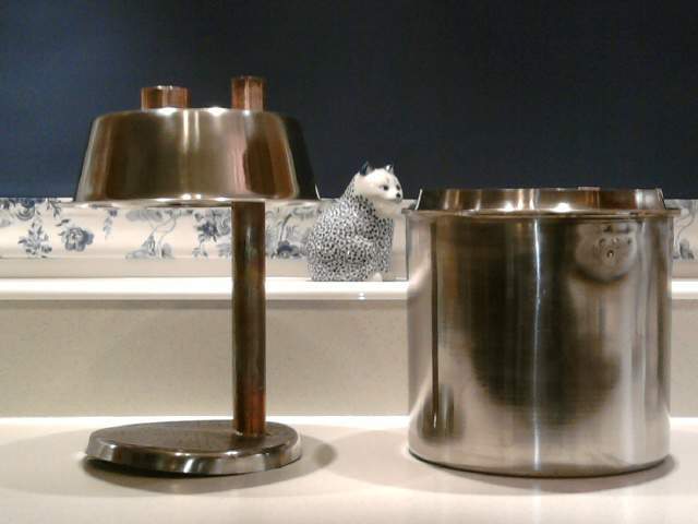

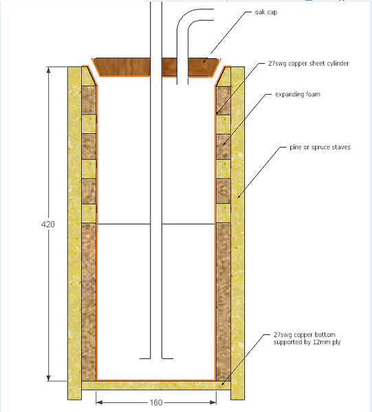

Oh well! A small keg is an easy option. If you can build a liebig then you can build the fitting that is needed to turn a keg into a simple thumper.
Or you can use a stock pot and a bowl for a lid - well 2 bowls actually. Solder the rim of the first bowl to the pot to make a seat for the second bowl to mate onto.
Or line a wood box with a thin copper liner.

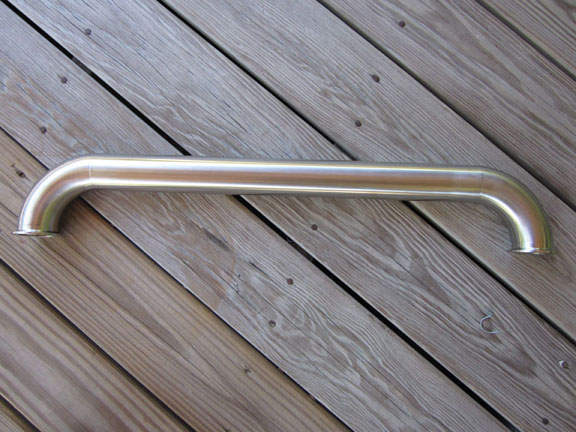

The single inline thumphead: This again..was mostly designed around logistics for connecting the existing lynearm and condenser to the thumper. And as that goes..it's a pretty efficient way to do it. But, lets look at or think about some of the conditions that exist with this design and what happens to vapor as it goes through the path from beginning to end. In this design, you bring your thumper line in...same size as the end of your lynearm. For most people that's going to be somewhere around 1/2". You use a larger tube "jacket" over that (1" or so) and tee it off to make an attachment point for your existing condenser (usually 1/2"). So the idea being...the tube from lynearm 1/2" volume goes down to the bottom of the pot...and the vapor comes out the 1/2" volume (1") tube as it rises up.
What's the problem with this? Heat and diameter. First we are limited to 1/2" on both sides. Second is..the heat passing from the vapor coming in..is also heating the output tube that surrounds it. This adds to the smearing already inherent in a design using small input/output tubes driving heat. Would you put a heater or heat source at the top of your potstill head where the vapor comes off to enter the lynearm? If you did..what would happen? There is a certain amount of smearing or blending that already occurs naturally using a thumper because of the liquid pool it goes through. But, after the vapor reaches boiling point in the pot...you want don't want it to "rush" out, nor do you want it to super heat just as it's trying to escape the output and go to your condenser.

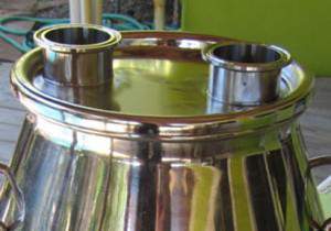

Usge,
Could you post a better pic of the connections at the thumper? And how big and how many holes for the diffuser?
Imitation is the finest form of flattery, isn't it?
Usge
Posts: 3243
Re: Thumper?
Post by Usge »
Both connections are 2" ferrules/tri-clamp.

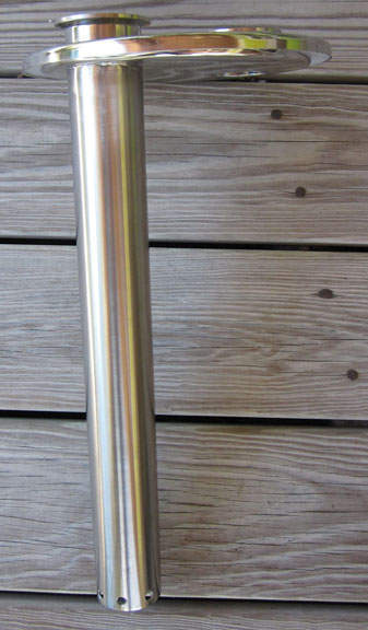

Here's a pick of the lid with downtube.
And a pick of the connector from thumper to keg
