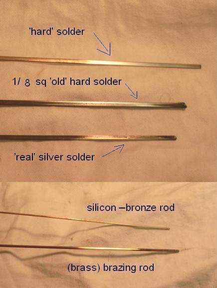

In the silver-rod.jpg, various types are shewn, and labeled. The first is typically what is mostly sold at industrial plumbing supply houses, (where I prefer to do business) its whitesh and its
got thin copper plating on it, 1/8thX1/16, & about 18" long. Shop around!! There are 3 industrial shops locally (one net based but I can order O/L and pick up at their warehouse) however, one of the locals was HALF the price of the others,over the counter, so look around.
The second, you might find, if you are lucky, same alloy as the first, but, 1/8" square and 3'long, one stick goes a long way! Its not plated and ends up looking ugly after a time, steel wool cleans it up nicely, and is whitesh under the crud.
Third is real $ilver solder, not plated, silver tarnishes badly, lots of stuff react with it. (ie NEVER put rubber bands around $ilver ware, unless you like to polish silver)( I think its sulpher compounds in the rubber) Steel wool fixes that. note the 'buttery' color.
Next is silicon-bronze rod shewn is 1/16" rod, also refered to as copper-bronze and even as silver-bronze, by some, its not silver. It is copper electroplated to keep clean. It looks like the real silver solder, buttery yellow. This is the really neat stuff. If you have a tig welder or someone who is tig welding your project together, you, or they can braze copper 2 copper, SS 2 SS, and this is the best trick, copper to SS.
Lastly, (brass) brazing rod is shewn as an example.

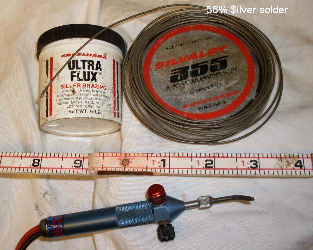

silsol+tor shows the flux I like and, a roll of 56% silver solder, (1/16" wire) and my li'l oxy acet torch which easily brazes 3/4" copper pipe with excellent heat control. The flux is water based, and has flourine and other wierd stuff in it, tastes vile. It is water base for application, and dries and melts, (like glass when youre done and it cools), impurities float off in this liquid.

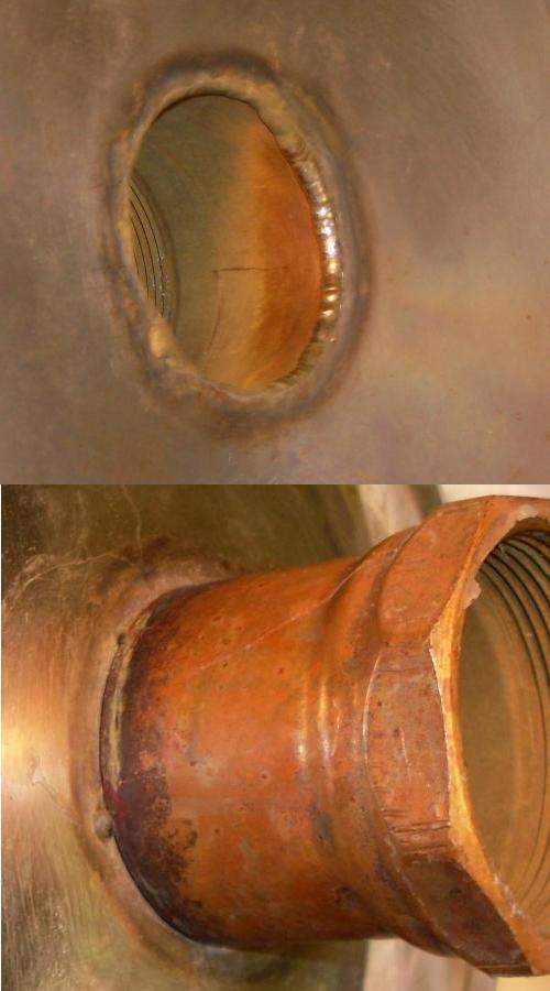

in'n'out.jpg shows a 2" F copper sweat fitting tig brazed with silicon-bronze rod to a SS pressure cooker lid, (MY 1st still) not much to see outside, but the action was done inside, it is relatively smooth, no nooks or crannys for sludge to get into. I steel wooled part of the copper to show the slight difference in appearance of copper and braze. The discoloration is from a LOT of mash going through this thing, 6 qts at a time.

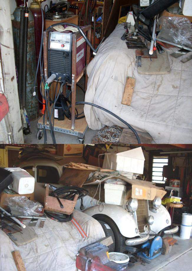

tig-t.jpg is my 'Thermal Arc 185' tig machine. Tig is the way to go!!
If you can gas weld (braze), you can pick up tig welding (brazing).
The biggest thing for me was learning NOT to lift the torch away when finishing a weld or lifting to control the heat. Its like learning to drive stick shift after 30 years of automatic transmissions. Plus you HAVE to get into a comfortable position to do a good job.
comes to mind This welder is an excellent ac-dc stick welder too.

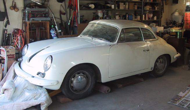

#1 Clean YOUR DAMN SHED UP!!
#2 I'm sorry to say it, cause i like your posts and look forward to your views, but unless you change that av, you are going on my ignore list. :(
Just not something i want to look at at 5 in the morning (when i spend most of my time here). :oops:

:mrgreen: One is a Mercedes, the other looks like a bed but closer inspection there may be a Porshe or a Karman Ghia in there somewhere.

My first guess was a '54 vette but on 2nd glance the headlight bulges look too far back. Ayay's speculation of a Karman Ghia looks right, I think I see a hint of the center ridge.

still off topic, definatly not a Ghia, looks like an early 911 to me or possibly a late MGB
this is my '64 C cabriolet
the 170 merz
-hey-
