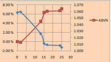

Here is a graph of what I am getting in a batch of 55 lt with the same recipe as you are using. I have found that I have to keep the temp much higher that Wino recomends. The later bumps in the curve are due to my experiments with modifying the Ph Level so just disregard this last part.
hope this helps
Regards Ubar
