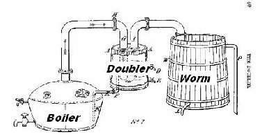

A pot still can also include a thumper or also called a doubler as it simulates a double distillation.
Here an example of a pot still with doubler:
Pot still with doubler

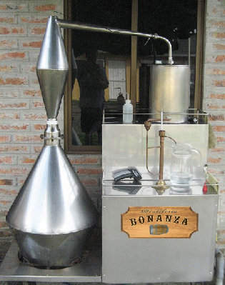

Here an example of a member’s setup, you see that it’s very easy to built, just missing the water container which can be a plastic pot or be made out of copper or SS.
pot still example

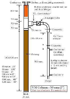

The VM is also an easy and cheap to built design and many members prefere it to a LM still.

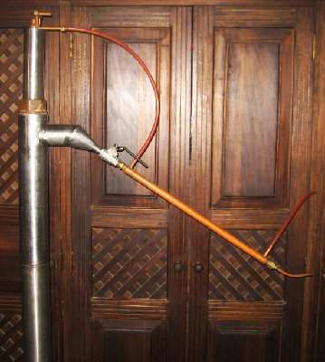

Here a bad example of a built of mine, mistake was the too small vapor valve (allthough easy to fix).
What stills better not to built:

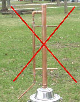

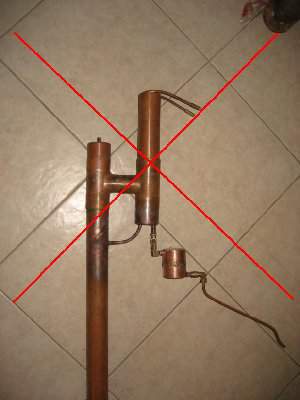

There are some stills in the parent site which sometimes are token as good examples (I thought so and spent money I could have used better) but these designs are overhauled and none of the “oldies” here would recommend ‘em as much cheaper stills will give better results.
still no.jpg (19.71 KiB) Viewed 131002 times
Add: As HookLine mentioned, the offset still (second pic) works great but I crossed it red as it performes the same as a Bok but is much more expensive due to the fittings.
Nobody here will recommend any still made out of glass or any plastic, only copper and SS are secure.
Fittings can be used in brass but it is necessary to neutralize ‘em in a hot vinegar/water mix.
Never solder with lead solder, it is more toxic than any mistake you can make in the cuts, using a lot of lead solder can cause until the death.
Any sealing should be made out of Teflon or flour/water mix, even cooked noodles are recommended by some members.

Nice post. Though I agree with kiwi, you should mention VM. It is not really any harder to make than a Bok slanted plate (and certainly no harder to run).
I also don't think the offset head is a bad design, it will achieve the same basic result as a VM or another LM design. You couldn't say that about a CM, and I don't think it is fair to lump those two together. If all I could have for making neutral was an offset head, I would be happy with it.

I agree with the VM, it's not much more difficult than building a bok but the offset head is far to expensive for all the fittings and the result is equal than a bok.
I have made the offset (it's the one laying in the floor with the red cross on top, lol) but if someone closed to me would like to own it I would give it away for the weight copper price + shipping.

HookLine
Posts: 5628
Location: OzLand
Re: What still to built or buy?
Post by HookLine »
Be safe.
Be discreet.
And have fun.
Posts: 18371
Thanks, kiwi and hookline. I have done so much reading that I guess the LM and VM was running together on me. I will build your design hookline since I already have the double coil and the liebig built. I built the liebig at 36" not 20" however. Don't think it will hurt. I also used a 3/4" to 1/2" reducer for the liebig and filed the nubs off so the 1/2" inside jacket would fit leaving about 2" at both ends. I read somewhere in the forum where they were discussing valves and I believe ozone describes a butterfly valve. For a VM still which would you go with a butterfly or a gate valve described in your photo?
