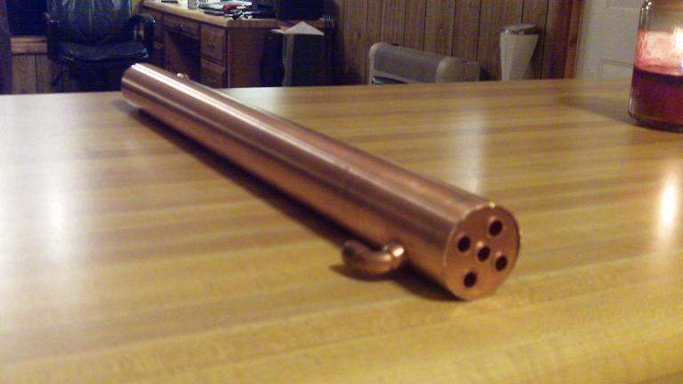

The more people tell me about hard solder the worse my chances seem to get it to work for me. The main area I am concerned about is the top of the condenser. What I am thinking now is to leave the tubes sticking above the plate about 1/8" and recess the plate into the column about the same 1/8". When I solder it, using soft solder, use alot more solder than I should need and fill alot of the 1/8" void in with solder. My thinking on this is that when I solder the elbow on top, anything that melts inside will reseal itself once it cools. Whatcha think? I might be shooting blanks here but it makes sense to me. Just trying to think my way around this problem out loud.
This is the top of the condenser where the tubes would be left 1/8" high.

jbabb wrote:The more people tell me about hard solder the worse my chances seem to get it to work for me. The main area I am concerned about is the top of the condenser. What I am thinking now is to leave the tubes sticking above the plate about 1/8" and recess the plate into the column about the same 1/8". When I solder it, using soft solder, use alot more solder than I should need and fill alot of the 1/8" void in with solder. My thinking on this is that when I solder the elbow on top, anything that melts inside will reseal itself once it cools. Whatcha think? I might be shooting blanks here but it makes sense to me. Just trying to think my way around this problem out loud.
If you get it hot enough it can work as you have it pictured with hard solder. That's the general issue. The area you are soldering needs to be glowing red. If you can get it up to temp...it will flow.
Filling the cavity with soft solder hoping it reseals is hit and miss bet. Sometimes it opens "up" holes when it cools doing it that way. Plus you have to work on it standing straight up/level. It does what you say....the solder will melt again then harden when it cools. Whether or not it reseals itself...is another issue entirely. And then...once you've soldered the fitting on it..if it develops a leak...you are in for an even tougher time to fix it. Might have to pull it all off, clean it, and start over. I had to do this 3x on mine before it finally sealed. It "looked" sealed up every time..but putting some water pressure to it...would reveal leaks. I'ts just hit and miss.
I'd give the hard solder a go if you can. It's a better solution once it's done. Some people used a 2nd torch (propane, etc) with s "rosebud" (wide heat area) nozzle...setup inside a few bricks to make a "furnace" like thing. Put the part over top of that and heat the whole area...THEN use the mapp to work one spot/area at a time. The thing you have to be careful for here is...once you've heated it that far...it's annealed/softened and will bend/distort easy. This is why..although these methods work...it's better just to have something hot enough and small enough..to work a small area and bring it up to temp.
