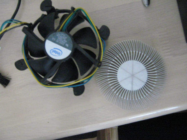

5 Seperate the fan from the element
You should now have a filty piece of cooling element in your hand :wtf: ...is that so dirty..?? YES it is.
Take i to the kitchen sink and clean it with normal dishwashing. Tip: if it is from a laptop the fan (witch you already have unmounted) is inside the element to save space.
You will probably not be able to clean inside the element with a brush. Pour some boiling water thru it to get the shit inside out.
:wtf: boiling water?? Yes, it would not damage anything as the element is made out of metal, usually cast aluminium.
Now let it dry. If you are impatient use a hairdryer to blast off the remaining water.
Now that you already have opened the cabinet, use a small brush and your vacuumcleaner to get rid of the dust in there..... carefully of course!'
6 Assemble the element with the fan
IMPORTANT!

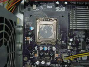

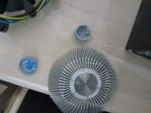

The CPU is clamped/connected to the cooling element, between the element and the surface of the CPU there is a heat conducting paste witch HAS to be there for thermal conduction! You will have to apply new paste before attaching it to the CPU core.You can get this in any electronic/hardware store, just ask for heatsink paste or thermal grease. Picture 3 shows the old pase on the CPU to be removed, picture 1 new paste to be put on the element (thin layer).
