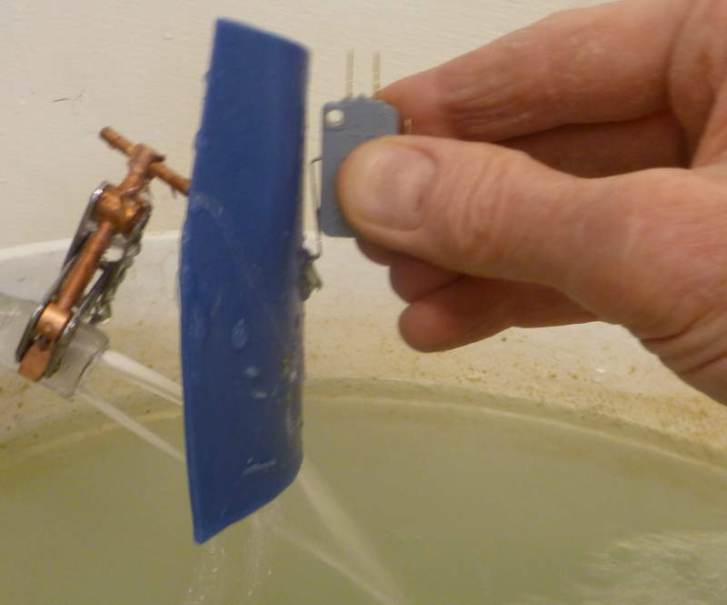

CardinalBags has turned me on to flow switches, but they are expensive. Here is an idea that I might develop into something useful.
I took an scrap of plastic and hot-glued it to a microswitch. My coolant is recirculated by a pond pump, so I put a little clamp on the tube feeding back to the reservoir to make the water come out with some velocity. With the microswitch acting as the pivot for the plastic, and holding the microswitch in the correct position, it is possible to activate it with the water flow.

Good low-tech idea. Put that right up on the nozzle and try, might give you better repeatability, long as it doesn't splash the switch.

Here is a version that protects the switch from the water. The action is very positive.
The water enters through a cutout.
Without any water, the container is positioned so that the microswitch is almost activated.
With water pushing against the other side, the microswitch is closed. M

The switch is to monitor coolant flow. The most dangerous thing about distilling is that you can get ethanol vapours in the air if your coolant stops flowing for some reason. I'm in the process of making a very safe still, and coolant flow is one of the things I want to sense.
M

I like the idea of the slowly emptying flow switch, it removes the need for pressurising the output, In the past i have made flow switches which where to sense water in a ditch. This ditch was on a model of an industrial process used for red/blue teaming in the SCADA security world. If red team penetrates the system then the plant overflows and water flows down the ditch signalling the end of the contest. I made a capacitive sensor which is similar to those touch sensors found on PCBs. This was buried under several layers of paint and other water proofing compounds but still worked very well.

Anyone using this type of circuit to shutdown their still should disconnect it from its source of power ie gas or electrical.
If you use propane or natural gas then there should be an appropirately sized solenoid that would be energized (normally closed valve held open) to allow gas flow to the burner. The flow switch would then deenergize the solenoid on loss of flow. Also loss of power, a broken wire, or a failed switch should deenergize the solenoid.
If you use electric heating elements there should be an appropirately sized contactor that would be energized (normally open contacts held closed) to allow current to the elements. The flow switch would then deenergize the contactor. Also loss of power, broken wire, or failed switch should deenergize the solenoid.

Re: Poor Man's Flow Switch
Hi RonH,
That is exactly how my system works, urr, will work. As others have pointed out, the microswitch might be a little weak to take on a contactor. The one I've used is Alco 1478670-7 which you can see here: http://www.tycoelectronics.cz/catalogue ... 309227.pdf" onclick="window.open(this.href);return false;" rel="nofollow
It is SPDT, 0.1 amp 125VAC or 0.1 amp 30VDC with an operating force of 35g and a releasing force of 6g.
A typical contactor http://relays.te.com/datasheets/Model_9 ... series.pdf" onclick="window.open(this.href);return false;" rel="nofollow would require too much inrush current to use with this switch.
However, a solid state relay would be able to work within the ratings of this switch. Or the microswitch could drive an SSR which would drive a contactor, which is what I intend to do. (A microcontroller will drive the SSR which will drive the contactor.) Do you have a particular reason for not using an SSR instead of a contactor? Personally, I feel safer with a contactor, but is there some loss of reliablity in replacing a contactor with an SSR? I see from your profile that you are an engineer.
M
M
An SSR would work. Be sure to use an appropriate diode, snubber or whatever the SSR manufacturer recommends for the power you're switching and use a heat sink of some type, maybe just a piece of sheet aluminum. It's unlikely that an SSR holding in a contactor or solenoid would fail, but keep in mind that SSRs can fail closed- best to check the operation each time before firing up the heat.
Got it. Fail closed.
It can fail closed but you DO NOT WANT AN SSR TO FAIL CLOSED IN THIS SITUATION!Maritimer wrote:Got it. Fail closed.
