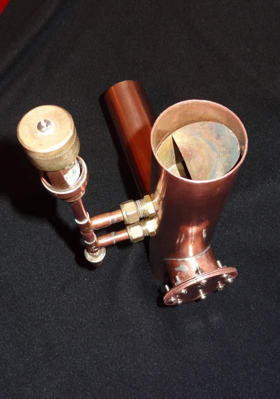

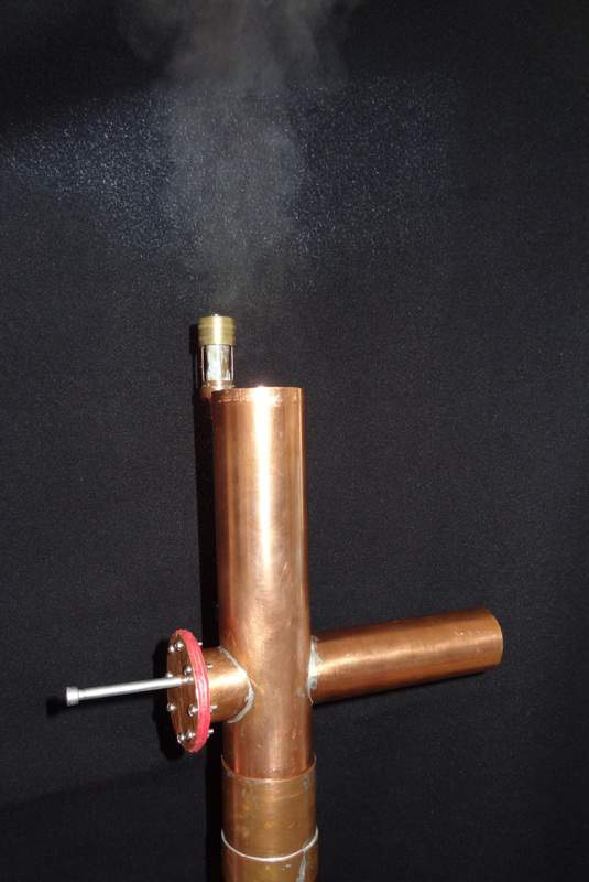

I was playing around with a proposed LM/VM head and came up with this arrangement.
The LM speaks for it’s self.
The VM is operated by sliding a tubular diverter along the (1.1/2”) horizontal take off, this has two purposes; firstly to open the path to the product condenser and secondly to restrict the flow to the reflux condenser, I think that this combination will make adjustments a lot more responsive. I have a couple of options for adjusting the position of the diverter.
Pot Still – time will tell if I am able to make a perfect seal on the path to the reflux coil or not. Does it matter if there is a slight passing of vapour? My thoughts are that it will not and will simply reach the coil, condense and end up being routed to the slant plate take off.

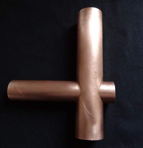

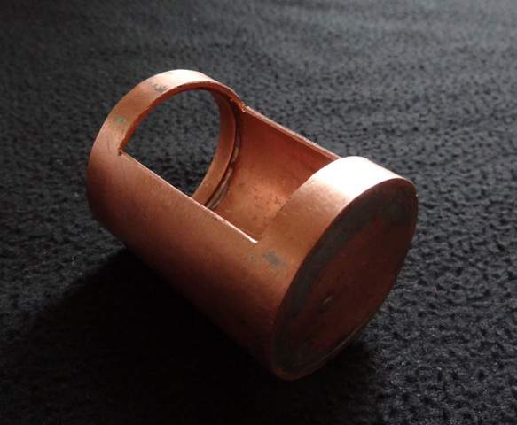

Started off by building the diverter piece
Which fits inside the 1.1/2" cross piece.
Like this
The cross piece is fitted into the 2" column
Like this

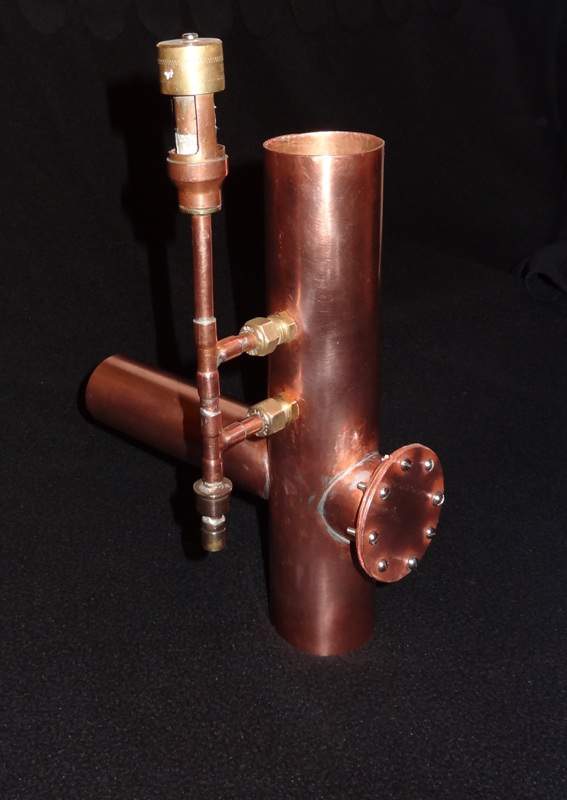

I transfered my Slant Plates and Needle Valve from my Bok.
And added the actuator arm and a stuffing gland currently silicon, but will change to PTFE prior to production runs.

Re: POT / Bok /VM Selector Valve

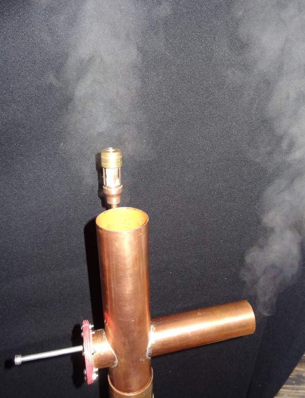

Initial tests are promising.
Push the rod in for LM / Bok take off and all the vapour is allowed to pass through to the condenser.
Pull the rod out and all the vapour is diverted to the lieberg ie Pot Still
And when the rod is half way in /out then ......VM
The VM control seems very smooth and positive, I will be adding a screw / thread type handle to get full control.
The whole lot including valves cost less than £10 I am chuffed.
Still a bit of work to do on the assembly but should be doing a production run in a couple of weeks ( Other Life Stuff)
OOPs
I seem to have posted it in the wrong place, could a kind hearted mod please move it to the column section, thanks.

That doesn't look any fun, but it does look expensive.halfbaked wrote:Would this make life easier? I like your idea. I hope you keep us informed on it. Does it keep lined up OK? I assume you have starts and stops on your pull right?
Yes, with having the cross piece continuous everything, more or less, self aligns, I do not think that the cross tee in your picture would be as forgiving.

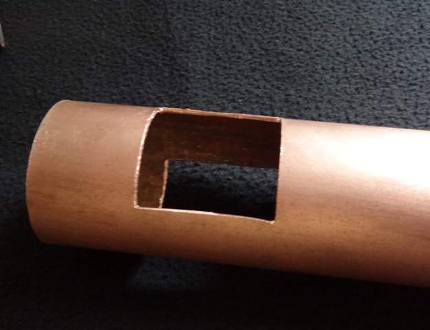

Where the 1.1/2" tube passes through the 2" tube there are "D" shaped gaps that require to be sealed.
It too k a few tries working inside the tube but got there in the end.
The push pull rod was a bit jerky and got to hot to handle.
I added a M8 screwed rod to smooth things out.
The selector can now be set very smoothly and precisly.

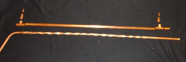

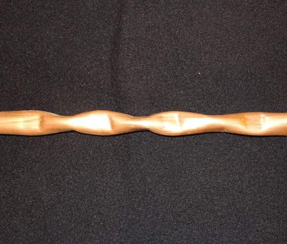

I am short of space in the shed so I am using a vertical lieberg, 22 mm over 15 mm by 1.0m long.
I have dimpled the inner core to increase turbulence in both the cooling and vapour paths.

Brian,YHB wrote:I have just realised that I never posted this I wrote it a few months ago--------------
Life just gets better, yesterday I had a run that was totally clean and completely tails free, am I happy or what?
I diluted the strips from 3 TPW’ I ended up with 22 litres of 31% in the boiler
Closed the VM take-off and let the column stabilise for an hour at 0.6 kw.
Opened the LM needle valve and took off 150ml fores at one drip a second.
Then opened the valve to 2 drips a second and took off a further 750ml as heads.
Closed the LM valve, increased the power to 0.9 kw.and let it stabilise for another 30 minutes
From switch on to this point it took 5.1/4 hours, it was boring.
Now for the good bit. I opened the VM valve to around 1 liter an hour and collected 4.95 litres at 95+%. This made it all worthwhile, the temperature never moved and I did not need to make any adjustments throughout the run. No smearing, very clean tasting. The temperature spiked at the end, the output more or less dried up without any sign of tails. All in all it is a big improvement on the Bokakob hearts extraction
I will let the angels have their pick for a couple of days, but it is so clean tasting the cuts have more or less made themselves, I will reserve judgment on the first cut from the VM but the others are all keepers.
9.1/2 hours for 17 bottles of neutral at 40%. Tired but very happy indeed.

Lester,
With my slide valve pulled out, it completely shuts off the path that allows the vapour to reach the reflux coil.
This diverts 100% of the vapour through the product condenser, once the packing gets up temperature there will be very little reflux and the still becomes a pot still.
I like it because with the LM I can compress the heads to around 10% of the total alcohol. If I have 6 litres of alcohol in the wash, I take 600ml of fore’s and head’s and dump it, if the flavour has been stripped off then it does not matterit just leaves more flavour in the still.. I then take two small cuts , maybe 50ml each and save for tasting later. Then I pull the slide valve to create a pot still and take off the hearts with all the flavour, until the tails come through.
This is very much distilling by numbers which is frowned upon by many, but when I make cuts by touch, taste, smell - I usually screw-up.
This way works for me!!
