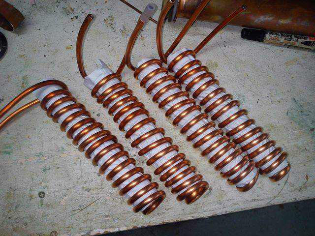

The very first coil I made (that actually worked after I scrapped a few) is still in use and is currently in a horizontal configuration inside my own column. I wound the coils independently and then joined them with small equal T's
It is not exactly pretty but it still works fine. Central feed down the centre then up both coils in parallel.
1 option for the coldfinger is to put on and end cap and then drill it. This gives you a double thickness of copper for the solder joint onto the coil. Like this one.
That is a 22 mm cold finger with 2 of 6 mm coils and it will just fit into a 54 mm shell.
If you just wish to use a single coil and coldfinger joining them is easy. Just put a female to female reducer on the end of your coldfinger. If you don't wish to bend a tight 180 degree bend the alternative is to use 90 degree street (male to female) elbows. This gives you a nice compact bend as they telescope inside each other.
You can also file down both ends of the 90 degree elbows to make the bend more compact if you wish. Off course if you fill your tube with salt then you can wind a much tighter bend than the recommended minimum bend radius. My inner coil is actually a 6 mm tube wound onto a 15 mm mandrel.
(EDIT: 15 mm DIAMETER mandrel - recommended minimum bend RADIUS is 15 mm)
Getting the salt out of such a tight coil takes time. Just connect it up to a water supply and leave it alone. EVENTUALLY the water will work its way through - might take a day.

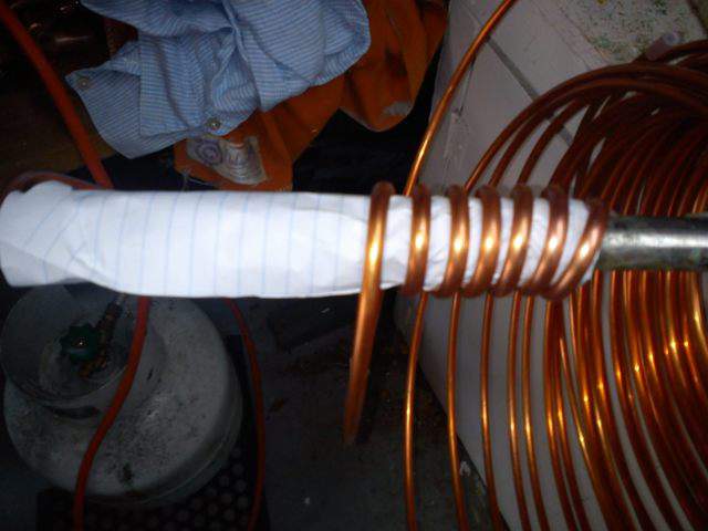

imo the join from the coil to the coldfinger is a PITA.... i hate making them
i reckon a double wound coil is so much easier to make
for 2" column i use a keg spear for the inner mandrel and 3 bits of paper for the outer mandrel

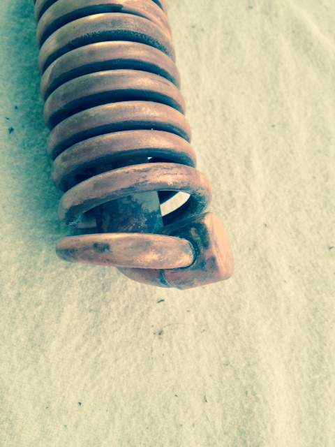

I finally built the easy coil condenser. It is 8" long and knocks down 2000 watts of ethanol vapor. Winding the 1/4" (OD) coil, filled with salt, around a 1" mandrel was very easy, due to the larger than normal mandrel diameter. The hardest part was bending the tails to align with the holes in the 2" cap. (Unfortunately, I mangled the coil windings somewhat during this alignment. :cry: ) I cut the cap to shorten it to get a better view for inserting the tails.
Easy coil condenser side view
For extra gripping power, I inserted the 1/4" (OD) tails through a 1" length of 1/4" (ID) tube. I drilled two holes in the cap, just wide enough for the 1/4" (OD) tails to slide through. The 1/4" (ID) sleeves were, therefore, wide enough to completely cover the cap holes and provide a good grip for soldering. The sleeves also provide additional mechanical strength and rigidity, since outside of the cap, the tails are subjected to stress when connecting the water hoses.
I am using a cross-flow condenser and thus left a gap in the middle of the coil for the vapor to enter into the coil. I also ran a copper wire around the 1/2" coldfinger for increased turbulence. (I don't know if this really has any effect on the condenser knock-down efficiency: It just seemed like a good idea at the time and was ... wait for it ... "easy". :o )
Detail showing winding inserted into capped street elbow
Inserting the winding into the coldfinger was also easy (some folks report this is difficult). Looking at the coil end picture, you can see that I attached a 1/2" street elbow to the end of the coldfinger. The street elbow was then capped with a 1/2" cap in which a hole was drilled into the side to accept the end of the winding. I did not have to bend the end of the winding into any fancy, and thus difficult, gyrations in order for it to easily insert into the capped street elbow. NOTE: I abandoned the connection scheme that I described in earlier posts, per YHB's advice.

I introduced the dark discoloration in the above pictures when I soaked the condenser in vinegar. Does anyone know how I can remove this discoloration? Buffing is obviously out of the question.
I suspect this discoloration is something that leaches out of the solder joints and I fear that it impaires the copper-to-vapor cooling efficiency.

Maybe try some citric acid instead of vinegar. Citric acid usually does a good job.

Having said that, the only difficulty I had when fabricating the easy coil condenser was attaching the cap. That is a topic for future … wait for it … easy exploration. :ebiggrin:
