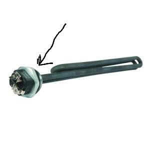

Sort of going to hijack, here, for moment. Since it is pertinent. Pertains to the area where the element "rod" mounts to the rest of the element. Mine appeared to be galvanised. Basically the threads, and the flat part that go into the keg. Is this the case? I have tried to find out, on my own, but can't find anything pertinent. Most info only covers element, itself.

From what I can see the nut looks galvanized and the threads look stainless.. Not sure though.

The part you are talking about is plated and very magnetic, so it is not SS. It appears to me, holding one right now, to be of some zinc/alloy(tin or more likely nickel) plating.The KYChemist wrote:Sort of going to hijack, here, for moment. Since it is pertinent. Pertains to the area where the element "rod" mounts to the rest of the element. Mine appeared to be galvanised. Basically the threads, and the flat part that go into the keg. Is this the case? I have tried to find out, on my own, but can't find anything pertinent. Most info only covers element, itself.
I sent an e-mail off to the manufacturer just now, asking some pertinent questions. We'll see if they bother to answer it, or not.
