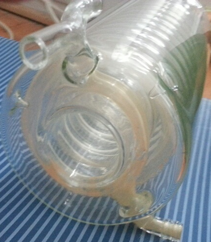

Anyone know what size of unit and type of unit this would take? Would it work with small copper pot etc. Wonder what it's worth as well. 8 inches long, 4 inch diameter. All one piece.

Probably too small for any realistic still. Worth more to a lab guy. But very cool...
Very hard to attach anything real to it.

As for your condenser I have a 3 foot glass outer shell on my shotgun condenser with four 1/2" copper tubes. The glass adds a cool factor but has some considerations that must be made. When cleaning and storing you must be very careful as it is breakable. Also getting a seal is difficult and I tried several methods, using some type of silicone will not work as the heat (expansion & contraction) will create leaks. I ended up having to use a gasket with double clamps on both ends. My gaskets work because they only come in contact with the water and not alcohol.

AND! who knows what chemicals the previous owner has been running through this condenser, how are you going to clean inside every piece to gaurantee its clean and safe?

would make a dandy product condenser for a LM rig, except for the whole glass-holding-192-proof thing.
Is it lab grade at least? borosilicate etc?

Because their internal worm coils are made of glass, which has very low thermal conductivity, especially when compared to copper, i would not consider using a lab condenser. Priced at 40 to 60 bucks on ebay, they are VERY tempting though. I WAS able to resist the temptation, however. For a comparable cost, I was able to build a much more efficient unit, using copper for the coil, and going with some recommenations from the guy at the hardware store (who asked NO "uncomfortable" questions, BTW - you gotta love a guy like that!), ended up going with PVC pipe & fittings for the outer jacket "shell". It works like a million bucks.

P.S. I am waaaaaaay too paranoid, to even consider posting a pic of it! But use your imagination - you can probably come up with something similar. The trickiest part is probably in ensuring that it is sealed leak free, at the 2 places where the copper pipe passes through the PVC cooling jacket. Of course it needs to be orented vertically, so that the product flow is all "downhill" through the coil, without being able to "puddle up" anywhere. And the cooling water feed needs to enter at the bottom, with the drain connection at the top (reverse of product flow). And use of those easily removable "push-on" connectors (I use primarily 90 degree elbow connectors) makes it all a straight up plug-n-play gig!

I am not here to stir the pot or argue with anyone. just to state the fact.Their internal worm coils are made of borosylicate, made to handle high temp gradients! not regular old glass. and obviously you have not ever experienced the hot end of your copper worm heating and softening the pvc jacket and causing a leak<only cooling water but still a bummer> nothing against your rig and I hope everything continues to work well for you. alway remember safty first.Right Lightning wrote:Because their internal worm coils are made of glass, which has very low thermal conductivity, especially when compared to copper, i would not consider using a lab condenser. Priced at 40 to 60 bucks on ebay, they are VERY tempting though. I WAS able to resist the temptation, however. For a comparable cost, I was able to build a much more efficient unit, using copper for the coil, and going with some recommenations from the guy at the hardware store (who asked NO "uncomfortable" questions, BTW - you gotta love a guy like that!), ended up going with PVC pipe & fittings for the outer jacket "shell". It works like a million bucks.
