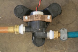

This is the one I use. Gives me about 2.5 gpm at 8' head. 12 volt run through a led light transformer.
I have one for each still. Mounted on planter dollies and 30 feet of cord so I can move them around the distillery easily in case I need one as a backup somewhere else.
