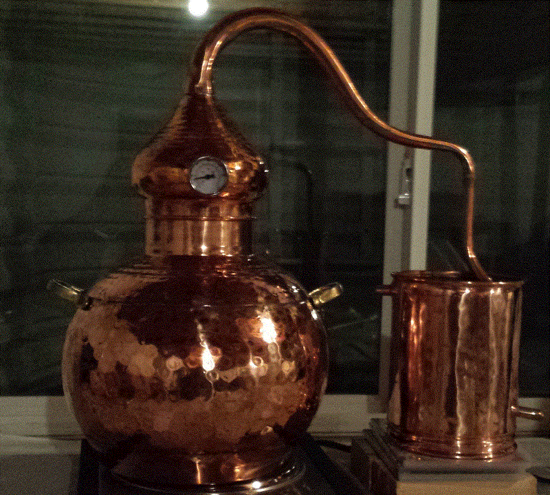

Picture of my still
Picture of my still

Beautiful still you have. While on the small side, you can still make some good liquor. A few guys here have smaller stills like yours. If you look around you can get an idea of what volumes to collect in. Get yourself some smaller mason jars (the 250 ml ones) and collect half full til you get a better hand at making cuts. Thanks for the pic (aka copper porn).
