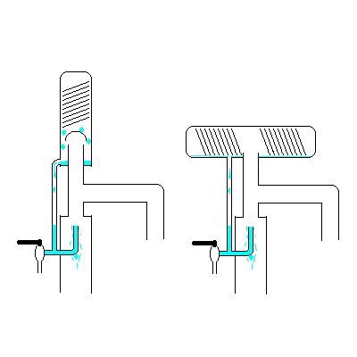

HookLine wrote:Hey, one of my crazy ideas finally gets put to the real world test. As all ideas should be. Thank you, casper. :clap:
The basic point of this design idea was to see if it would help lower the minimum reflux ratio (for a given column : takeoff port
4. keep the horizontal section as short as practically possible (without being obsessive about it), and keep the reflux port nearer the output end (i.e. after the vapour has finished the 90º turn to horizontal),
Keeping both ports tighter together, do I still want them close to the bend. Is that to get vapors into the RC quicker. Just asking since seeing those pics of horizontal RCs makes me wonder bout what my wee length of 2" is actually doing. Seems needed by the splitter tee design but happy to remove
5. easy enough to add LM, either by inserting a small dam near the column end of the horizontal section, or setting up the reflux condenser shell as a liquid trap, like some of Bokakob's designs (and I have done a drawing or two showing how to do that with this design idea)
I will insert a bypass; I did do the boka option on the RC shell as you drew so all condensate should now return direct below the ell.
6. make sure the reflux is returned to near the centre of the packing (at the top).
I have an upturned 10mm pipe in there. It reaches a few inches up into the bend
Looking forward to hearing how it all works.
Cheers 8)

Amended as recommended.
Return condensate to column
Needle valve
Needle valve
This neat wee needle valve costs less than 10 dollars and accepted push fit copper or nylon. And releases it.
With separation of condensate as devised by Harry.
Harry's bypass
Harry's bypass
RC
Shorter lyne arm↗️
Closer and horizontal valve, optional fit
Full Condenser return to top of packing
Turbulation on top of packing
Dry (cleaner?) outflow
Sharper Heads extraction
Last edited by casper the Irish on Thu Feb 12, 2015 1:05 pm, edited 1 time in total.

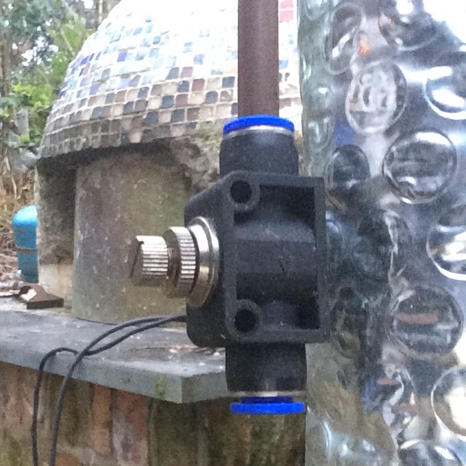

Thanks Skow
Wires were in the background, lighting for the woodfired oven. The loose cap is for the stripping runs I now can do with valve removed
I did change that tee to lower the valve just so I could reach it better. It's a 1/4" (8mm) branch on 3/8?(10mm) so figured a few teaspoons pooling won't matter. When opened won't there be a siphon draw to the spout no matter where the valve is? Needs care not to suck vapor when discarding those teaspoons.
. But I will put it back where it should be. A cool loop like yours or s-trap after the tee could do it, but I also want to keep it tidy looking and handling since it comes apart for safe keeping.
And thanks for reminding me about cleaning run, I'm so mucky thinking lead free don't need to bother, forgot the flux
LM reflux tee
LM reflux tee
Last edited by casper the Irish on Thu Feb 12, 2015 9:47 am, edited 1 time in total.

Looking good, casper, apart from shifting the LM valve closer to the tee (but still slightly below it).
Then run her up and see how it goes.

myles wrote:The minimum reflux ratio you can achieve on a VM is determined by the cross sectional areas of the two vapour paths when the VM valve is wide open.
skow69 covered it. But my 2c worth...
You are right, given the vapour pressure at both ports is equal. But that doesn't apply so neatly when the vapour has momentum in favour of one of the ports – i.e straight at one of them, and going past the other like a venturi effect. How much difference it makes in this situation I don't know, but that is what experiment is for.
Of course, just using a bigger VM take-off port and valve would definitely reduce minimum reflux ratio. 8)

A daftie question. Not sure I understand the double negative " reducing minimum ...ratio" . Do I want less reflux?
HookLine
Posts: 5628
Location: OzLand
Re: VM spirit run, neutral
Post by HookLine »
Possibly.
Limitation of standard VM design is it has a fixed minimum reflux ratio with the take-off valve wide open, determined by the port ratios, but rarely below 1:1, so not so good for pot stilling.
But if you can lower that minimum ratio substantially below 1:1, so there is much more vapour going down the take-off path than to the reflux condenser, you can get into pot stilling territory, for a spirit run not stripping runs. (Pot stills often have a bit of passive reflux going on in risers and lyne arms.)
Another trick is to restrict the vapour path above the take-off port into the reflux condenser section, so it is smaller than the take-off port or valve, which gets you below 1:1.
But make sure it doesn't choke. If the reflux is being dropped straight back down the column then the restriction can't be smaller than half the column diameter. If the reflux is being returned via a different pathway, like in yours, then can get away with a third of column diameter.

Your design asks for unequal ports, RC 1" outtake 3/4" (on 2" column). I could put a restrictor inside the RC shell where as you suggested I have a boka trap with loose fitting tee (1" equal). I could fit a 1/2" tee instead which I reckon equates to slightly less than 3/4" -just under your limits of 1/3 column dia. With the Venturi it will make an interesting variable to test. Thanks again, setting me free to explore
HookLine
Posts: 5628
Location: OzLand
Post by HookLine »
casper the Irish wrote:You have turned the lights on for me, thanks Hookline so much.
Valve snug as recommended, how "slightly lower"?. 10mm pipe turns upward inside. Valve 8mm, hope its enough.
Angle the tee slightly downwards, with the valve slightly below the tee so the liquid goes to the valve first, not down the reflux return line into the column. Guarantees full control of the liquid flow. Something like this:
