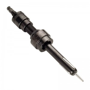

here is the tool we use for replacing tubes in large chillers.
http://www.elliott-tool.com/mechanical-joining-tools
Works well for expanding a copper tube into a hole in the tube sheet.

Do you bead as well?
Would you recommend this for a shotgun condenser?

The plate that holds the condensing tubes would not hold up to the force used in expanding the tubes if the plate is made of copper. Perhaps if the plate was made from stainless it might work. Why not just solder the connection. Looks like a lot of trial and error to me.
