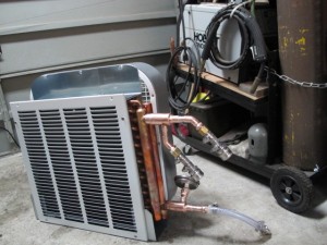

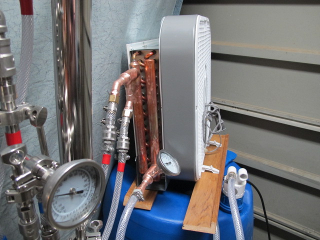

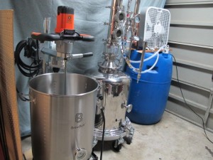

I'm sure there are several good fan/radiator cooling set-ups out there, but this is the one I just recently built. The radiator is 16" X 16", mounted to a 20" box fan. I run a 50 gallon plastic tank reservoir to cool my 4 plate 4" still with a 25 gallon boiler. Having it to do over again, I probably would opt for the 20" X 20" radiator, simply because it would be less work to mount it to the standard 20" box fan. Other than that, this is how I roll. YMMV
