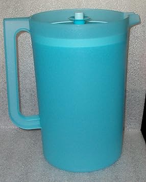

I use a diping scoope. mine is tupperware and has a handle holds about 2-3l per scoop.
Something like
