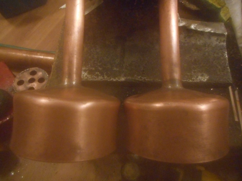

came across some 3'' K copper.

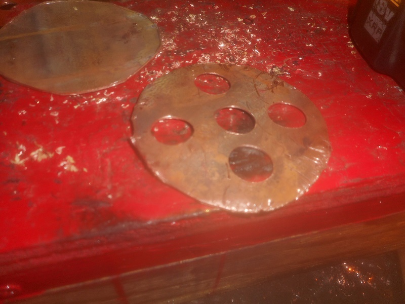

so i made a 12'' shotgun condensor
flattened out a pc. of 3'' copper, cut it with snips to the size of the pipe. drilled 5/8'' in a pattern
making 2 shotguns, so i drilled out 4 3'' couplings, 2, with 7/8 holes and 2 with 5/8 holes
then sil flossed pup peices of pipe into the caps, while the caps were hot, I swedged the bottom of the cap , so that the likker will drain,

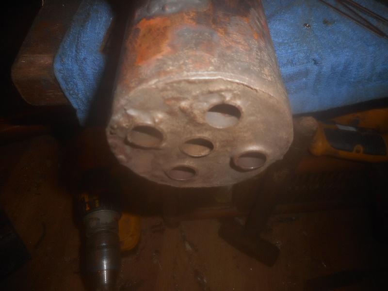

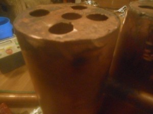

after the caps were done, I drilled the pipe and sil flossed 2 nipples aech
then i sil flossed the dividers,,then using a grinder..cut away any excess
added the tubes
hooked it up to water, tested it. no leaks !!!!!!!!!!!!
soldered the caps on.

Bang up job there. Should treat you good.

finished it last night.

What's it gonna go on? Them 3" caps must have cost a small fortune.

Nice job Frodo
