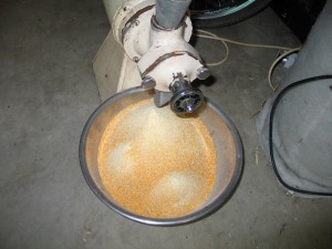

I use a small hammermill. It grinds whole corn at a rate of about 300# an hour, malts much faster. That is grinding to a course flour/fine meal. They are out there for sale but the cheapest I found was 250$ which no motor. Ready to run I've seen them for 400$.

If you look in the link affixed posted there is a pic of it towards the end.
