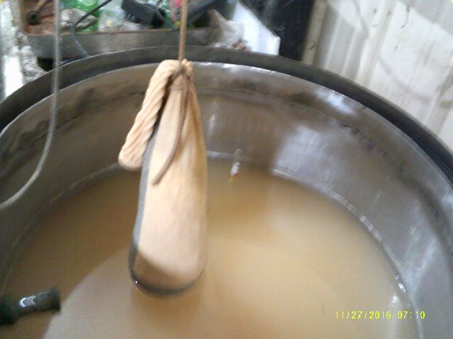

A tip picked up here is to put a small fist of oyster shells in a brew sock (for easy retrieval) and toss in the sugar wash.
Oyster shells are common for poultry feed supplement and I get mine from Amazon.
They can help buffer a low pH by dissolving, and they're self-regulating --no measuring.
Sugars can be notorious for pH crashes, but I've never had a single issue since using oyster shells.
Also, your yeast pitch quantity becomes a non-issue.

+1 on oyster shells although now instead I add 1/4 cup of shell grit per 5 gallon wash

Cheers guy's thanks for the advice I'll try the brew sock and next time at the pet store I'll try some of the grit I've seen it but didn't think it would do.
But is it the initial reproduction that causes the pH crash as when I've corrected it after 12/24 hours it seems to stay at that level, And if the yeast is pitched at correct level there is no need for additional controls

Re: Ph crashes in sugar washes
Here's my trick for preventing sugar wash pH crash
At the very beginning, put in a sock full of crushed oyster shells
